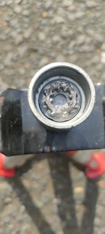

Is it the bolt (in the wheel) or the locking key (pictured) you are after?
Did you get the wheel bolt out or is that damaged too?
As @Warrior193 states the key code is usually embossed on the other side.
Example
Might be this
Thanks xman for specifying  the names. My locking key is damaged. it worked for the front two to unscrew them but rear right was very tight. I damaged it there. So, I was just wondering probably I'll get another full set with Locking key if they are not too expensive.
I already sent the query to ebay seller..they replied saying that they are double checking and will confirm me.
N.B: Does anyone know the actual measurement of the bolt and locking keys?

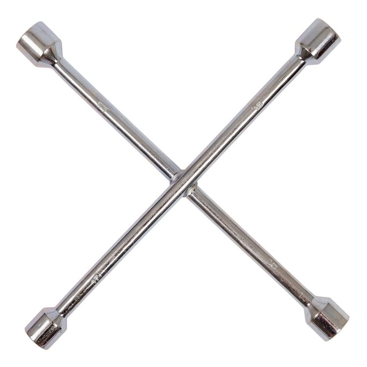

Damage occurs when you're not square on when undoing the bolt. Hold the key fully home and square with one hand when applying force on the wrench. Angled wrenches should be avoided including the pathetic wrench supplied on the Skoda wheel toolkit.
4 way cross wrenches are the safest.

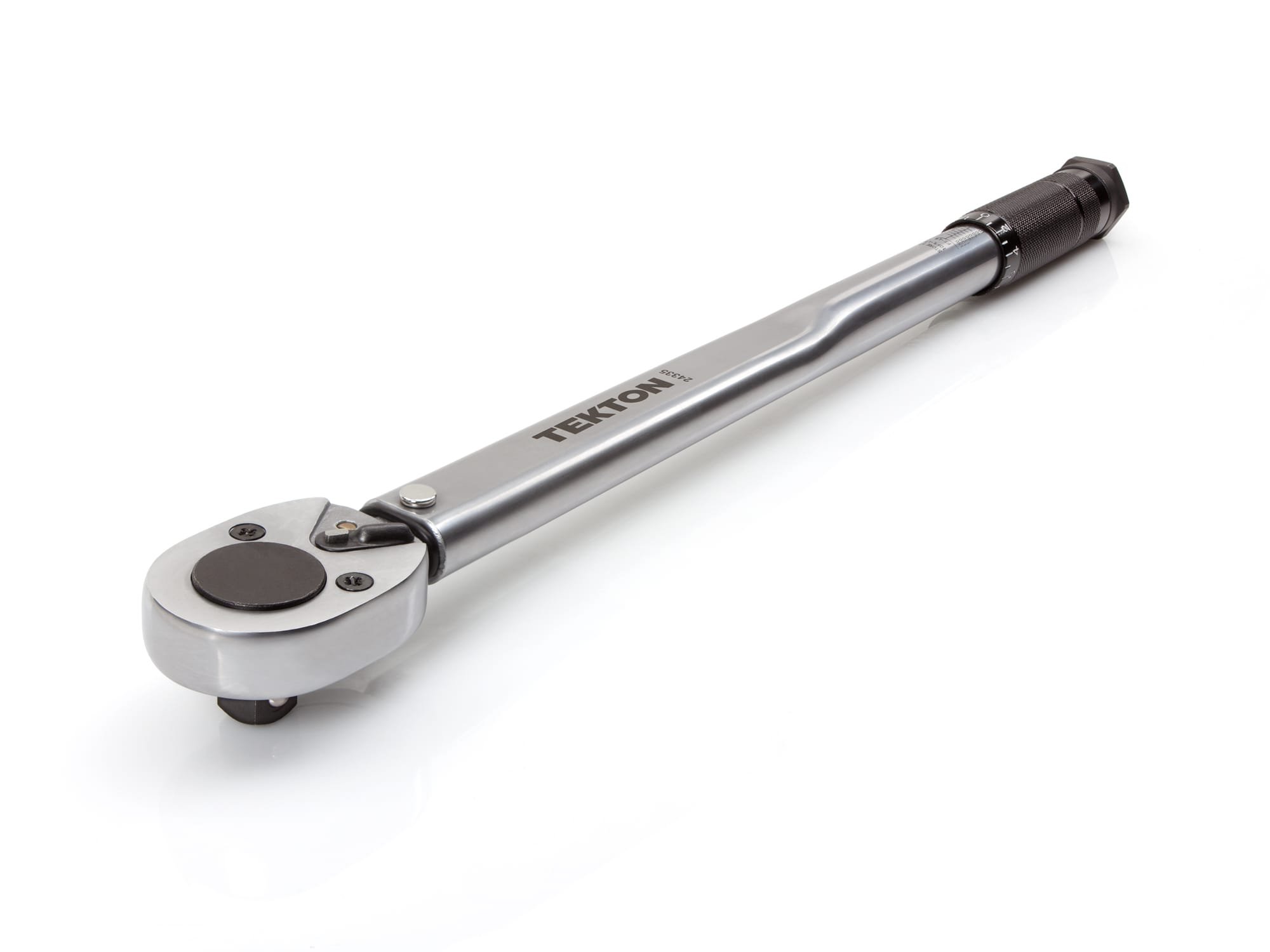

Torque wrenches with short extensions are reasonably safe
Avoid these angled wrenches, they do not apply force in the correct plane and carry a high risk of key damage

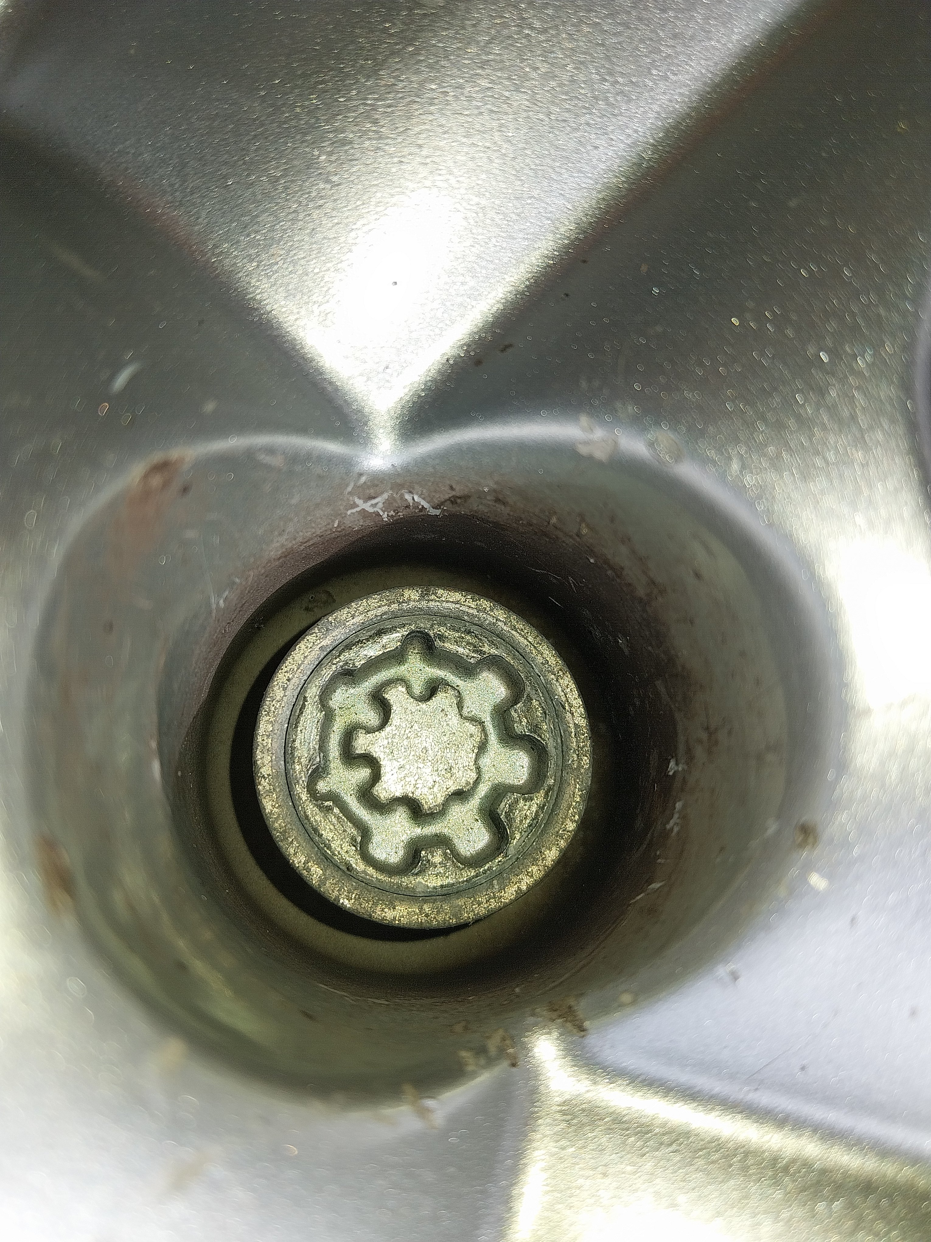

Still have my series 1 Skoda Yeti with over 290,000Kms on the clock and just discovered the security anti-theft socket is missing.
Now in France, the local Skoda dealer doesn't have any positive suggestions but to try to saw them off for about 600€.
Anyone have any experience, suggestions to get a replacement? The ebay suggestion above doesn't seem that reliable.
As far as I'm aware, many main Stealers hold a full set of the wheel bolt security keys, a visit to ascertain the correct key, then buy one over the parts counter.
No help when the key is missing - but there is a ID letter code stamped into top of VAG security keys.
The Ebay option is probably your best (and cheapest) option, suppliers I've seen supply the correct key identified by you sending a clear image of your security wheel bolt face.
