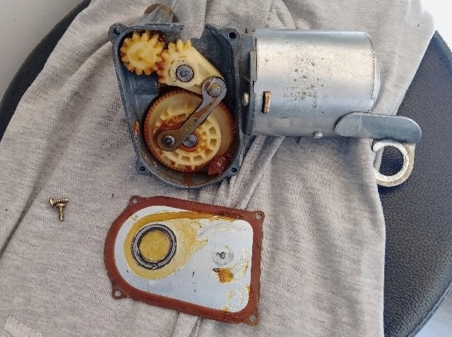

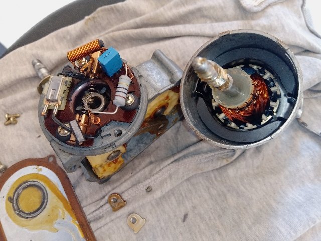

I found the pictures from the old factory motor,
the next (VIKA) was different in many things.
Obviously it's only images on a screen and the factory motor is 25 years old and some use but that looks like it might be able to be repaired  and cleaned and lubricate for more life, as you have found before cleaning and fresh new lubrication can help even working parts (it's why you change you engine oil and filter every year at least).
Would have been interesting to compare the internals of that modern crap one.
The thread is almost completely damaged.
I forgot that, but we went through some fixes for that, pity you couldn't use some (or all) of the internals from the old in the crap new one but I suppose there are too many minor differences, I expect you were looking to see if the burnt out bits could be swapped.

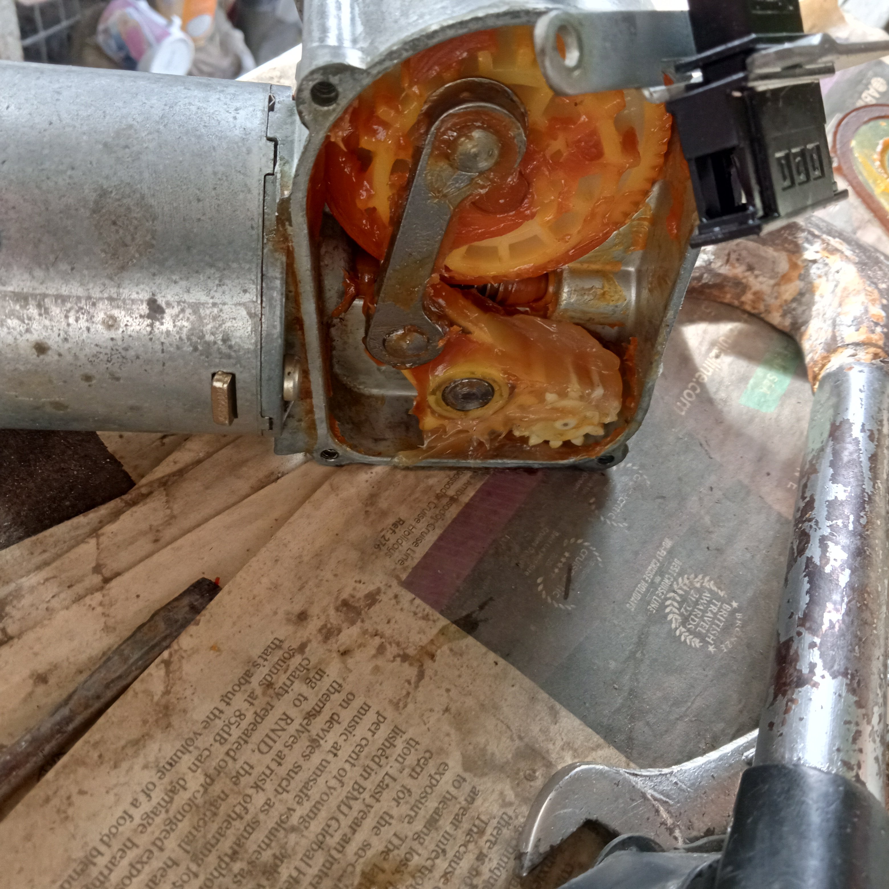

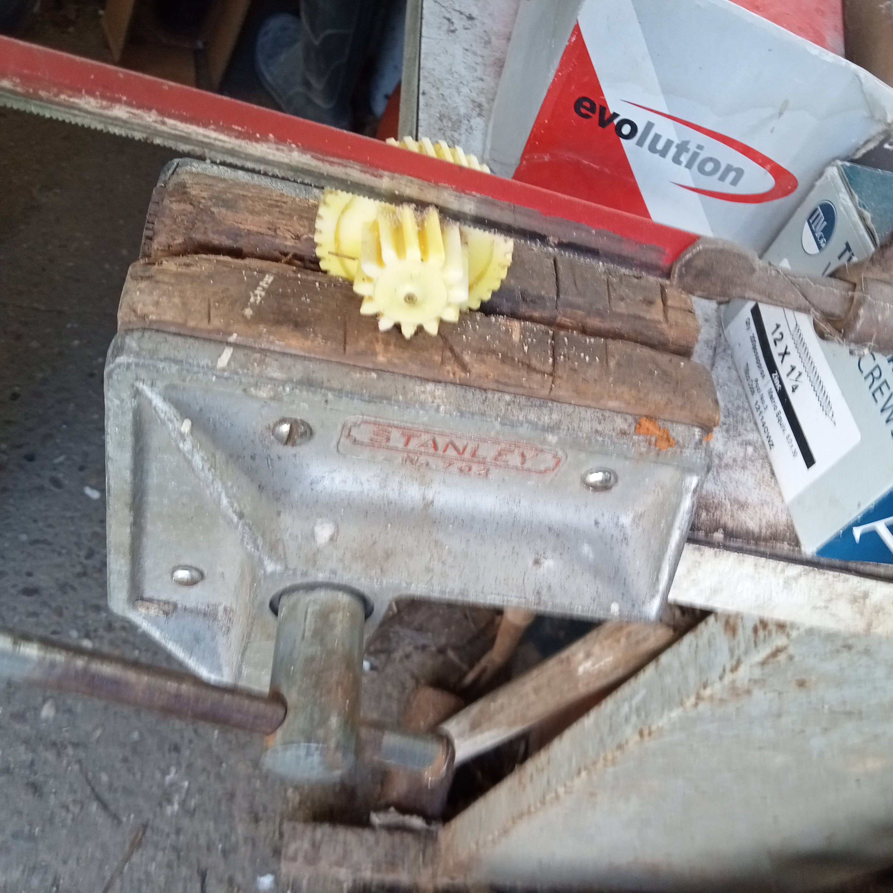

I've ended up butchering a front motor for its gear, because all the used rear motors online already have broken gears.
It required some cutting of the gears, but once cut down I threadlocked it onto the rear motor's wiper spindle.
Well done, the grease isn't too much?
