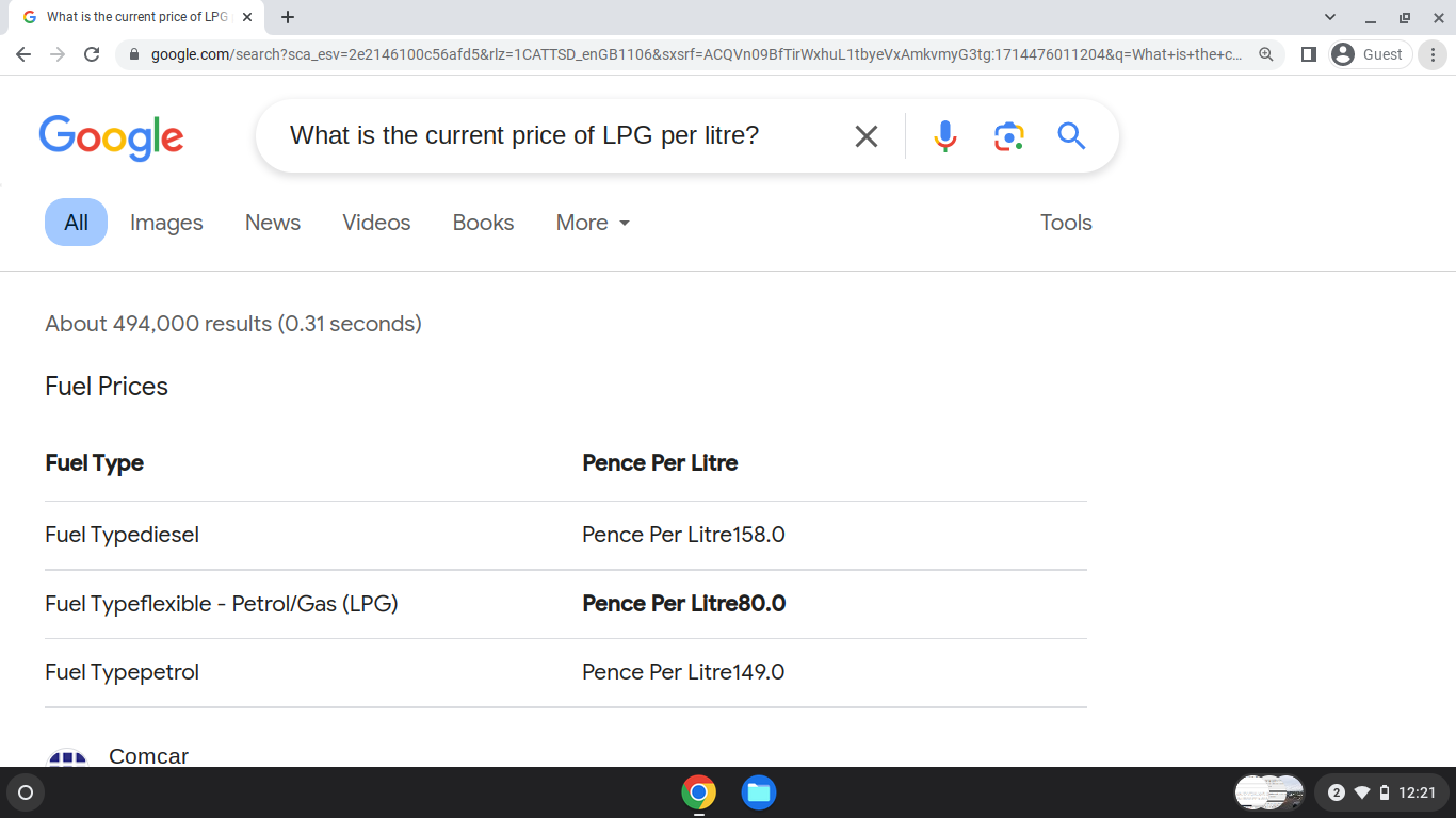

How much a litre is the LPG compared to 95 ron unleaded or 97 / 99 ron min super unleaded?

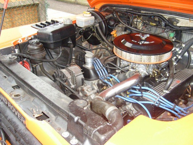

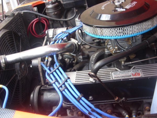

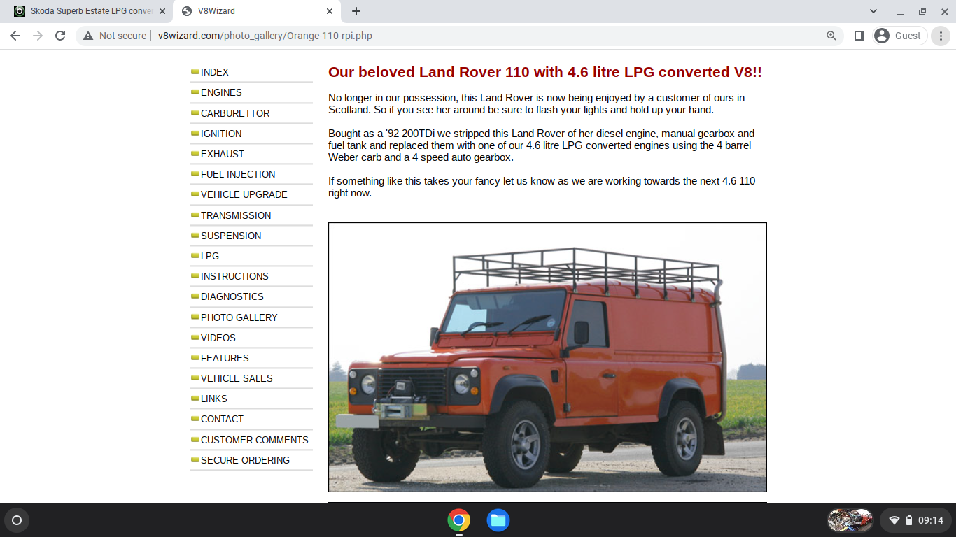

I used to run V8,s on LPG.    LPG only no petrol starting and no petrol carried.
*Engines built by RPI Engineering to run on LPG though. Used in Land Rovers, Morgans and even Ultima race cars. *

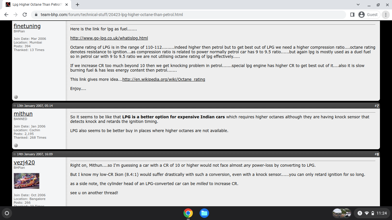

LPG is not less powerful,  it is 110 octane.
 But you might well need double the amount of litres compared to petrol.
**When i ran LPG it was less than 1/2 the price per litre than petrol and for 9 litres of LPG i got more MPG than 4.5 litres of petrol would have taken a v8. **
(@ ASDA not only was petrol £1 a litre and LPG 50 pence, paid with an ASDA credit card you got 2 pence a litre off.)
Then LPG has no Markers like Red Diesel had. Which is maybe why some run it, like to Military Shows etc where they might not fill the tank at a filling station.

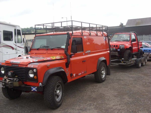

I got about 3 miles a litre from the LPG, even towing a Car Transporter and car.
9 litres x 3 = 27 mile.  a Gallon of petrol would not have taken me 27 miles.

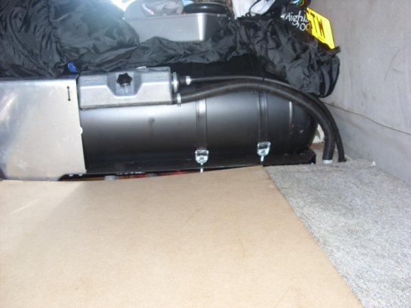

As to the Tank.
You fill to 80% because that is what tanks fill to for expansion.
The Ferry from Scotland to Northern Ireland was an issue.  I never got on. They looked at the Diesel Land Rover, they wanted to dip or open the tanks.
I told them look at the engine it is a petrol running on LPG.
 I did not use the 'Bomb' word luckily.
120 litre and a 90 litre LPG tank.  I missed one ferry then they started guff about the car on the trailer, running on petrol, no Tachograph if i was Towing for Gain or Reward and sh!te.
I told them to spin on it.
http://v8engines.com
904934296_lrenginemaymot09003.JPG.03553e54e5e443c22b73814f35fd15f3.jpeg.e5c4fbd7ec773fdf86a2f815bae1c09d.jpeg
Edited by Ootohere
That is an oxymoron!

It is a higher octane and you can get more power from an engine built to run on LPG.
As the quantity, weight etc. between Petrol 95 or 99 ron & LPG it is what it is.
   All i know is that in Countries where you can not increase the engine Capacity you can stick with say the Original 3.5 V8 Classic Range rover and get much more power running on LPG.
That is the customers RPI build engines for in lots of cases.
I bought 2 demonstrators from them.

working on the presumption that LPG mpg is 20% lower than petrol then based on 34 mpg(petrol)  then that would be 27.2 mpg (LPG)
So thats 551 gallons / 2503 litres of LPG to do the same 15000 miles which at £0.80 per litre is £2003
Which is approx £317 less per year than the diesel so about 6.9 years to pay for the LPG conversion
