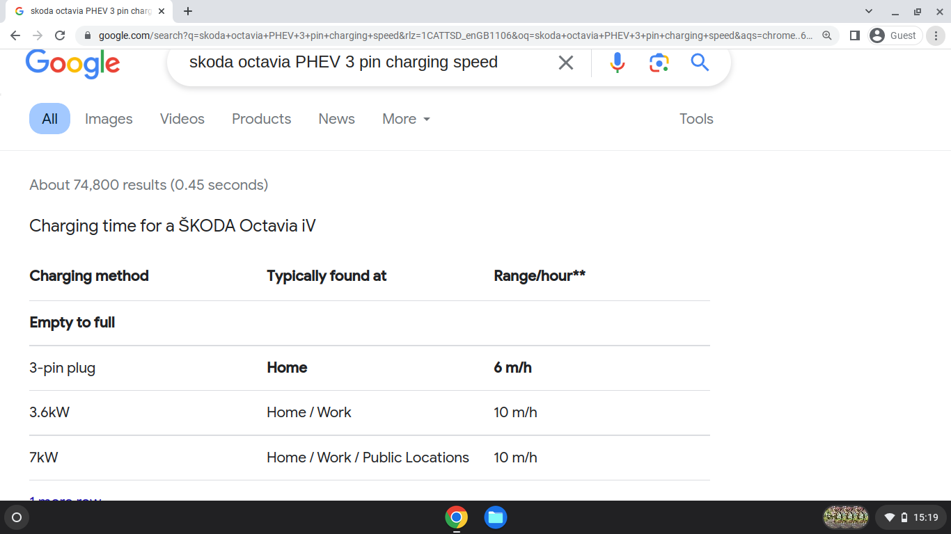

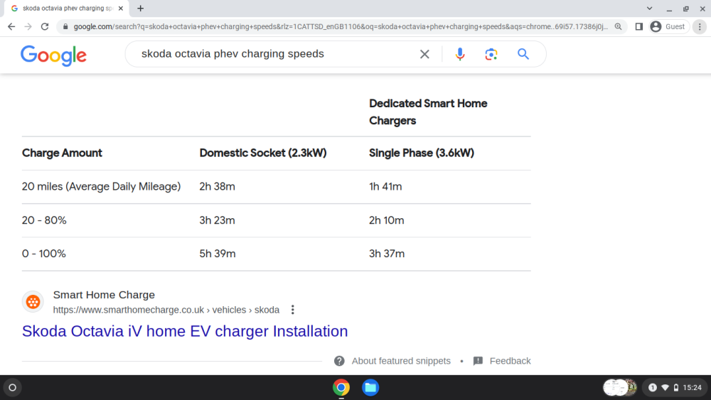

6 minutes ago, Ootohere said:
 @TheWanderer are you talking about charging the 12v battery that too many have issues with going flat.
As to the cable from a 3 pin plug charging the 13 kWh battery, 11 kWh usable, is it charging at much more the 2 kWh (10 amps max set) so about 10 hours empty to full.

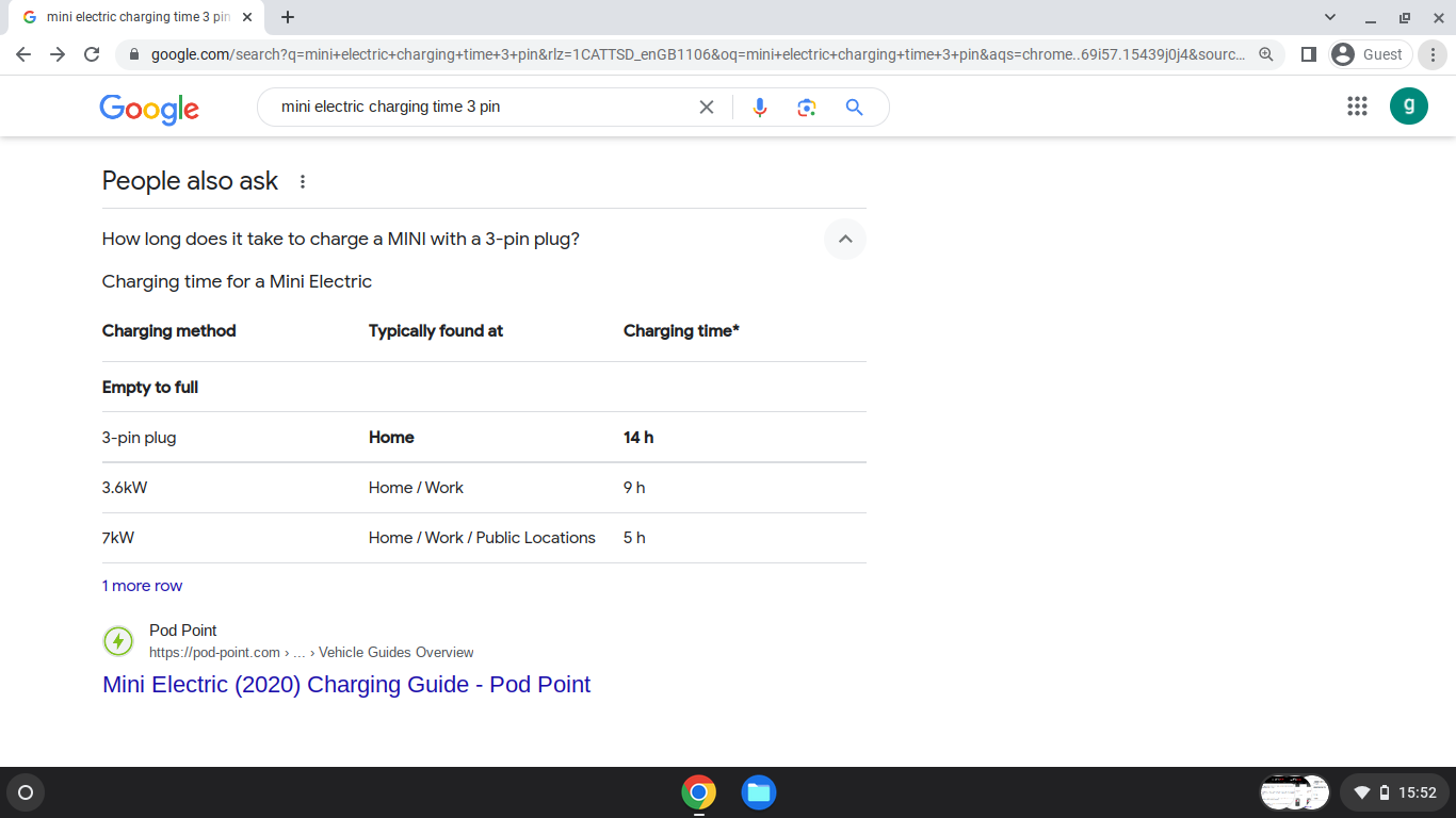

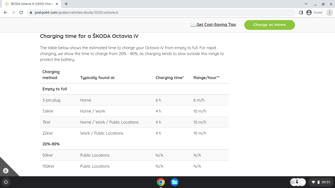

As PodPoint says '6 hours'  & 6 miles an hour.  But 6x6 is 34 miles which will be lovely.
If you get 2.3 kW from the plug then good.  You pay for more kWh than the battery size.
My 32.6 kWh battery, 29.2 usable can with 10% battery left take over 31 kWh or more to charge.
15 hours with the 3 pin cable.
As to the cable from a 3 pin plug charging the 13 kWh battery, 11.7 kWh usable, is it charging at much more the 2.3 kWh max (10 amps max set) so about 7 hours empty to full.
6 miles in an hour charging.
7 x 6 is 31 miles.
