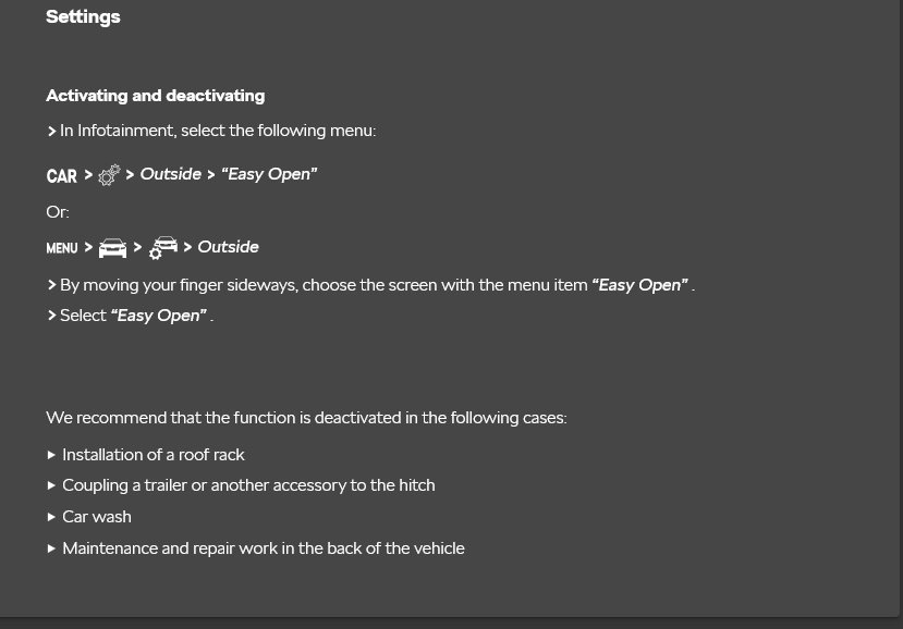

You have to turn the "Virtual Pedal" (as it's officially called) on via the headunit otherwise you can kick your foot under the rear bumper as much as you like without the boot opening. ;)
When i got my (new to me) vRS last month it didn't work so figured mine hadn't got it for some reason or it was faulty then realised it was turned off in the vehicle settings on the HU. Once i turned it on it worked fine.

Can you give me a link to the settings as I have not found any thing that gives the option to switch on ?
https://www.youtube.com/watch?v=ZniKlQpiKDk
Edited by Stonekeeper
4 minutes ago, RADIOTWO said:
The problem is it does not show like that on the Mk4
1 hour ago, Stonekeeper said:
Precisely, thats not what it shows, it shows a picture of a car and inner and outer setting but nothing like the activating and deactivating you show above
I do not have 'Easy Open' and that option is missing on my screen.  I presume that it is only displayed if the car has the functionality and the OP does not have Easy Boot opening..
(Similarly other options that I do not have are not displayed on my screen).

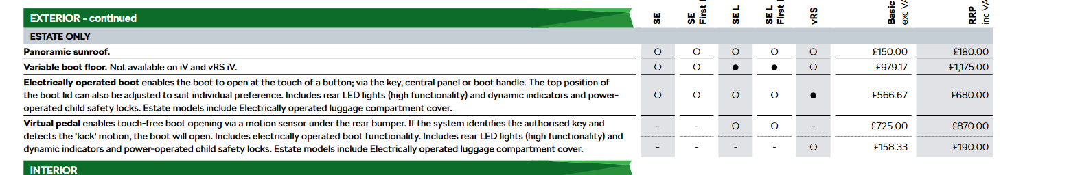

The press pack from Jan 21 says £158.33
Opening  with the fob is standard
The previous owner must have left it off the order, although I have the wires in the boot

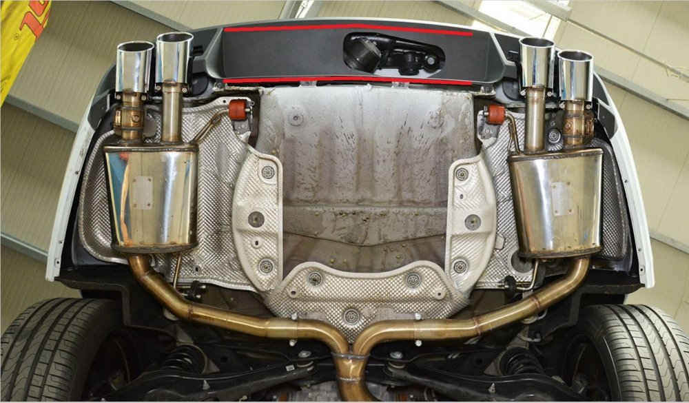

It's not the virtual pedal.
The virtual pedal has two sensor cables mounted parallel on the inside of the bumper cover. This photo is of a Superb but it is installed identically on the Octavia:
5b1b9addba3dc_tailgatetigger.thumb.JPG.f6e02f259bd4f96047d6f399954489aa.JPG.4fc32bead9fb9b828209ce7dce5e2636.JPG
