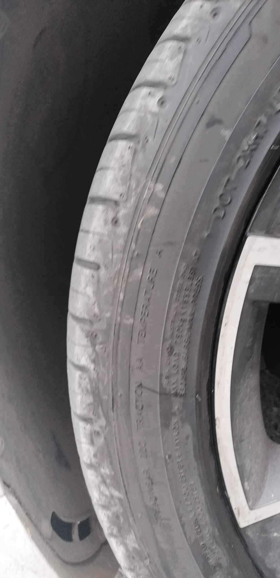

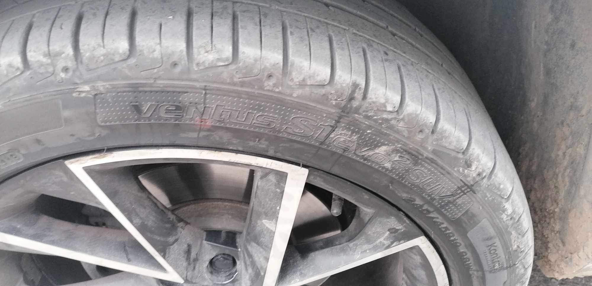

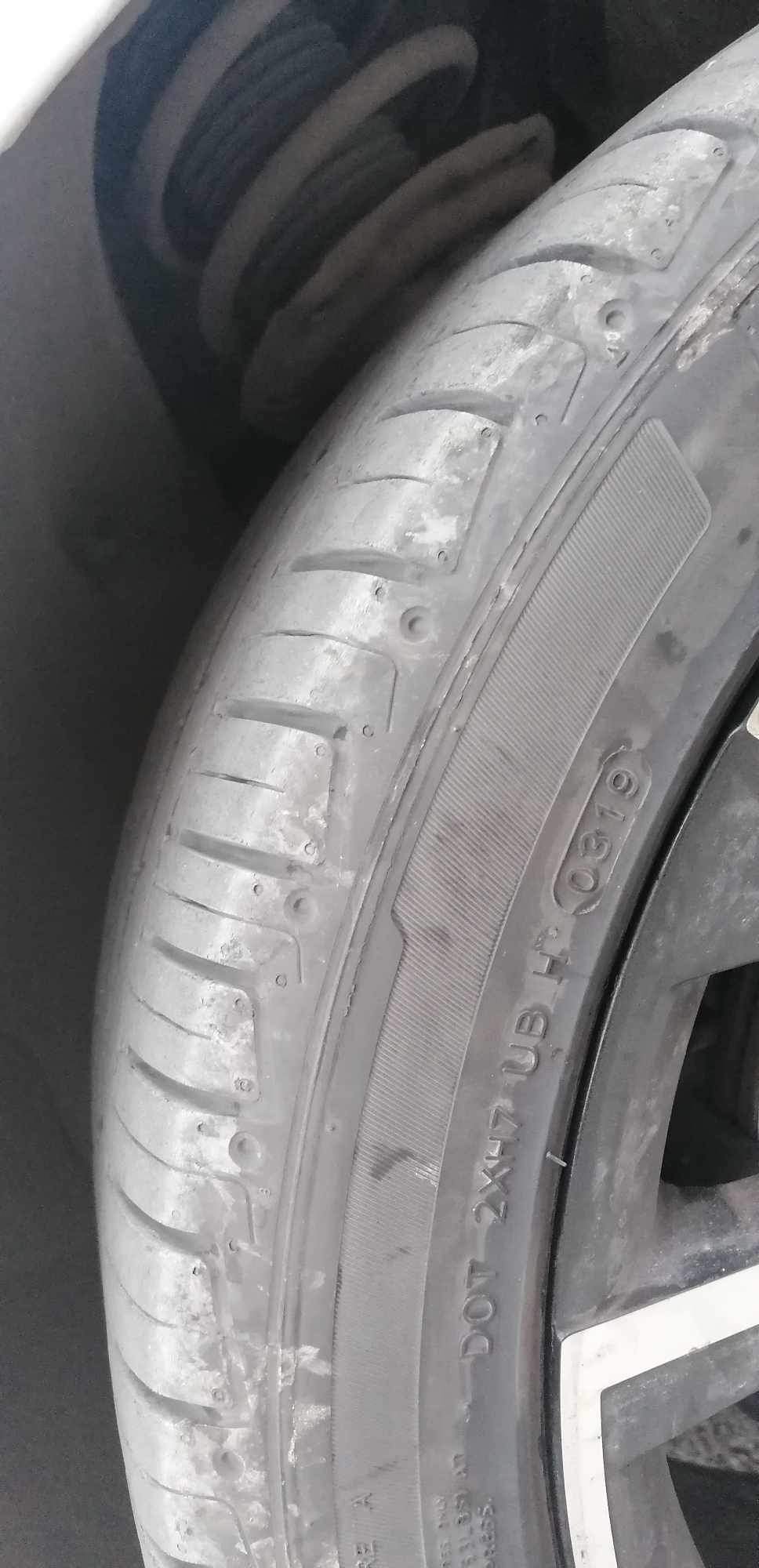

hello everyone. I have a 2023 model 1.5 tsi karoq sportline car. original vega 225 40 19. My friend bought an audi a6 and removed the 245 45 19 tires with 0 km. I have a complaint about my 40 cheeks. Is it compatible with 245 45 19 Vega rims? Will it rub? Has anyone tried it?

What I'm wondering is, will there be friction?

My 245/40 19s have clearance to spare, but my guess is that 245/45s could be close to, or over, the limit at the inner edge of the rear tyres unless you want to start butchering the wheel arch liners. But this is merely a guess.

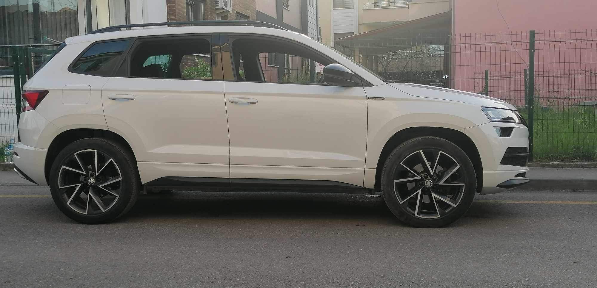

Can you give me tire sidewall height values for 225 40 19, 235 45 R19 and 245 40 19?
My main goal is to raise the sidewall and wheels a little and widen them a little. because the car looks a little skinny from the back
89 mm, 107 mm, and 99 mm.
To work out the sidewall height of a tyre, multiply the nominal tyre width by the aspect ratio.
For example, 225x0.40=90, 225x0.45=101.25, 245x0.4=98.
Sidewall height of tyre
225/40 90mm
225/45 101.25mm
245/40 98mm
To work out the outside diameter of a tyre, first convert the diameter of the rim into millimetres and then add twice the sidewall height.
For example, 19x25.4+2x225x0.4=662.6, 19x25.4+2x225x0.45=685.1, 19x25.4+2x245x0.4.
