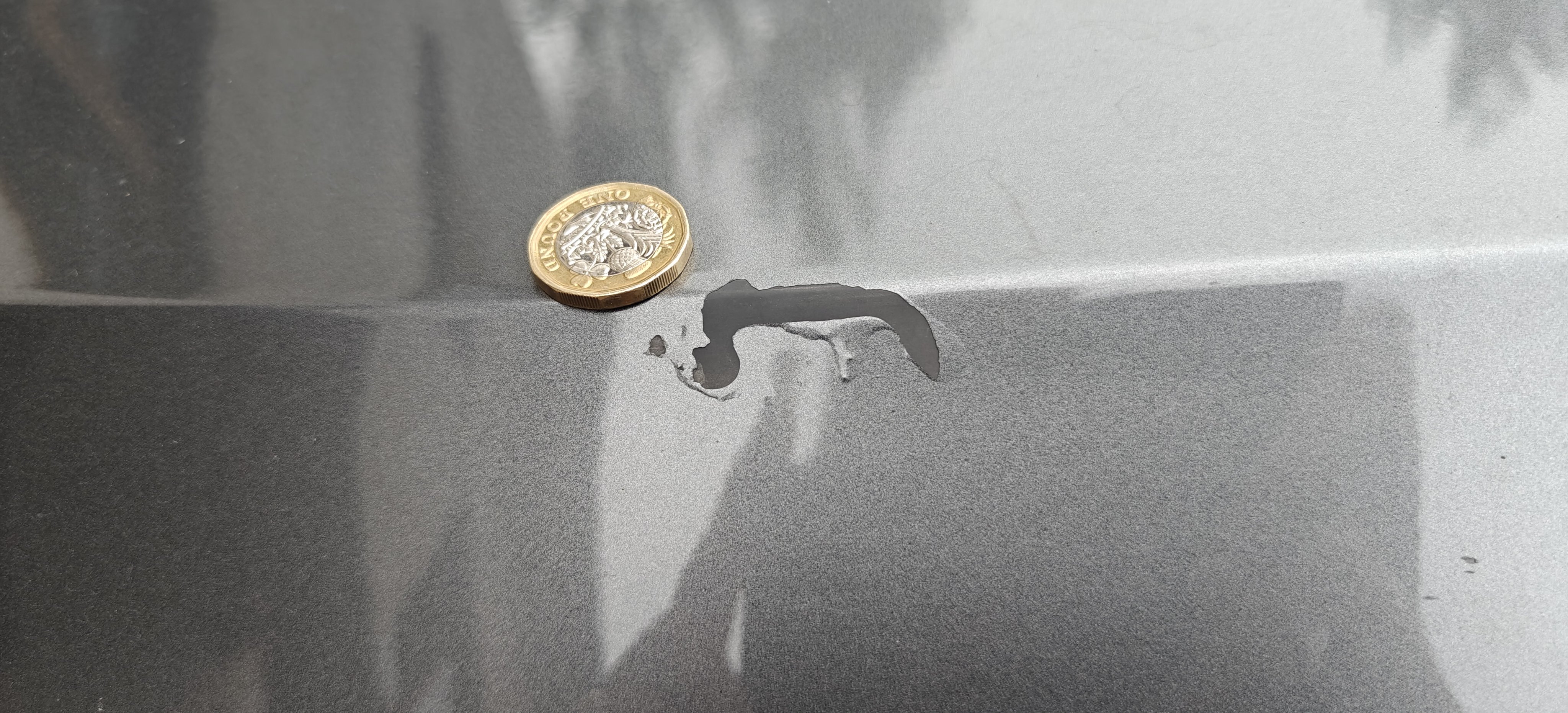

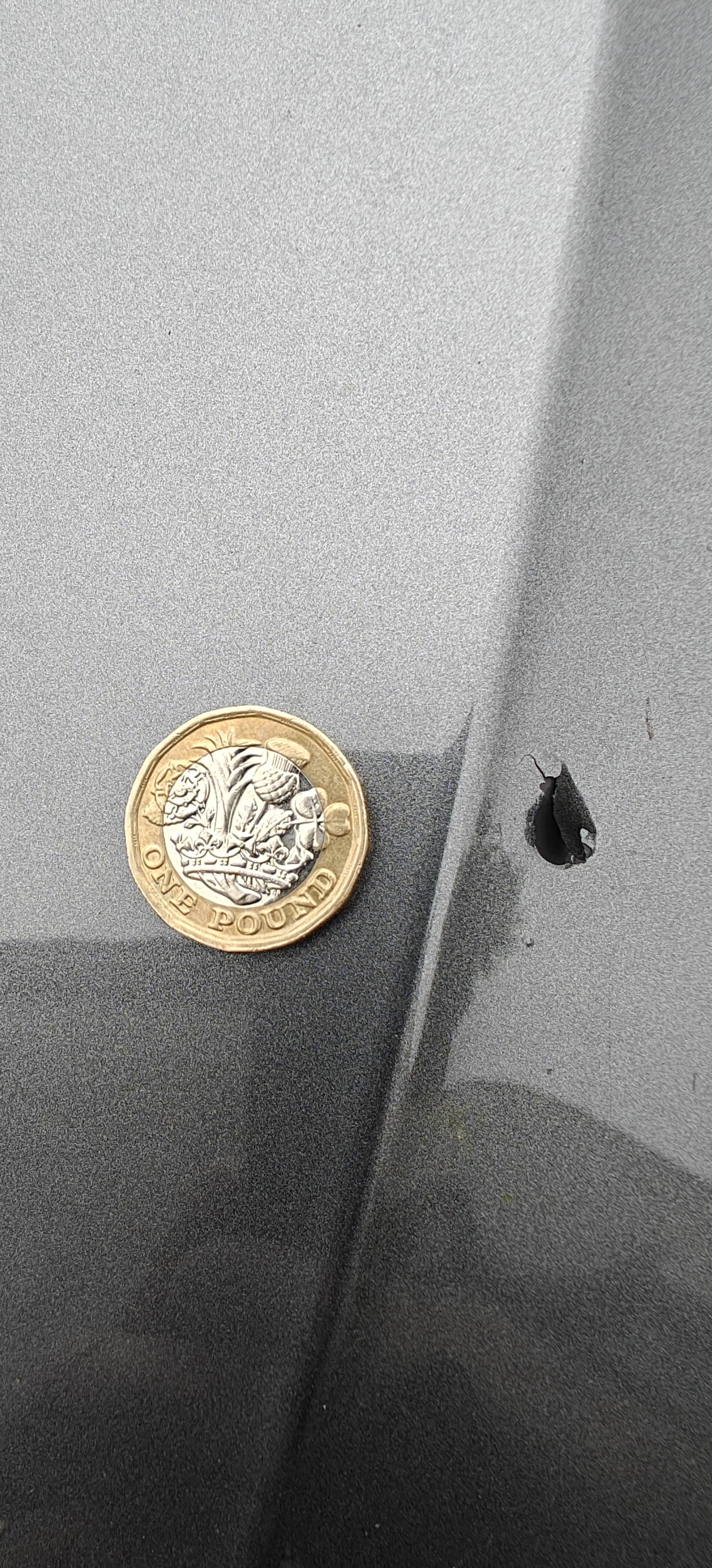

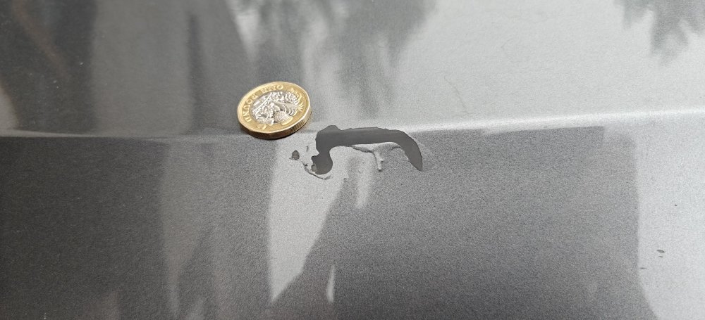

I had posted previously about a higher than expected number of stone chips and the general consensus seemed to be that Skoda paint is crap. Whilst cleaning the car yesterday, I noticed this on the bonnet - AFAIK, I have not been hit by stones / other and it looks like the paint is simply 'peeling' off the bonnet.
Has anyone else experienced this and if so, was it covered by warranty ? I'm with the dealer next Friday for oil change and will be raising it with them but any experiences / guidance welcome.
Has this been resprayed at some point?  It would certainly explain this and the excessive stone chips you’ve mentioned

Not that I'm aware of - I bought it from a Skoda dealer and nothing was mentioned at the time. I did get GardX coating on the paintwork as well.
Looks resprayed / repaired.   When you report it to an authorised repairer and they measure the paint they will likely confirm not factory finish or even finished to factory spec.      How old / many miles when you got the car?       Ask if they have a record of their car preparation and any paint correction and where the cat came to them from.    They should not lie.

Quite annoyingly with the GardX as the 'fine print' excludes "Paint/lacquer separating, peeling, cracking or flaking", hence my question on dealer warranty. I have checked through all the documentation I have and nothing is declared about any re-spray, nor was it mentioned by the dealer.
Under Skoda 3 year paint warranty, it states;
"The defect must not be due to external influences such as accident damage, stone chips, climatic, thermal, plant resin, animal pollutants, chemical or industrial pollution, insufficient care or maintenance. This will be determined by the member of the ŠKODA Authorised Network at the time of inspection."
I'm no expert but what I'm seeing doesn't align to the list above - it just looks like the paint is peeling rather than as a result of stone chip / other.
As I mentioned earlier, I'm with a dealer (Telford, Carlisle) next Friday so want to have as much information gleaned as possible before they shrug their shoulders and say 'tough ****'.
I was a car sprayer / repairers. I did warranty inspections and repairs and corrections.  Just looking close up at the pictures that looks resprayed to me.  The person that applied any treatment to the bonnet will have known if it was.    Any professional body repairer / sprayer will test it and know.  So whoever you report it to needs to have a competent and qualified person do the inspection and report.  Or first they take the pictures, the Warranty Managed can arrange the inspection.

There don't seem to be any stonechip dents, so maybe a bad respray. Can GardX protect from stone chips? Or is it another profit booster for the dealership?  In Lincolnshire the county council is infamous for the amount of chippings - laughably called surface dressing - it dumps each year, temporarily disguising and hiding the potholes it should actually repair. All my Skodas, and other cars have suffered from road rash and stone chips have required 3 replacement windscreens.  I hope you get a good response from the dealer....but suspect you may have to be determined and persistent.

Very helpful - thanks. Any other tell tale signs that the bonnet has been resprayed ?

Quick update. At dealers today and although they can't officially comment (as not an approved Skoda repair centre), a time-server mechanic did have a look and his (not the dealers) opinion is that the bonnet has been resprayed !!
I now have to take it to a Skoda approver repair centre for them to assess & comment but I'm not feeling hopeful. I suspect that the respray was done without the dealership I bought it from knowing that 😐

Update - just been to the Skoda approved repair centre to have the paint assessed. As suspected by many here, it is not original and has been resprayed. This was confirmed using a paint depth 'gun'. The bonnet measured 140 microns whilst the rest of the car was around 80 microns. He was surprised that the wings hadn't been done at the same time as that is quite common in order to get a good paint match. He also said that it wasn't a particularly good job as the paint has not bonded properly. 😒
The assessor then looked at the bonnet mechanism and said that the bonnet has been removed (either to be resprayed or replaced) as the paint 'seal' on the nuts that fix the bonnet on is scratched.
Whilst it doesn't need a respray now, it is going to continue to peel and will need done at some point (approx £600+VAT). To 'fix' it will mean stripping back to bare metal and going from there.
