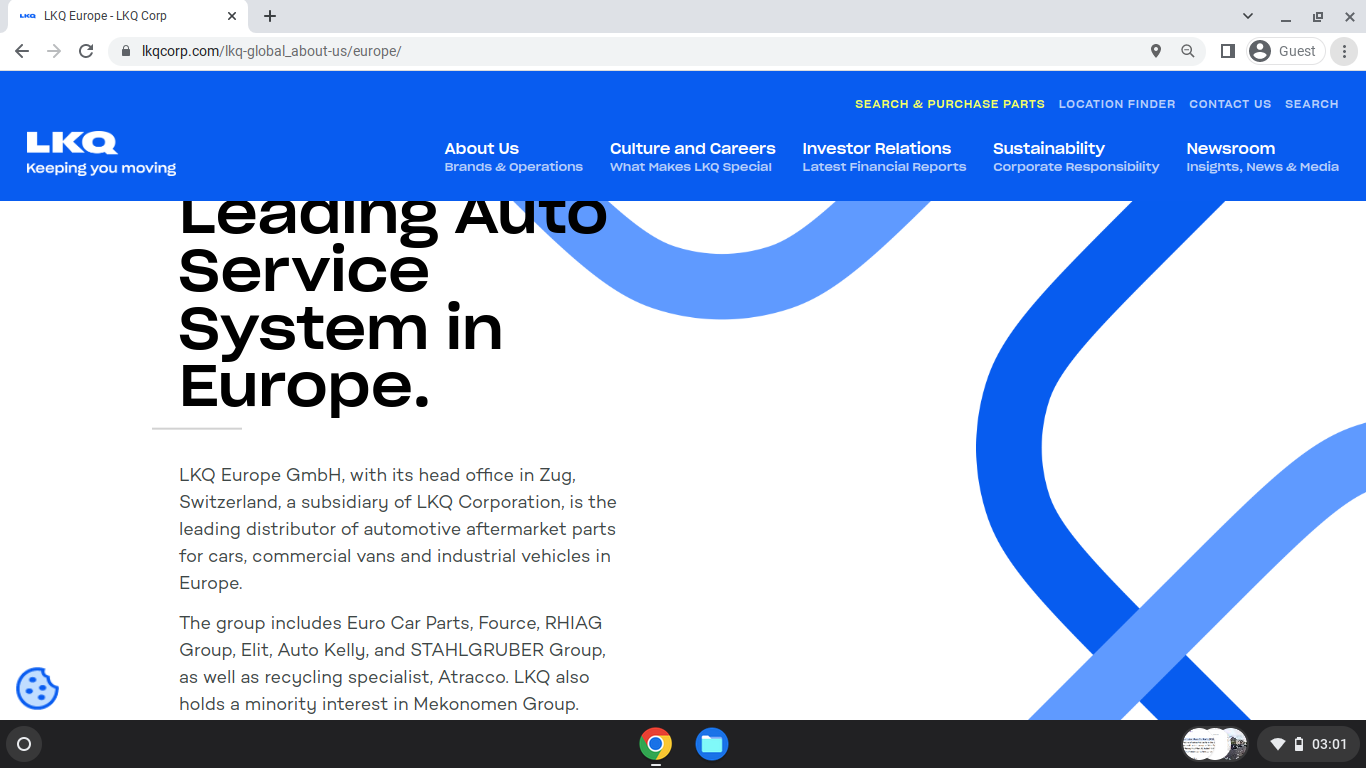

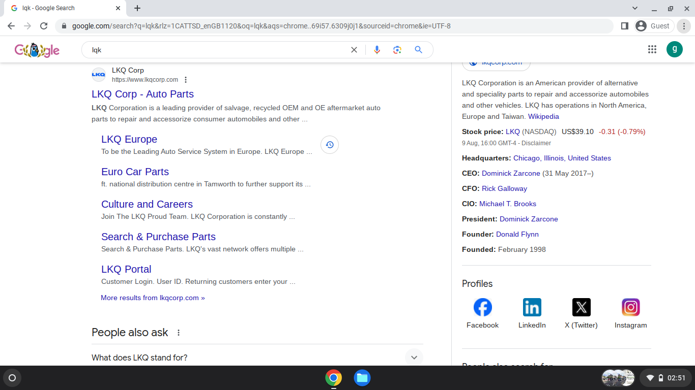

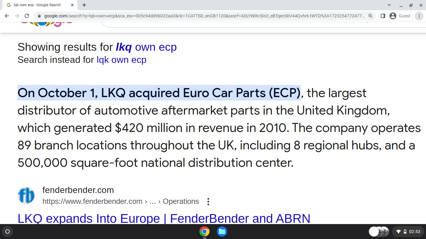

Pagid’s UK exclusivity with ECP is detailed on their website.
Which is the exact reason why I reported the fact that they were not selling the full range of pads, to TMD Friction UK ie probably the sales office of Mintex, back in maybe 2008 when I needed to buy new Pagid rear pads for my 2000 VW Passat 4Motion, the only Pagid offering from ECP had no anti-squeal "bits", which was almost okay as long as the sunroof was closed, and their only TMD Friction offering for the front brakes, Textar was listed on the TMD Friction webcat as being only for use in Japan!  That resulted in me being sent out (by TMD Friction UK), the correct pads for both ends FOC, which was good.
