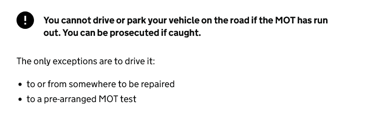

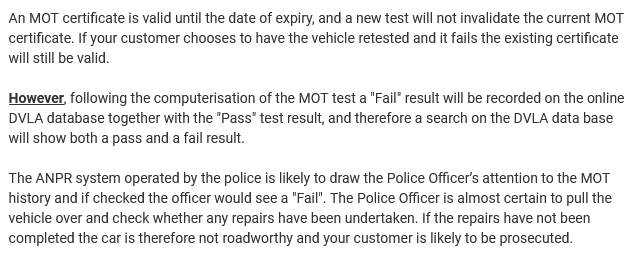

Screenshot2024-08-30at17-48-11IstheoldMOTcertificatestillvalidifthecarfailsaTestwhilststillMOTd-RetailMotorLaw.png.217360ac4da3b1202dfd0430c955878d.png
Screenshot2024-08-30at17-46-06GettinganMOTWhentogetanMOT-GOV_UK.png.ac7688222c7ef6f7a91080d3a06c8443.png
So you can drive the car  from the testing station because the old MOT is still valid, The Police would only be interested  if it was flagged as Dangerous.
If the light has only just come on it would be unlikely the pads were dangerous
