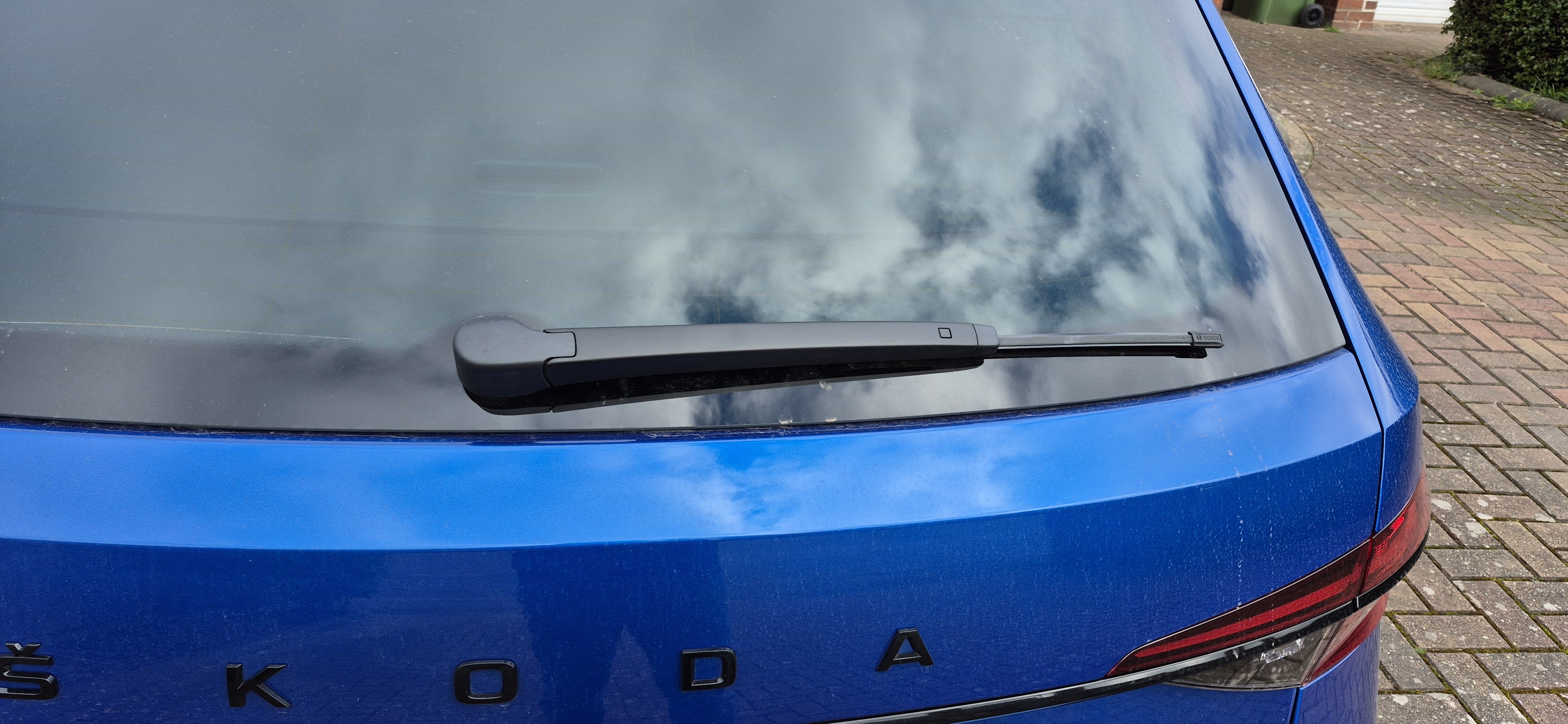

My wiper blade final arrived this afternoon. All went fine & fitted with a small suprise.
The new wiper arm actually has a 1-2cm large sweep than the original part, fitting is simple & the new arm is fully compatible with the Bosch A403H blade.
Total price for the new arm & bosch blade was €33 (24 + 8) not including the shipping so after 2 changes it is "cost neutral" to buying the new blade from Skoda directly.
Here are some photos of the new & old wiper arm together. Top is the original arm from the car & bottom is the Skoda replacement.
The original blade from the car has a higher quality finish (mottled effect instead of gloss plastic) but it doesnt really justify changing the design.
One thing I noticed on the table was the placement of the "clipping" hole means that with the new arm the blade sticks out ~2cm more than the original.
You can see this on the car once its fitted below.....
I didnt clean the glass before hand as I thought it would help me make sure it was aligned but actually it shows clearly the difference in the sweep of the blade.
Wash day is tomorrow I promise 😆

The silence when it wipes the window was worth the wait..
I really can't see any reason why Skoda changed the design & also why is taken so long for the 3rd party manufacturers to design a small adapter to make it fit to the existing aftermarket blade
