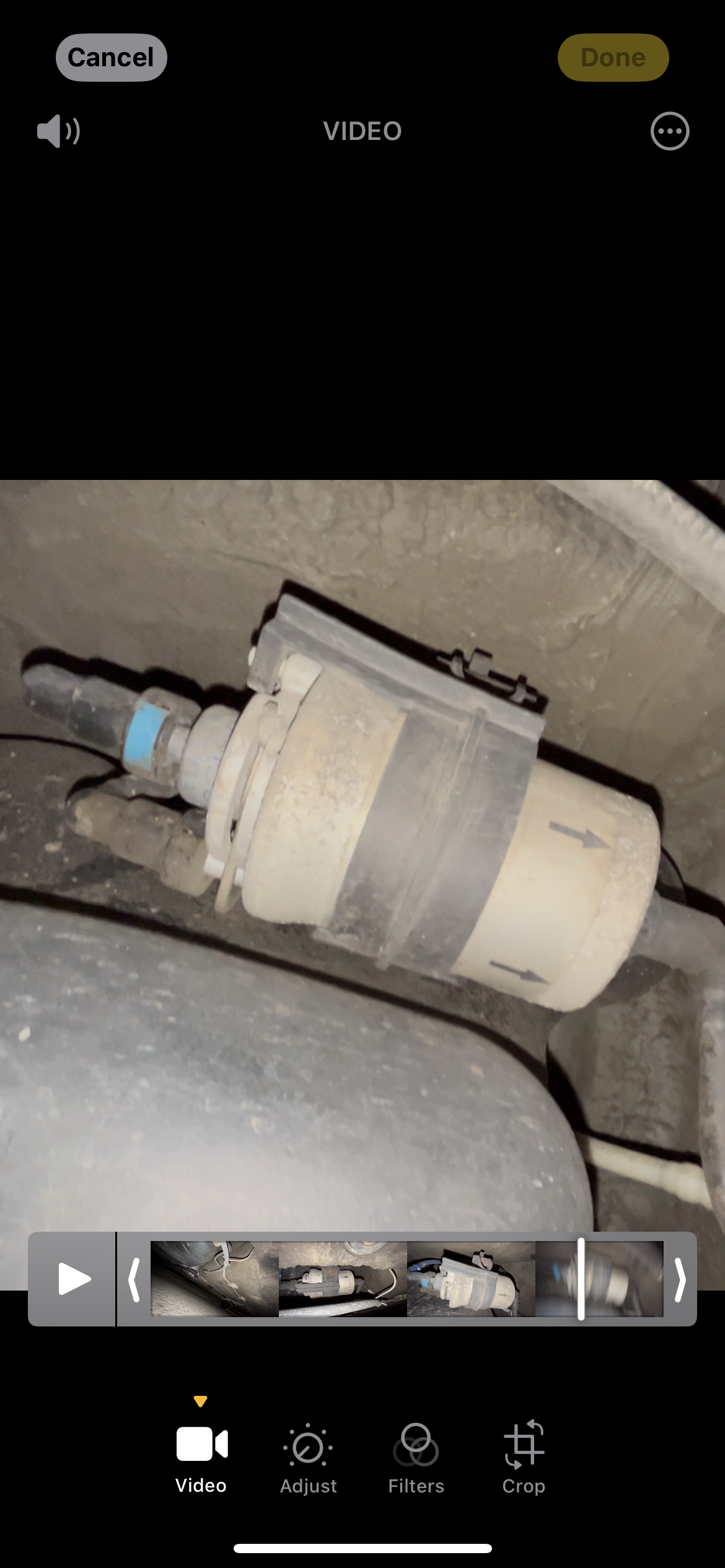

Does this photo attached help anyone identify which fuel filter I would need for my Fabia.
Its a 2005 facelift manual 1.4l 16v BBZ engine.
There are so many parts and variations. image.thumb.png.63982034e7e242b5297dd7f6dd0f4284.png
Somebody else will get back to you soon with the correct pressure version, what you need to be aware about is, initially VW Group only sold a single fuel fuel element for these cars - the the pressure regulator was different for different applications, then, it seems that common sense prevailed and the filter/regulator was sold as a single part, so that should explain why you are finding a few variations as some aftermarket sources might still be making the fuel filter element available - for you to fit to the regulator section of that lump.

Reg number or VIN will allow me to look up the correct pressure rating for you.

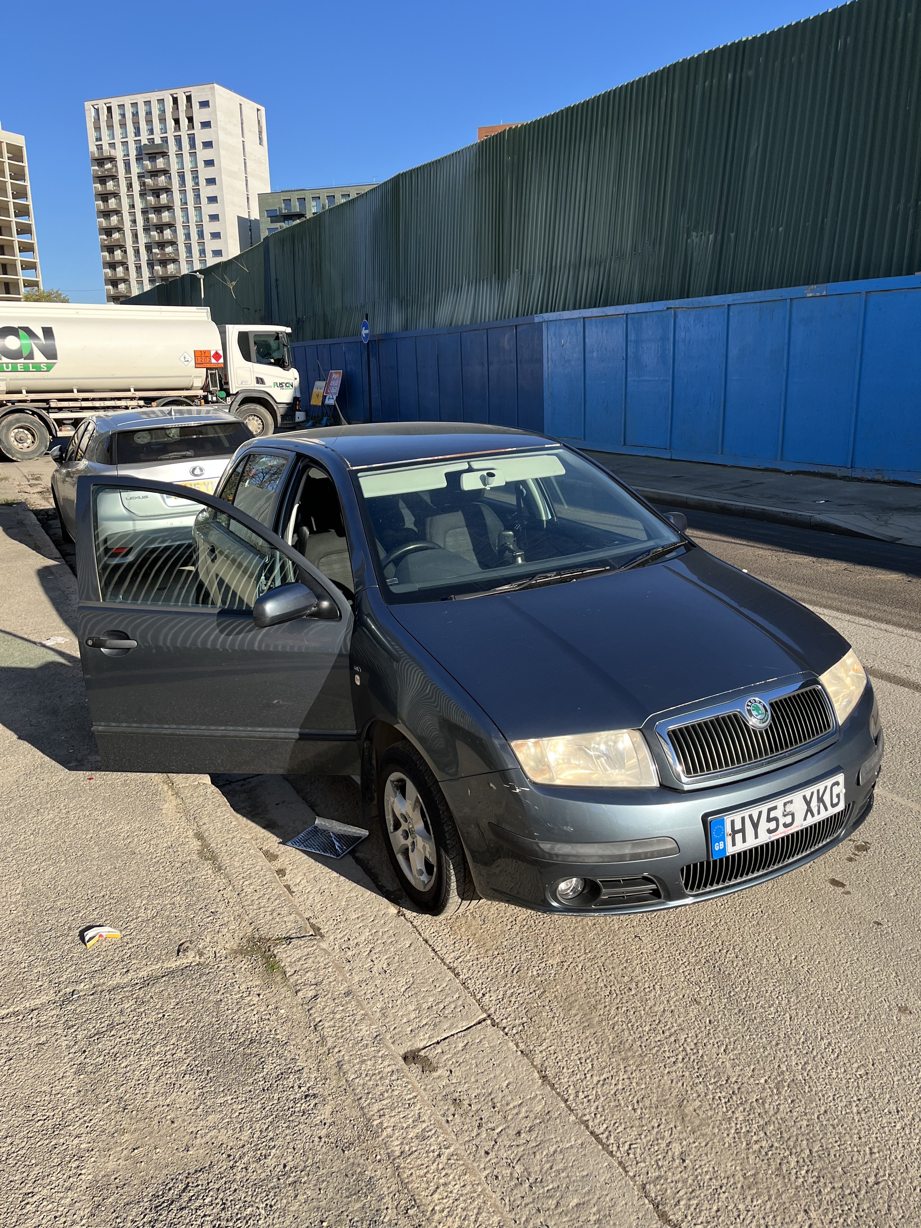

I really need a metallic grey front bumper and passenger wing too to get the car looking pretty. Then a headlight polish since the eyes are so big on this car.
Pic for attention - man I wish I could get a VRS bodykit for this colour..

3 bar fuel system on your car, current part number of filter including pressure regulator is 6Q0 201 051H.
1 hour ago, SpotnikHTP04 said:
these filters can be changed every 20k miles
You could change them every 20 miles if you were completely insane. Very little chance that there's anything wrong/degraded with the one you have on there, unless it has done huge mileage or been erroneously replaced with a 4-bar rated one.
The other risk associated with changing is that you'll damage a seal on one of the bits of pipework.
Really, unless it's the wrong rating (examine the ends, it's usually stamped somewhere), there's almost no chance whatsoever that replacement will improve anything.
