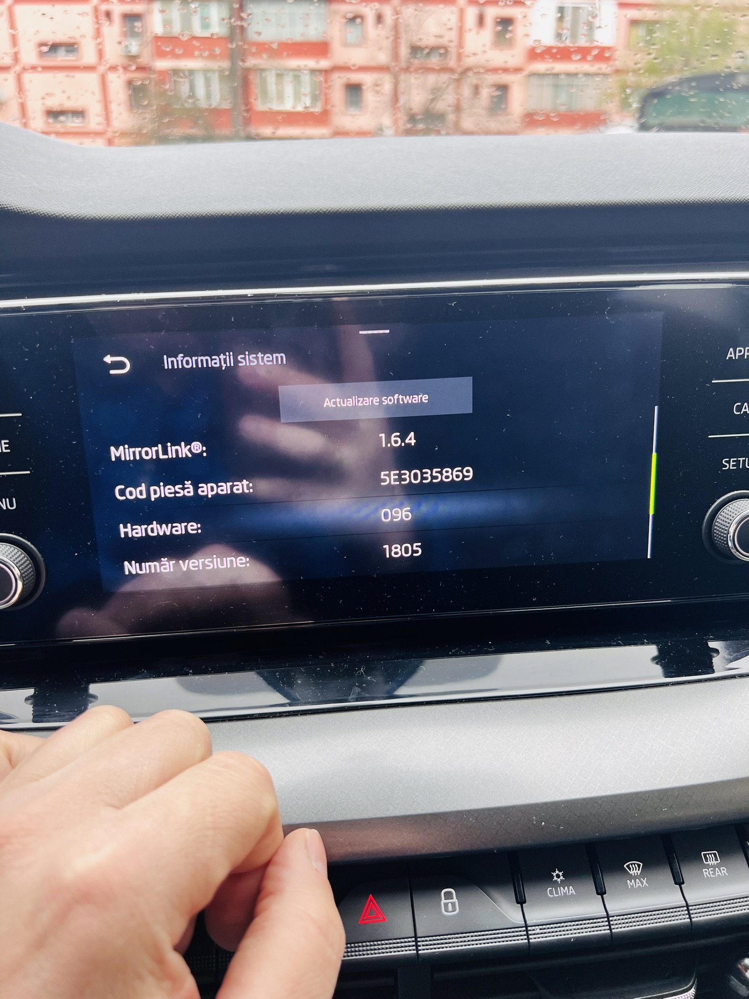

Skoda O4 Ambition from 2021 1.0TSI
Does exist any update for me?
