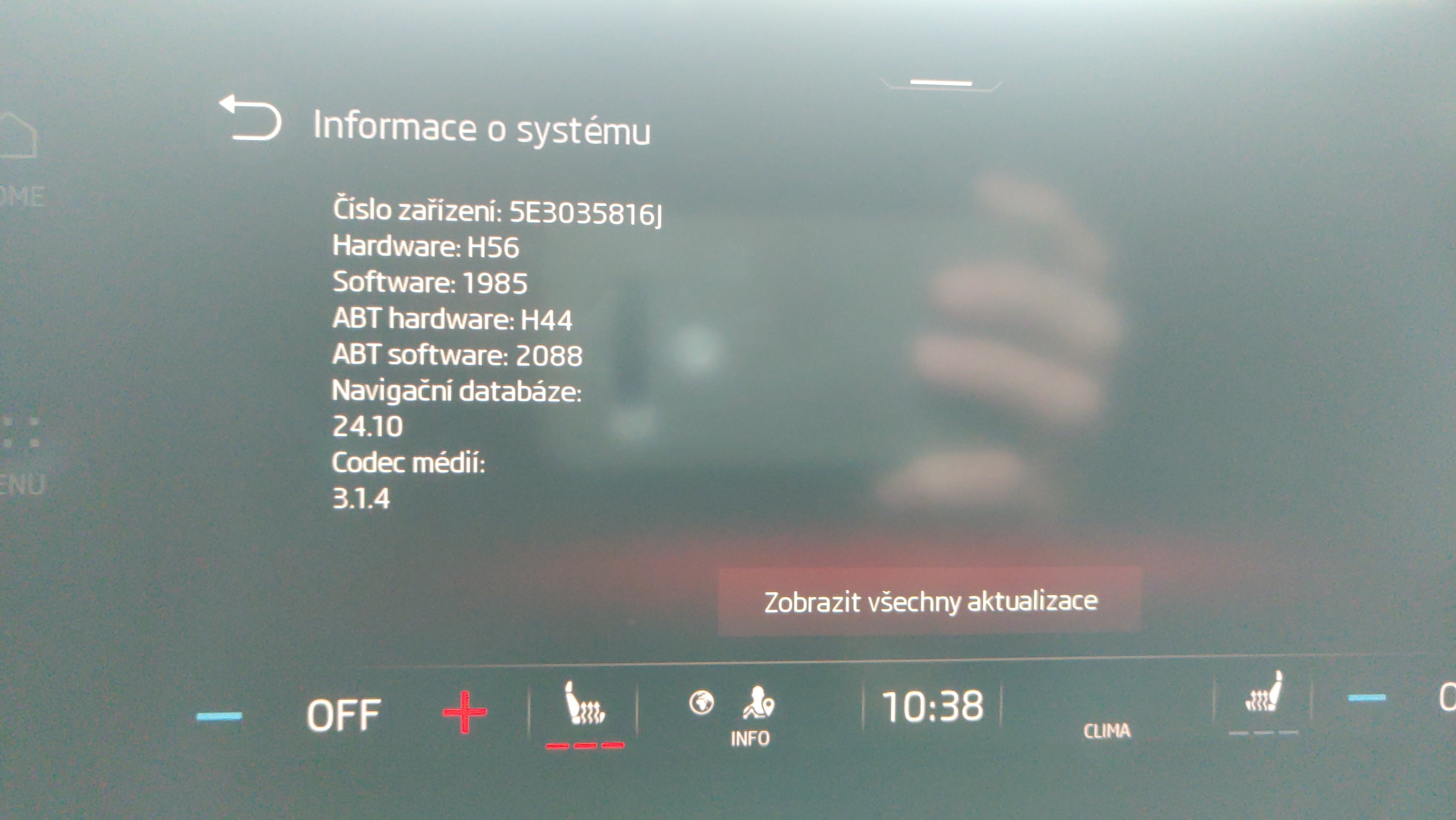

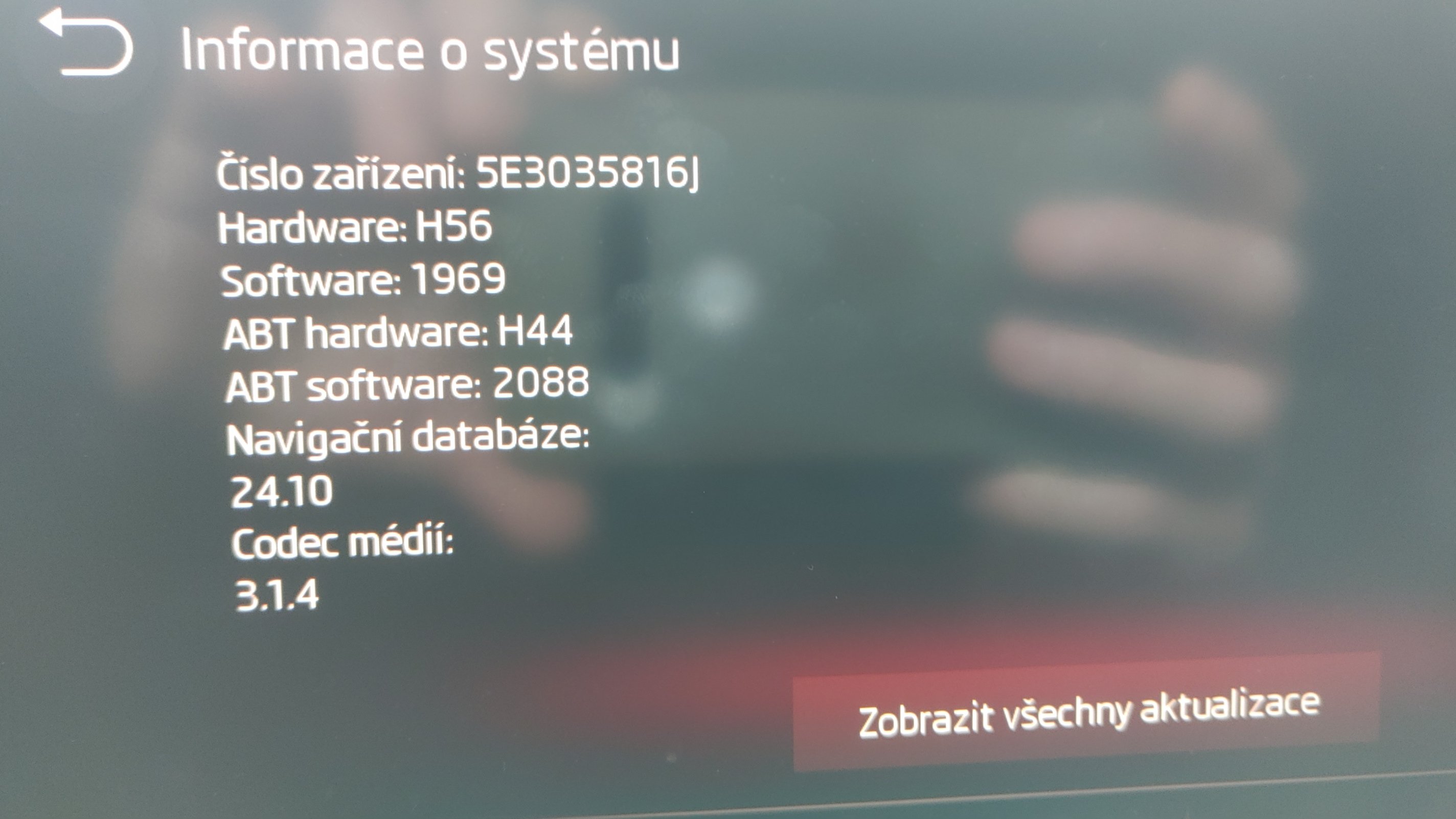

Hi. Thank you for the link to download update 1985. I updated today, it went fine and I already have version 1985. Update time about 19min. It's freezing outside so I preferred to leave the battery connected to the charger during the update. Everything is fine, we'll see how the system behaves. ver 1969 wasn't bad in 1, I only had to restart 2 times but otherwise fine. We'll see what version 1985 is like. At first glance, no changes, just the system started up faster. If anyone is interested and needs a previous update, I have the previous updates 1941 and 1969 saved on my PC. Just write it down and I won't share it anywhere.
