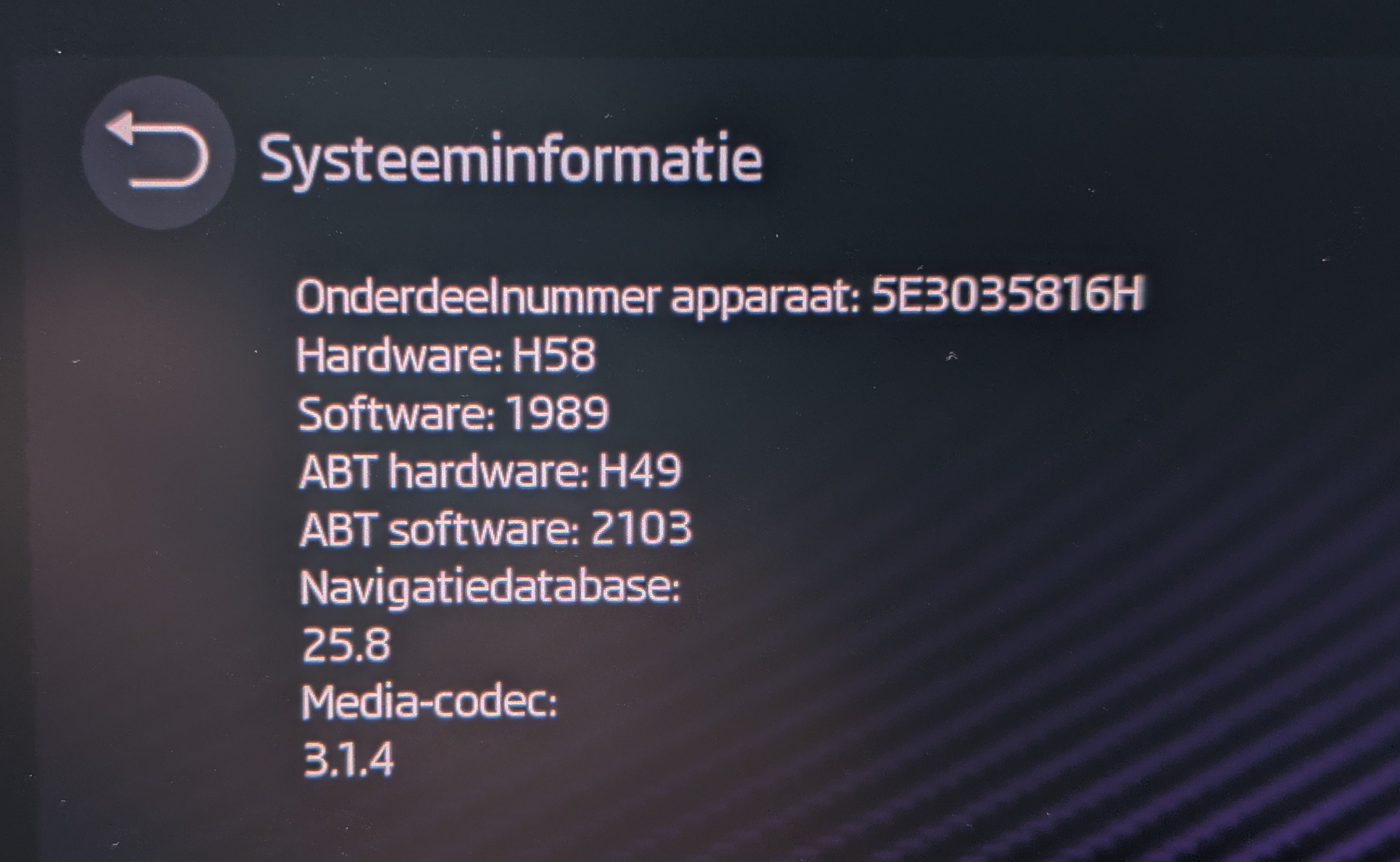

Yup 1989 is here
23 minutes ago, MartinOctavia1969 said:
Yup 1989 is here
OTA?
No I got it in a download from a Dutch fellow Member.
He is also active here don't know it is possible to share it here
