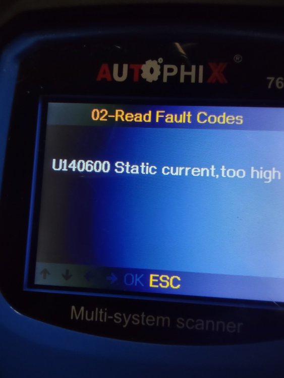

My Autophix 7610 scanner reckons there is still a fault. U140600 Static Current too high (see photo).  But I am not sure, having tested the current when the car is asleep at 155mA, whether that is too high or if my recharging the battery on my charger could be causing that?
Does anyone know what the quiescent current should be with the car locked, allowed to go to sleep, and then measured?  (I have a multimeter in series with the battery left connected till it goes to sleep).

Yes, 10-30mA territory is probably more what you should see.
Dashcams plugged into outlets that stay on permanently are notorious for this problem.
