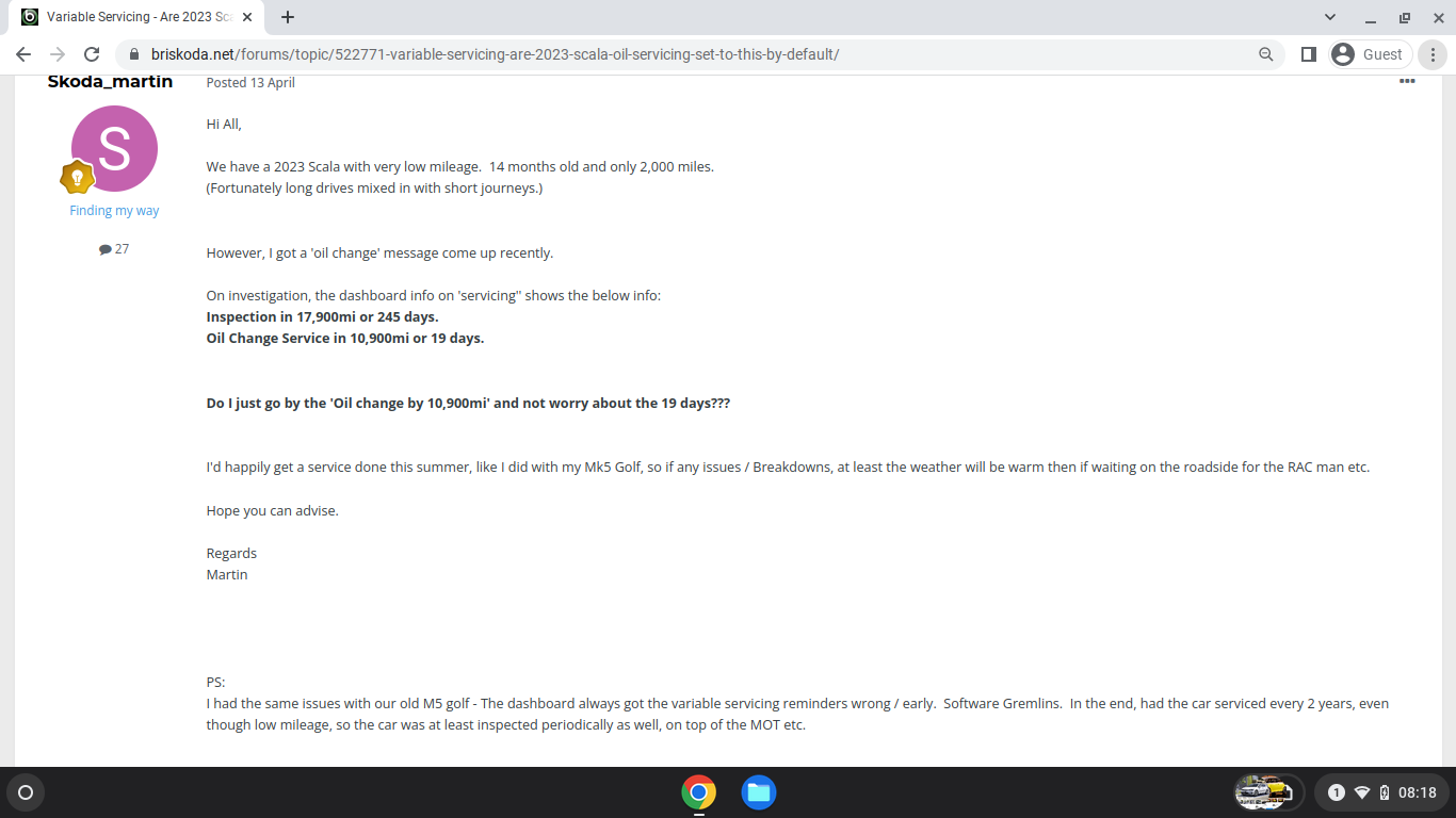

No idea about sensors, I have OBDeleven, can I use that to change it ?
