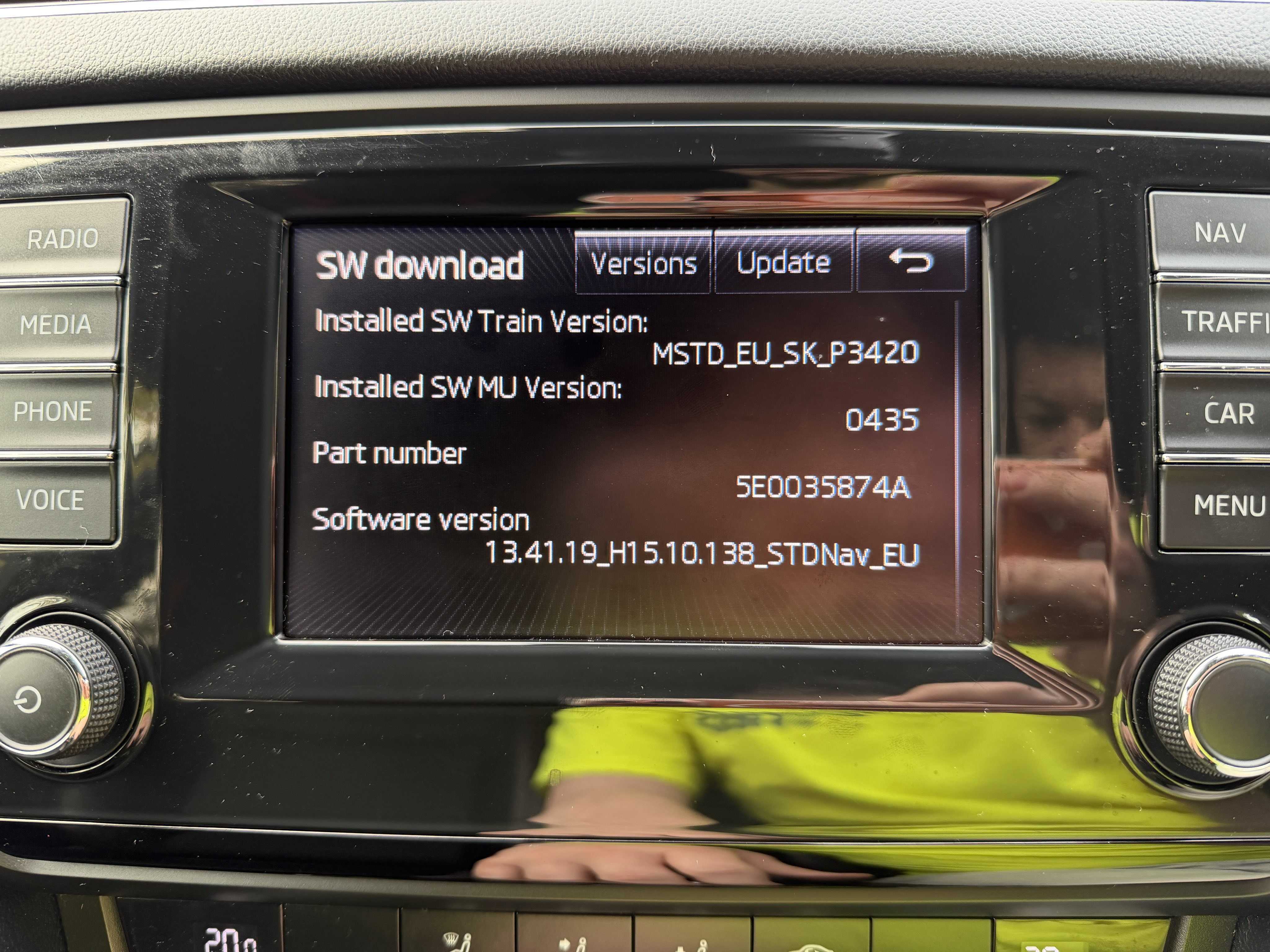

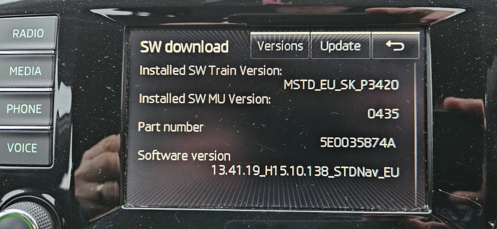

I have recently bought a 1.6 D Greenline Octavia Estate 2015 with 128k on the clock, its my first Skoda and I originally bought it as workhorse for my business and at £4k I wasn't too bothered about it to be honest, but the more I have drove it the more I have come to really like it and it wont be my last Skoda I have now gone about giving it some love, new disks, brakes, shocks etc and now I am trying to update the infotainmentcentre.
I have been on Mib helper after some research and my original SW Train Version is MSTD_EU_SK P3420 AND MIB Helper has said i need MSTD_EU_SK_P6230. I believe this file is not available on MIB solutions anymore so I was hoping if someone could send it to me if possible.
Thanks in advance.

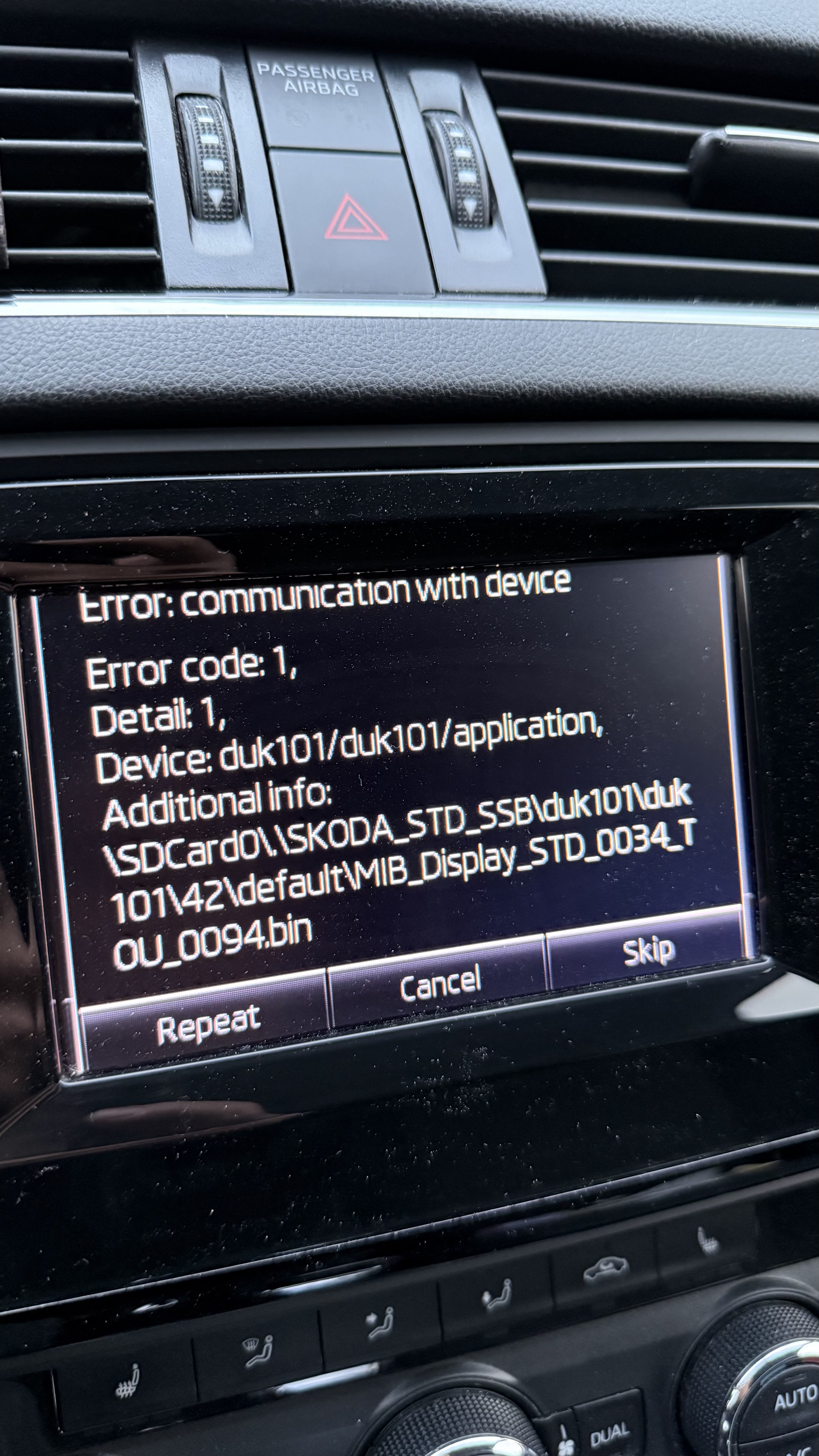

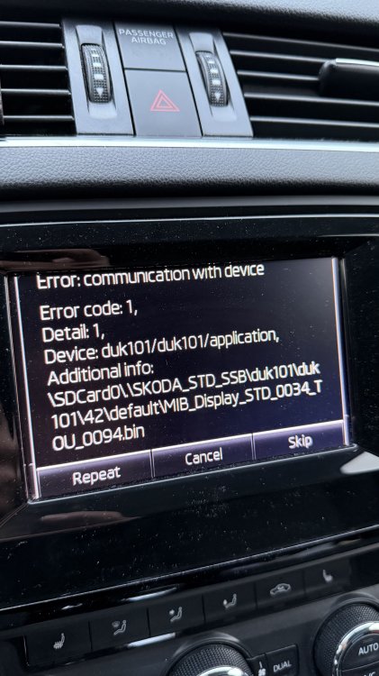

Looks like a problem with SD card, tray another

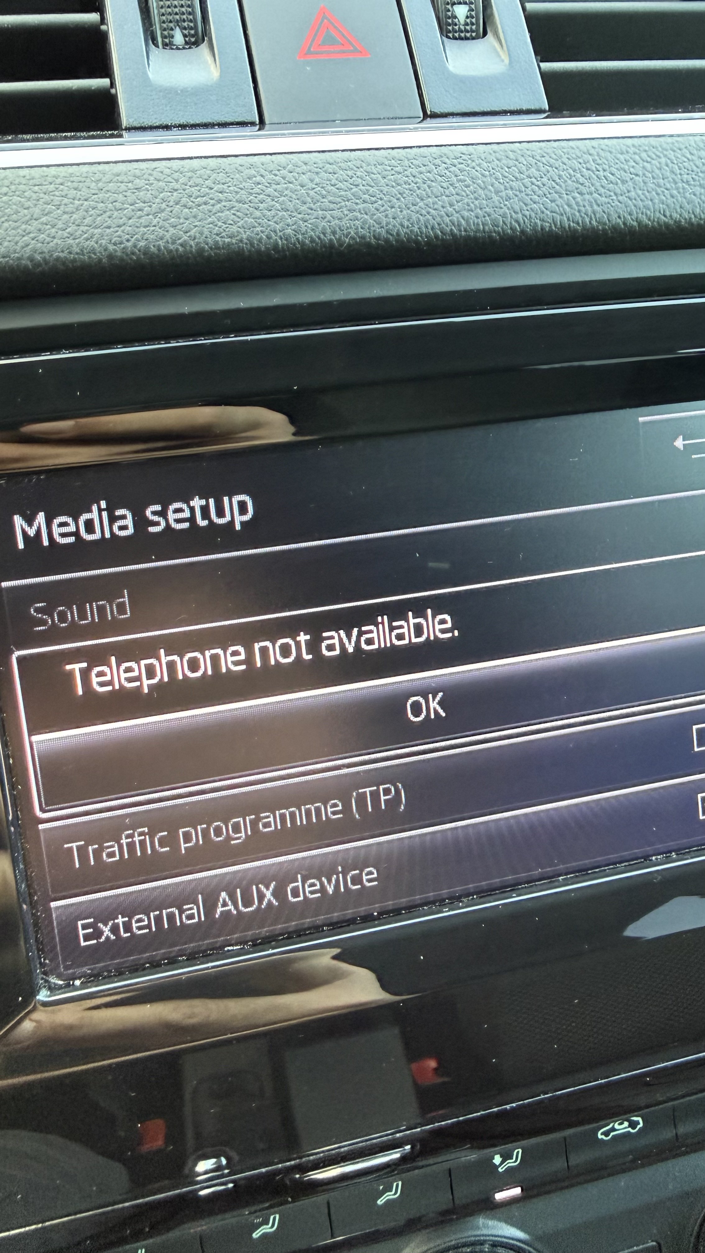

Thanks for the reply, I will try with another SD card , Im trying to update it because my bluetooth is not working it says “phone not available “
What's the part number of your unit? Like 5E0035812A, you can check it in settings / system info.
Its 5E0035812A
@pab567 can u help me with men2_eu_skgpx_p7381l
11 hours ago, Nikson said:
Its 5E0035812A
This unit does NOT have built-in Bluetooth at all :( I suggest replacemnt with MIB2 unit.
