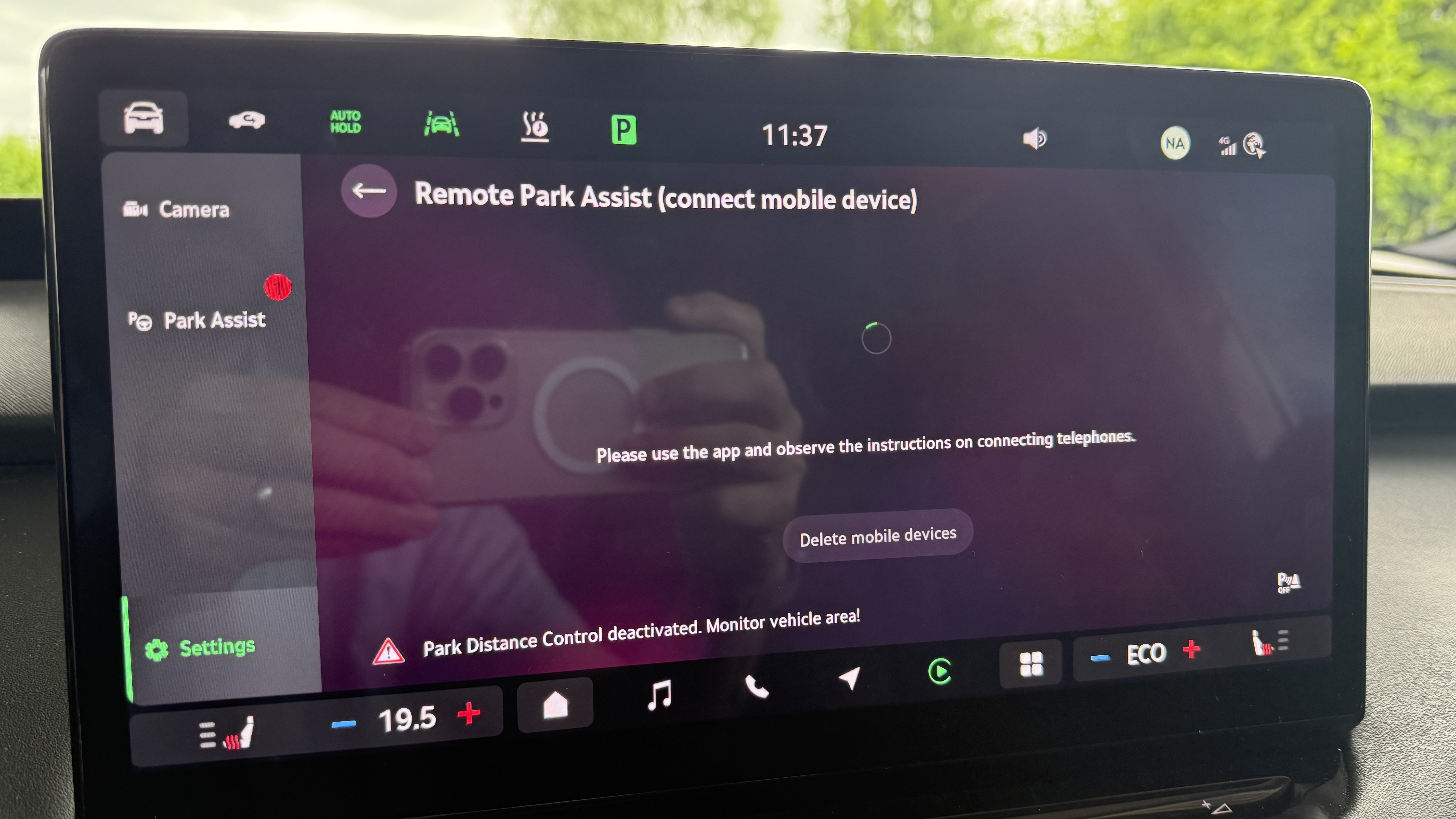

So, I am trying to pair the Skoda app with the car to utilise the remote parking assist. However when it gets to the part to scan the QR code nothing happens (see picture, it stays like this indefinitely). The car was previously paired but then removed. For information I have already tried resetting the app in my phone and I have restored the whole infotainment to factory settings and the set everything up again. The rest of the functions are paired with the app and working. I also don’t believe it is a connection issue as everything else requiring connection seems to be working fine.l, but who knows.
Any ideas or suggestions are most welcome.
Thank you in advance.
I have exactly the same on an Elroq. Did you manage to resolve this?

Hi, same issue here… I’m using an iPhone with the latest app version (in case that’s relevant)…

Same issue here. Enyaq 85 facelift. I am using an iPhone as well. Already deactivated CarPlay which had no effect...

I am experiencing exactly the same issues as described by you all. I have the max package, all other pairings between car and Phone are fine but not the oarking assistant.
Anyone who managed to resole this?
