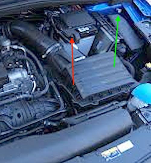

The image below is of the UK-nearside part of the engine compartment of a Fabia Mk 4 with 1.0litre motor. I've green-arrowed the earth-point and an (easily) removable protective cover over the battery's positive terminal is red-arrowed.

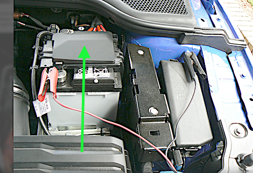

This image shows the starter-battery fitted to a Fabia Mk 4 with crocodile-clip charger cables connected to it.
The plastic cover (arrowed in green) protects a 'bus bar' carrying a set of connections, but (in my car's case) unclipping the cover does not help identify the battery's make, type or capacity.
Those data are not visually discernible on my car with the battery in situ. I can guess at the capacity (from the battery's dimensions) and my crystal-ball leads me to believe that it's EFB type and (possibly) a VARTA product. But I'm definitely not going to start disconnecting the stuff on the top of the battery just to confirm this.

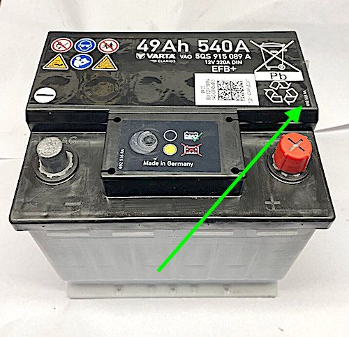

Although there are no immediately visible markings on my 2024 Fabia SE L's battery to identify its make, type and capacity, on the label near its positive terminal is the code "692 515 RA".
An internet search retrieves a German ebay advert for a new original VW/Audi/Seat/Skoda start/stop battery (€149) that carries that code . The advert includes the photo below (692 515 RA code green-arrowed) and the visible parts of my Fabia's battery match that photo.
Consequently, I'm happy to accept that my car's battery is a Varta product and EFB+ type.
The GOOGLE-search also retrieved larger size/capacity similar-appearance batteries (all EFB+ marked) said to be original-fit on VW/Audi/Seat/Skoda cars with start/stop.
