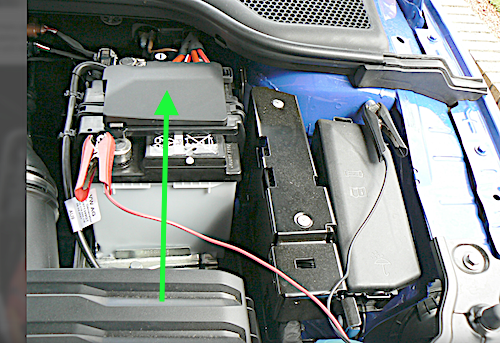

I decided to fit the included eyelet leads permanently under the bonnet. There's a large cylindrical nut in the engine compartment near to the fuse box and battery with a negative symbol on top. The negative lead eyelet is fitted there. With the positive lead I pushed up the black plastic flap over the battery terminal. Undoing the nut with a small mole wrench was hard work because it was very tight. I put the positive eyelet over the protruding screw thread and replaced the nut. That was the worst part because it was much harder to get the nut back on and tighten it up. I didn't need to disconnect the battery but was very careful not to short anything or drop the nut. You could use just the crocodile clip leads on each charging occasion if it's too much of a fiddle to fit the eyelet cables but remember to use an earthing point rather than the battery negative terminal.
Push in the eyelets leads connector just fitted on to the charger's connector. Plug in the Ctek and as soon as you switch on the mains charging starts. The cable fitted to the charger itself is unlikely to be long enough to reach a mains socket. I've ordered a Ctek 2.5m extension cable to use in future.
The battery charger checks automatically the type of 12v battery, selects the required mode and gets on with the job. After four hours the charger showed a green light meaning a full charge. This charger is very easy to install and use but it'll be a while before we find out if it helps with the glitches.

This photo was provided showing a CTEK charger connected to the Fabia's battery using crocodile clips.
The small protective plastic cover over the battery's positive has been taken off in order to attach the (red) crocodile clip, but this takes just seconds to remove (and subsequently replace!)

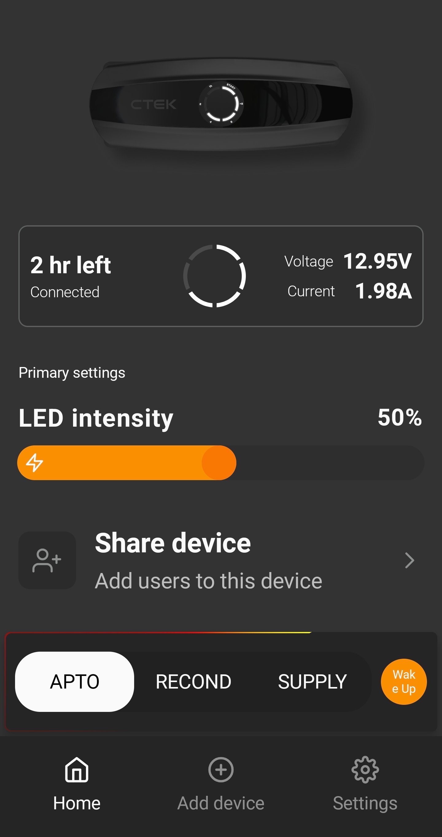

As the Ctek one is bluetooth you can bring up the voltage and current at any time.
I believe the wake function allows connection to a totally flat battery.

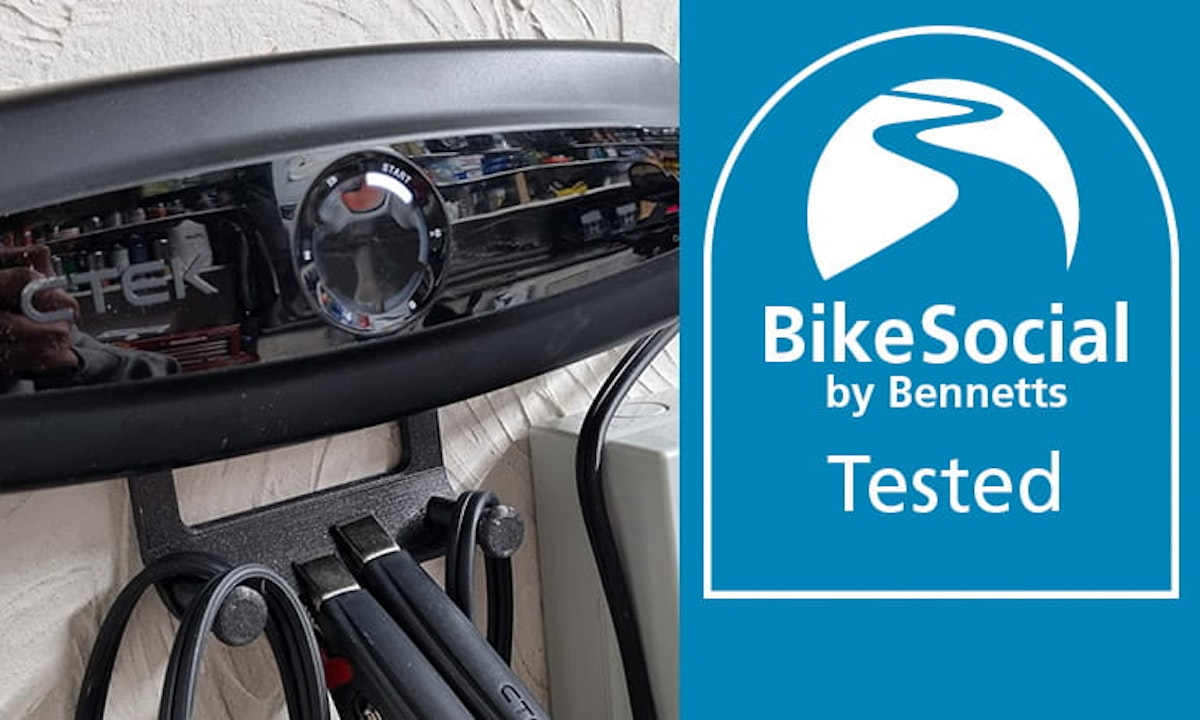

I bought the wall mount bracket for the Cteck One and have it permanently mounted on my garage wall and it conveniently doubles as a cable tidy.
