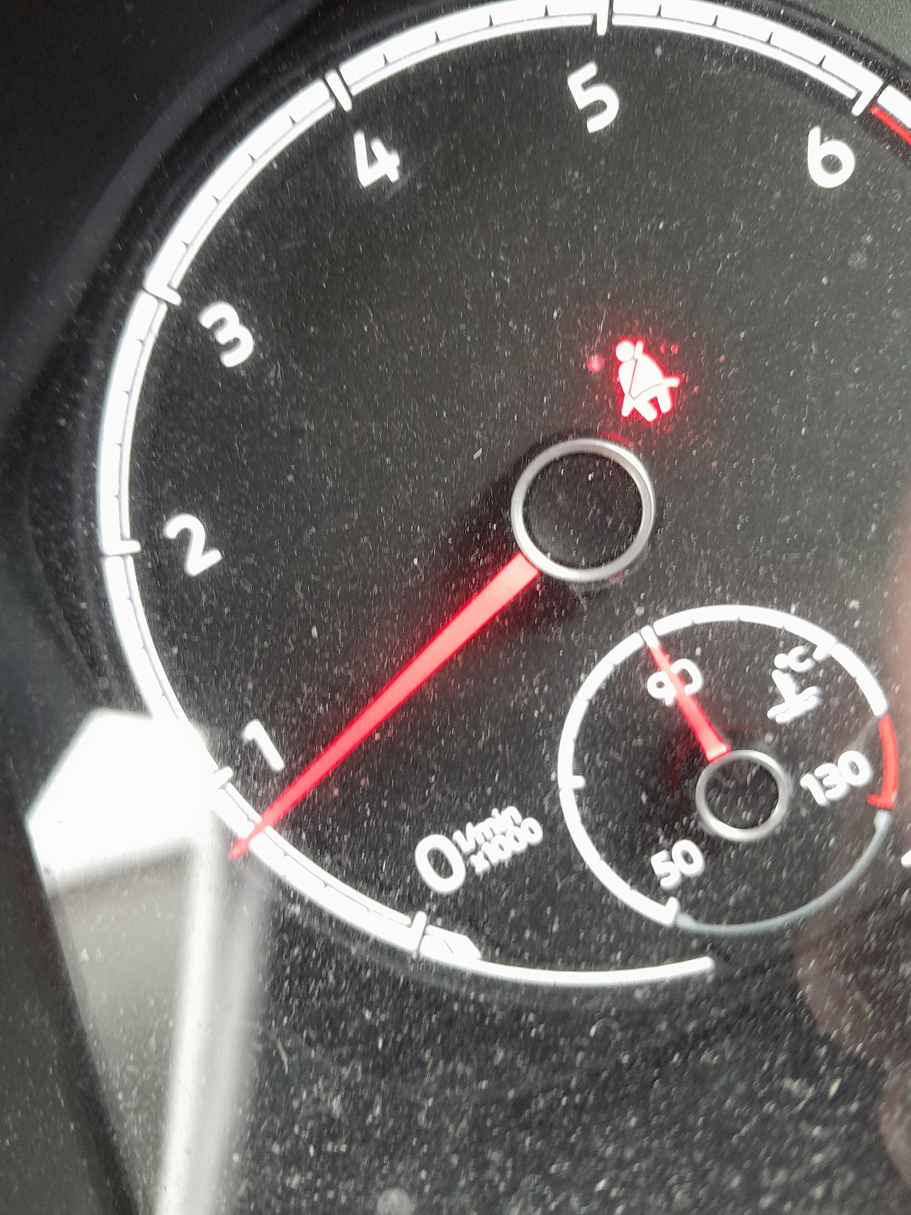

The coolant temperature needle gauge has for a few decades been biased to read 90c for driver reassurance rather than the real variable reading, in the 70s the markings were removed from coolant gauges to stop drivers worrying about the variables, same would go for 12v battery gauges.
1970s
1960s
"Comfort" coolant temperature gauges have been a feature of VW and VAG? group cars since at least 2000, the gauges do display numbers, 50C to 130C, they are supposed to roughly give a true reading up to 70C although my 2019 Polo seems to say, up to ~ 60C and will then rise rapidly to a constant 90C but will again read correctly from a alleged 107C, I did prefer the simple type which would sit under normal driving conditions right in the centre of the gauge, might only move by the thickness of the indicator and only moved up really in idling conditions until the rad fan cut in via its thermoswitch.
I don't know what the thermoswitch settings are in this Polo but on another 2005 Polo are set.....
Fan Speed 1 ON at 91C to 97C.    OFF at 91 to 84C.
Fan Speed 2 ON at 99C to 105C.  OFF at 98 to 91C.
Thermostat begins opening at 84C.  Fully Open at 98C.

So your 2019 has a digital coolant gauge, my wife's has a needle dial which is good enough as if I want to know when the engine is up to temperature I use the digital oil temperature gauge which can be displayed in the maxidot display.
I like the term comfort, first time I've seen that.
On British "classic" old over-priced and over-valued cars with the truer reading mechanical dual gauges you could watch the gauge needles move with the actions of the car, or rise if stuck in traffic (not that what they displayed was always accurate) but you got used to normal readings for your car and with these unbiased gauges only inexperienced owners would worry about the numbers others got or whether the needle sat in the middle or on 'N'. A V8 engined owner put sitting in traffic for a long time on a hot day he had the 'water' needle go into the upper section of the 'oil' without any engine overheating issues, some inexperienced owners would have called the breakdown services.

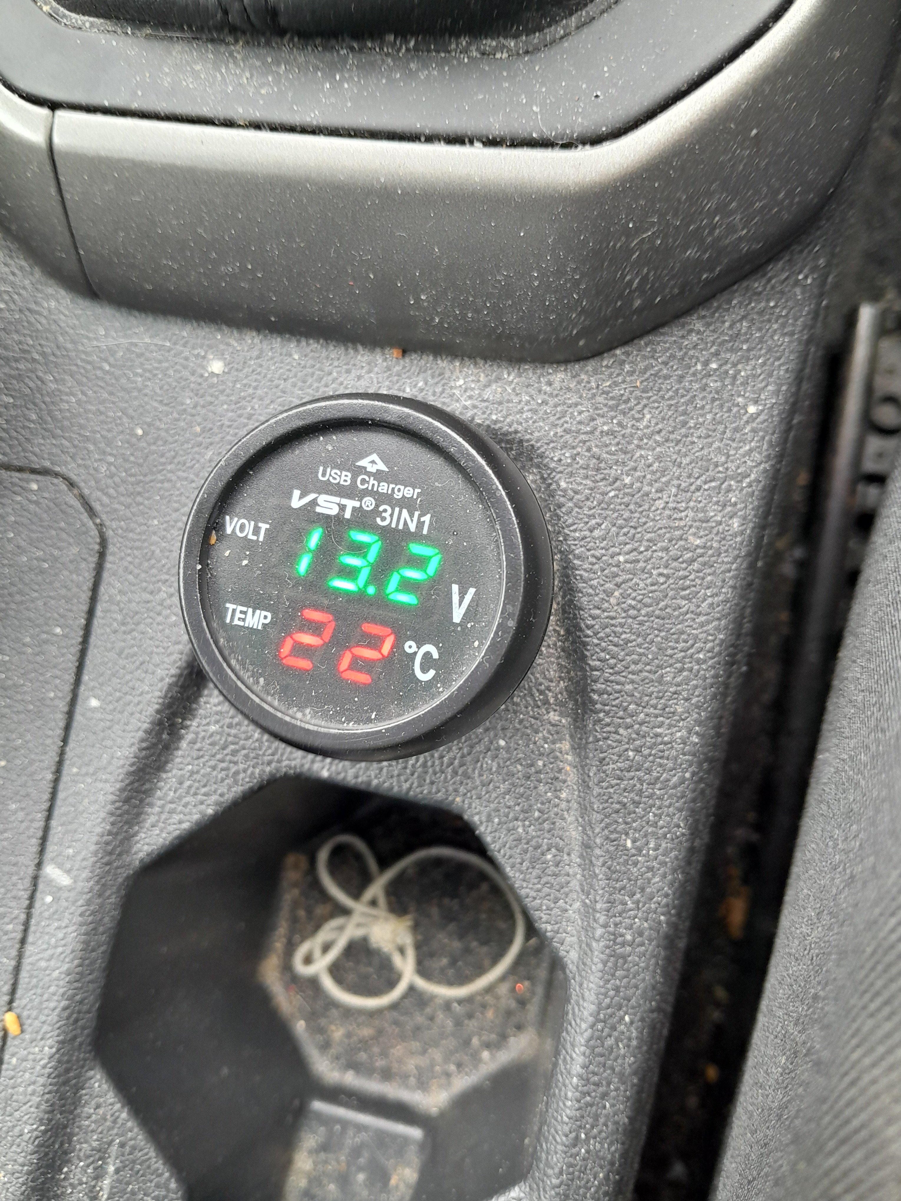

My DVM cost ~ £5 and also displays the interior temperature which most cars do not, even with all their fancy AC controls. I can leave it plugged in permanently as no parasitic loss because the ignition must be on to power the auxiliary power socket.
Shortly before a 50 mile trip, VCDS showed a battey 73% SOC & "at rest" 12.4V, the DVM never fell below 14.1V until the ~ 1 hour trip was almost completed but then fell to 13.2V and VCDS then showed a 83% SOC and 12.6V "at rest".
