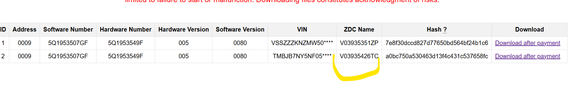

I think I need flash to 5Q1953507GF and upload dataset V03935426TC, that my guess. it is probably too complicated - finally I will try to find original GF and then only simple coding will be needed..

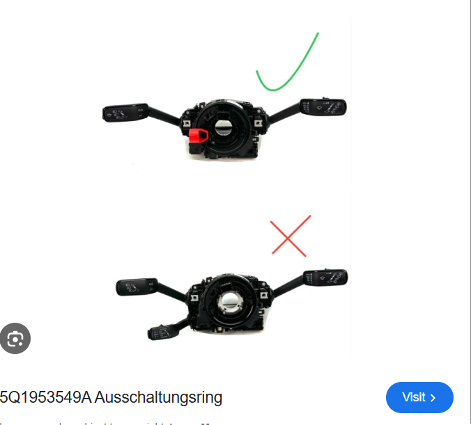

Hello, i have NX 2023 only with standart cruise control and manual gearbox, so i dont need ACC, but i wnat to retrofit heated steering wheel and code TA it shoud be possible without capacitve stearing wheel.. Can somone help me with parts? I just dont know wich steering column i have to get ? I found 5Q1953549A, it shoud have heating but i dont know if it is the correct one for my car, than i need the cable (that from ali for 5q1 is good i thnik ? ) and steering wheel.

5Q1953549A probably fit if you have 2 levers in your combination switch. Check first what is your original configuration of whole combination switch. You can open top cover without disassembly steering wheel or read what is in your subsystem

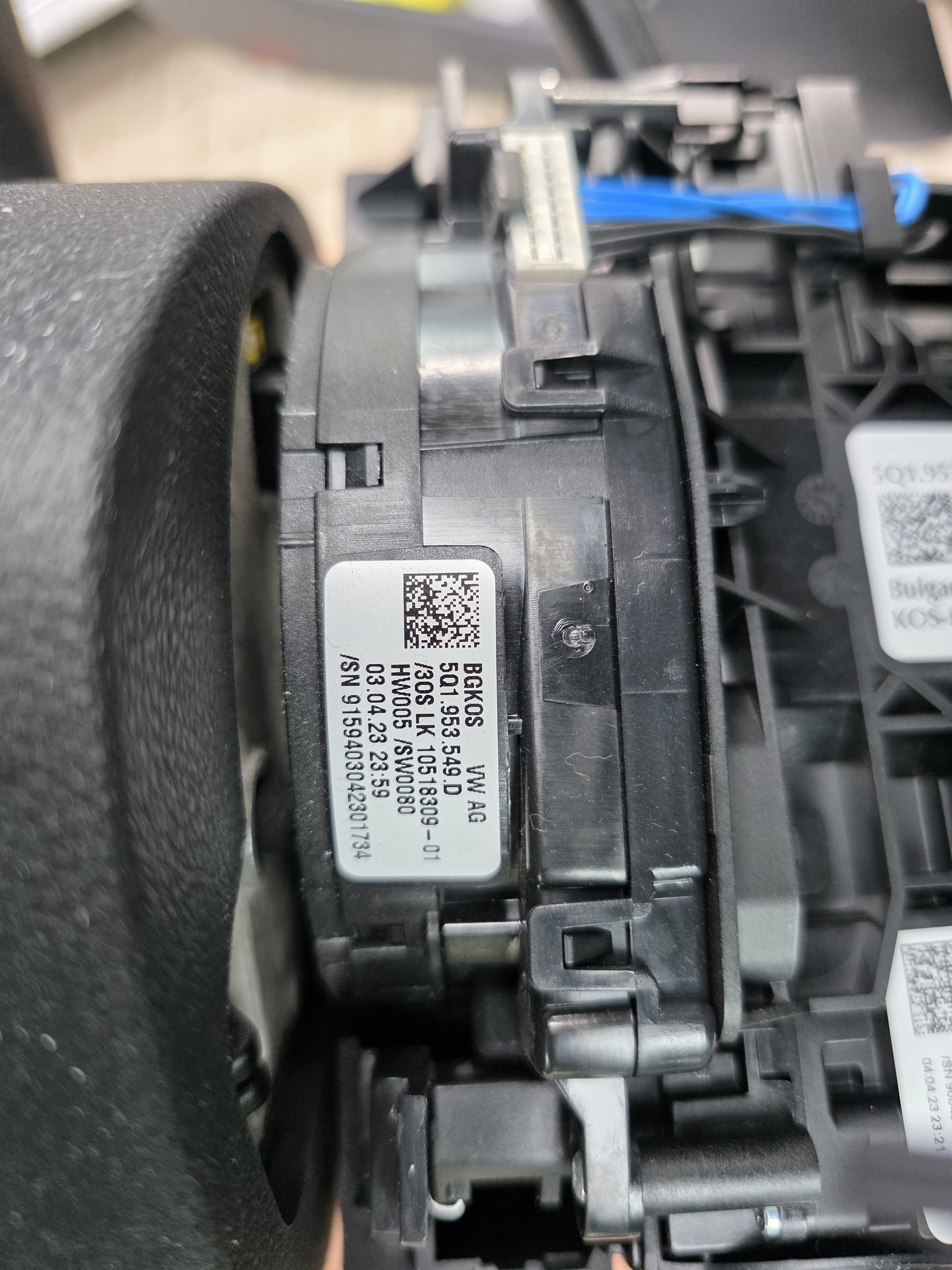

This is in the car now
Most probably you need HW: 5Q1953549F Currently in your subsystem 6 - Part No SW: 5Q1 953 507 FN HW: 5Q1 953 549 D. I'm not sure about SW. SW is the same like whole combination switch. Read my case - I was ordered two 5Q1953549F which was not fit due to software inside. Finally I got proper one with both parameters matching my car. My ETKA account was expired so I can't looked in your VIN configuration. Maybe someone else have and make advice.
