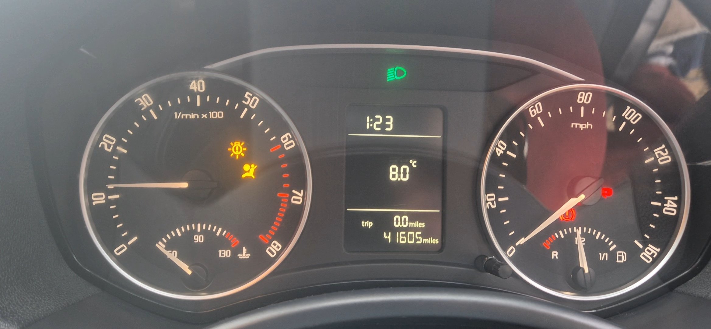

Hello,
I recently had a major issue with my 2010 vrs... it originally started 4-5 weeks ago, when the airbag like came on the dash and at the same time, the door locks kept trying to unlock constantly while driving... a couple of days later, all the warning lights started flickering on and off on the dash, the backlight keeps flickering on and off and its beeping loudly.
I had a local auto electrician have a look at it and when he plugged his computer in, he was struggling to get it to connect to the cluster... in the end, he sent it off to a company to get it repaired... they had it for almost 2 weeks and came to the conclusion that its unfixable...

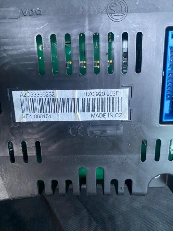

Is 1Z0920903F a maxidot instrument cluster? Do you have mph on the speedo clock face or only kph?
Can you check the part number, 1Z0920943F would make more sense.

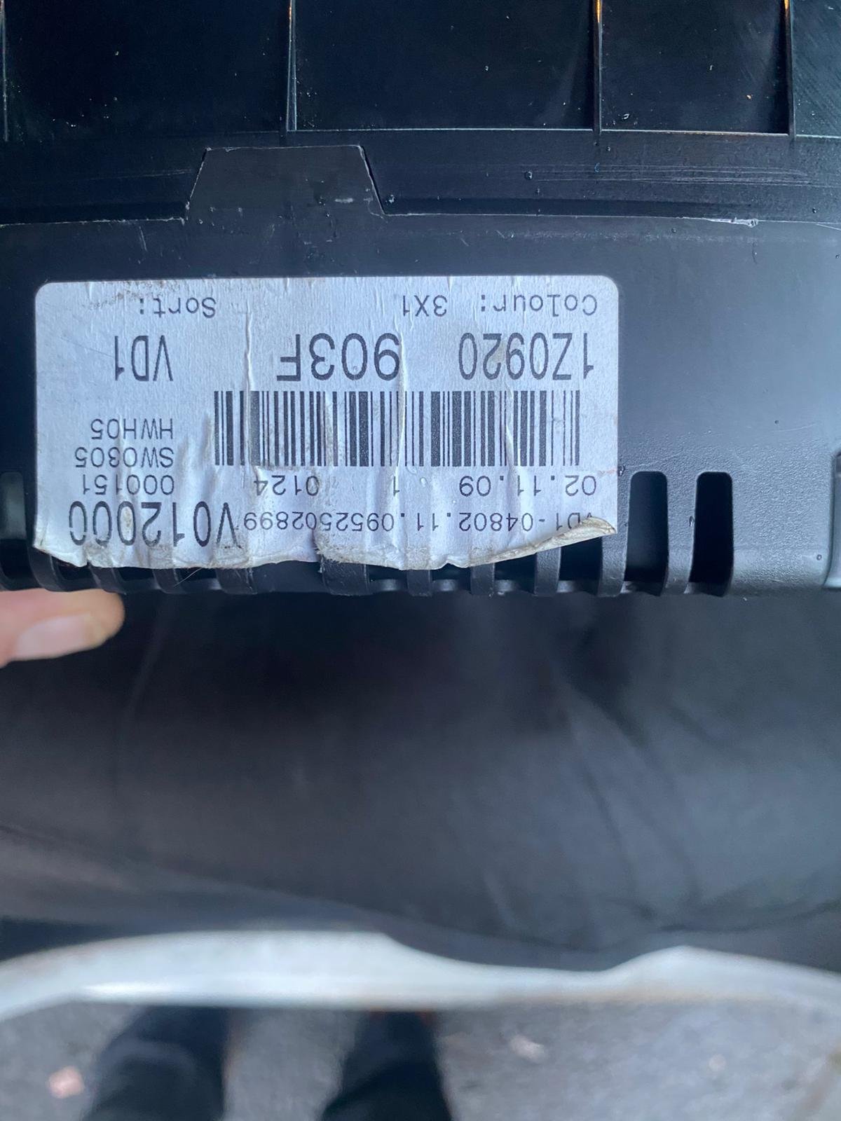

Hello, thanks for the reply... I will add some photo's of the rear of the cluster, it is definitely 903...

I've just uploaded a video of what the cluster is doing on my YouTube... the file was too big to upload onto here.
https://youtu.be/uSSe2sjRP_I?si=KUvFmZfxICYNm1vX

I suspect the cluster is a European model non VRS cluster with the clock faces swapped over from the original factory fitted cluster to make it look like a UK model cluster. That would not be a problem as the circuit board are the same anyway, if correctly coded.
Petrol VRS (UK only) cluster part numbers are 1Z0920943C SW: 01xx, 1Z0920943H SW: 03xx, 1Z0920943L SW: 04xx and 1Z0920943R SW: 06xx.
1Z0920943F SW: 03xx is the non VRS of the VRS "H" suffix.
In answer to your question yes 1Z0920943R SW: 06xx would be a suitable (and better) replacement for a UK model petrol VRS. There is a separate handbrake 'On' warning lamp (rev counter side) as opposed to using the ABS warning lamp in a duel role (Handbrake On/Brake Failure).

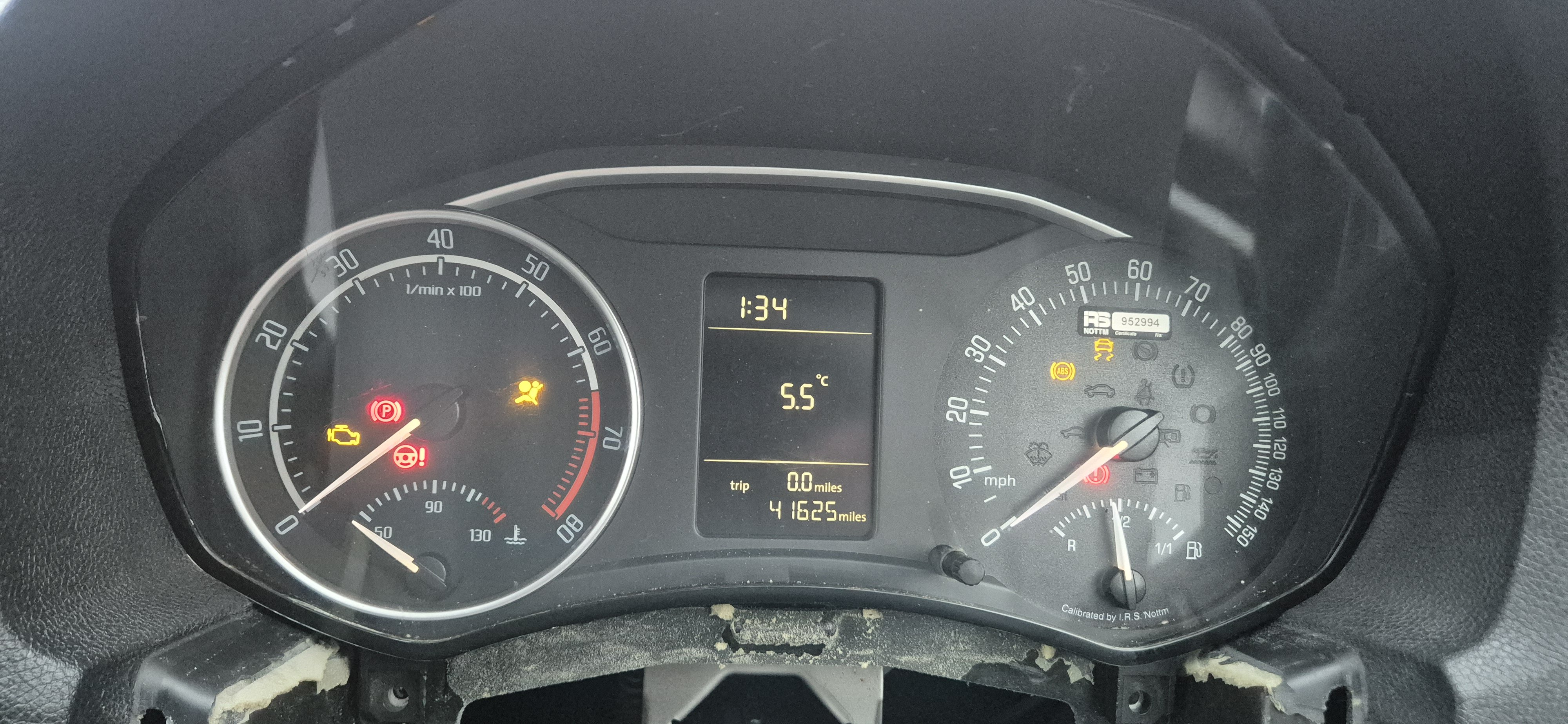

So a little update on whats going on... i just recieved my new cluster from being cloned by JCcars...
I just plugged her into the car, connected battery up and started the car... exactly the same issues as before. Loads of beeping, lights flickering on the dash, doors trying to constantly unlock...
I dont have a clue where to go from here now 😩😩

I've uploaded a photo of the lights on the dash...
Sorry, Bad Work from JCars
He didn't clone anything. He read the immobilizer data from the old speedometer and one key, and wrote that data to the new speedometer. The second key is not stored in the new speedometer.
