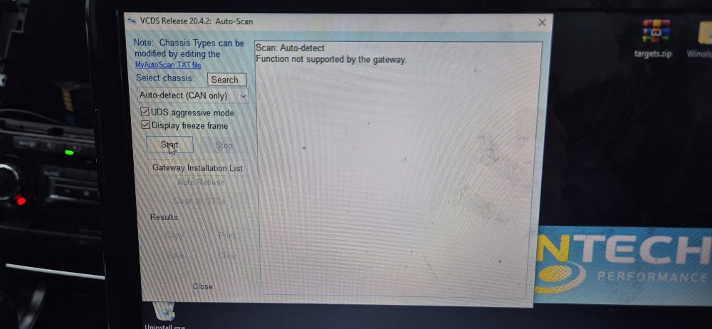

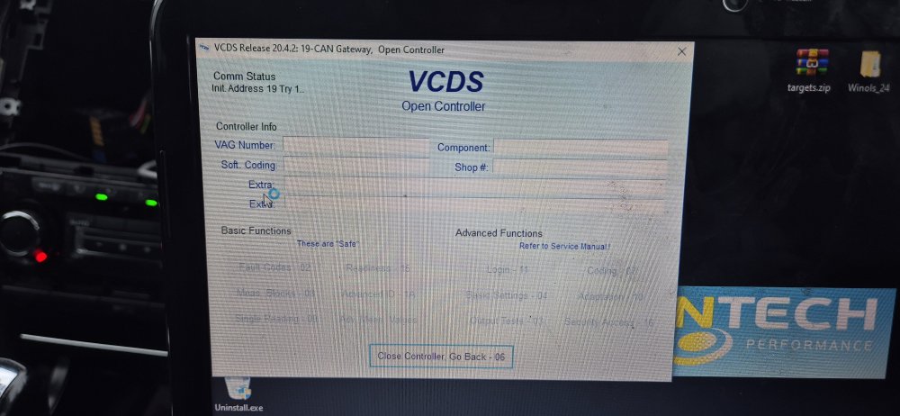

So another small update... my pal with VCDS finally came over today... we tried plugging the car in with the aftermarket head unit in and it didnt want to connect at all... disconnected the head unit, then VCDS tried to connect to the car... then it failed to connect... i've attached a photo of the message VCDS said.
My other pal is going to come round tomorrow and have a deep dive on the car, he thinks it could be a faulty BCM.
We still dont understand why we can't connect to the car though!

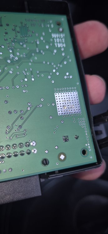

So we've now removed the BCM and also the gateway module to check them for water ingress etc...
The BCM looks brand new inside, absolute zero damage to the circuit board...
Just had a look inside the gateway module and with my untrained eyes, i'm unsure if this looks correct or not (photo uploaded)
It looks like there's some sort of residue on the silver part of the circuit board... 🤔
With VCDS not connecting to the car and the only message it is displaying is "function not supported by the gateway" we're fully expecting the gateway to be causing all the issues i've been experiencing (Google Gemini is pointing in that direction too, erratic lights on dash, central locking malfunctioning etc...)

Both when you use auto scan and also select car from drop down box, it says function not supported by gateway...
I've had vcds connected multiple times in the past without an issue
