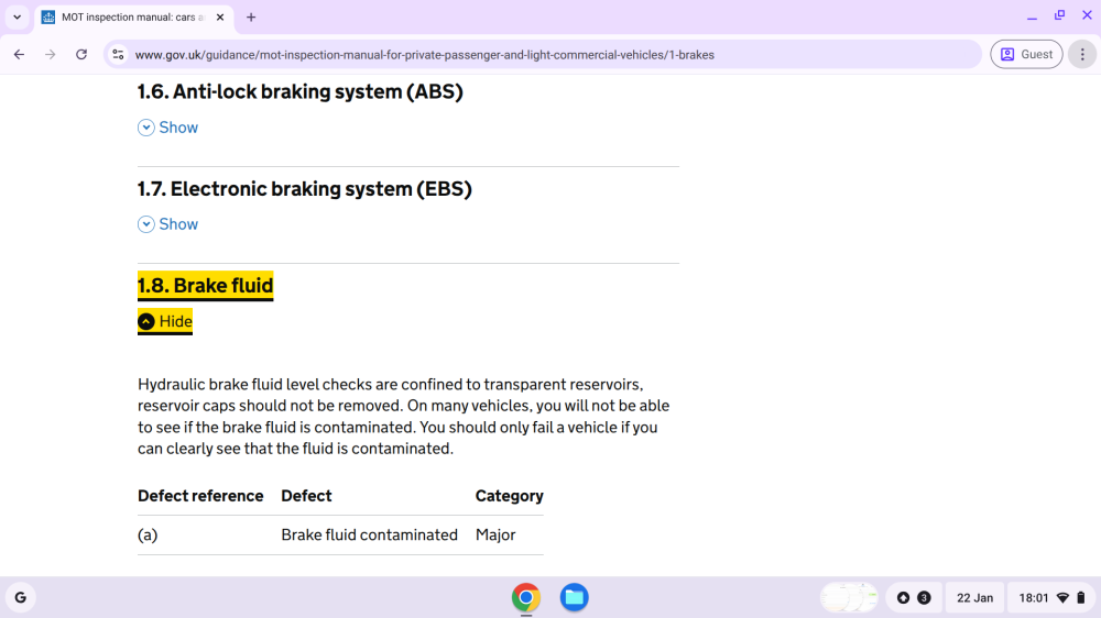

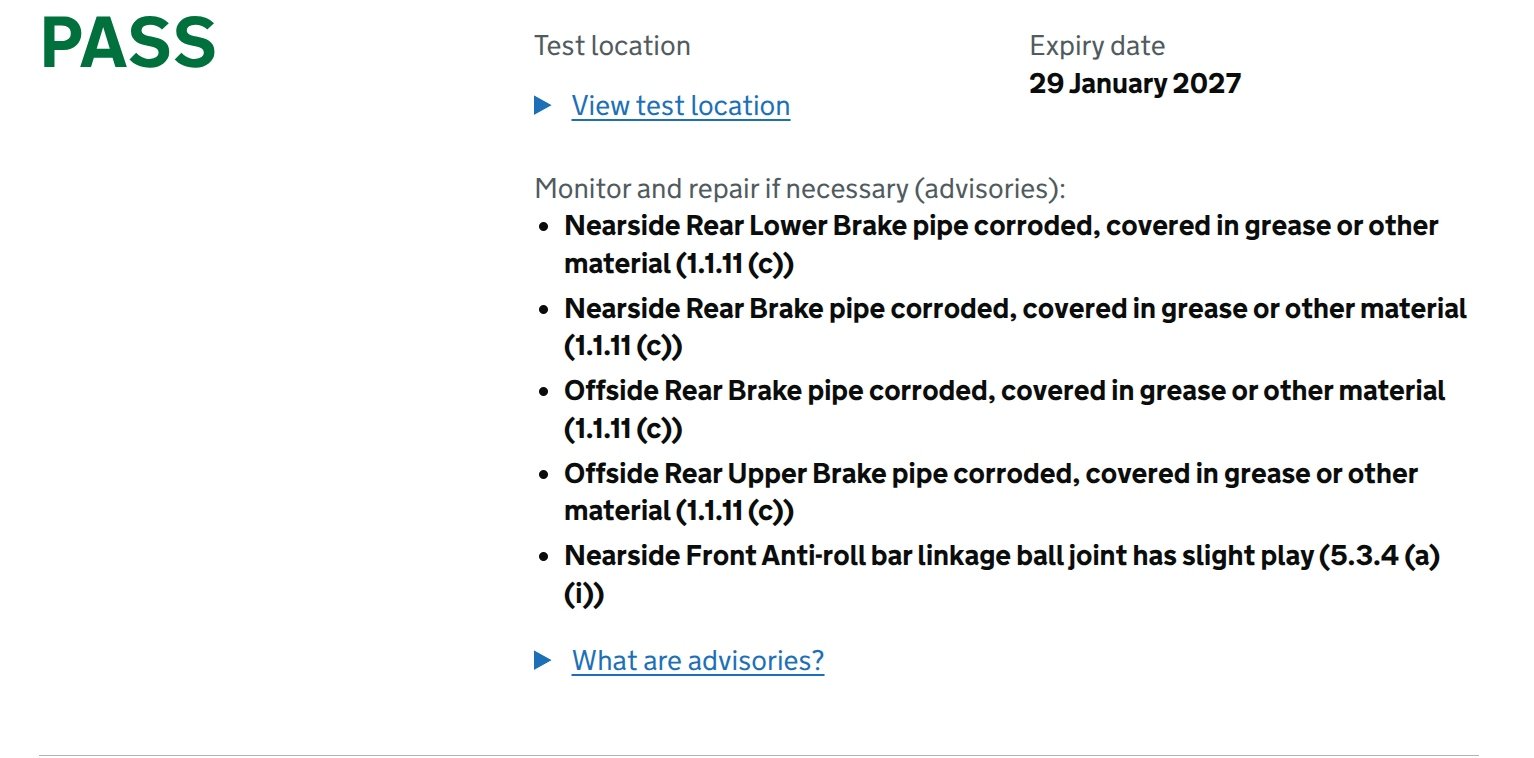

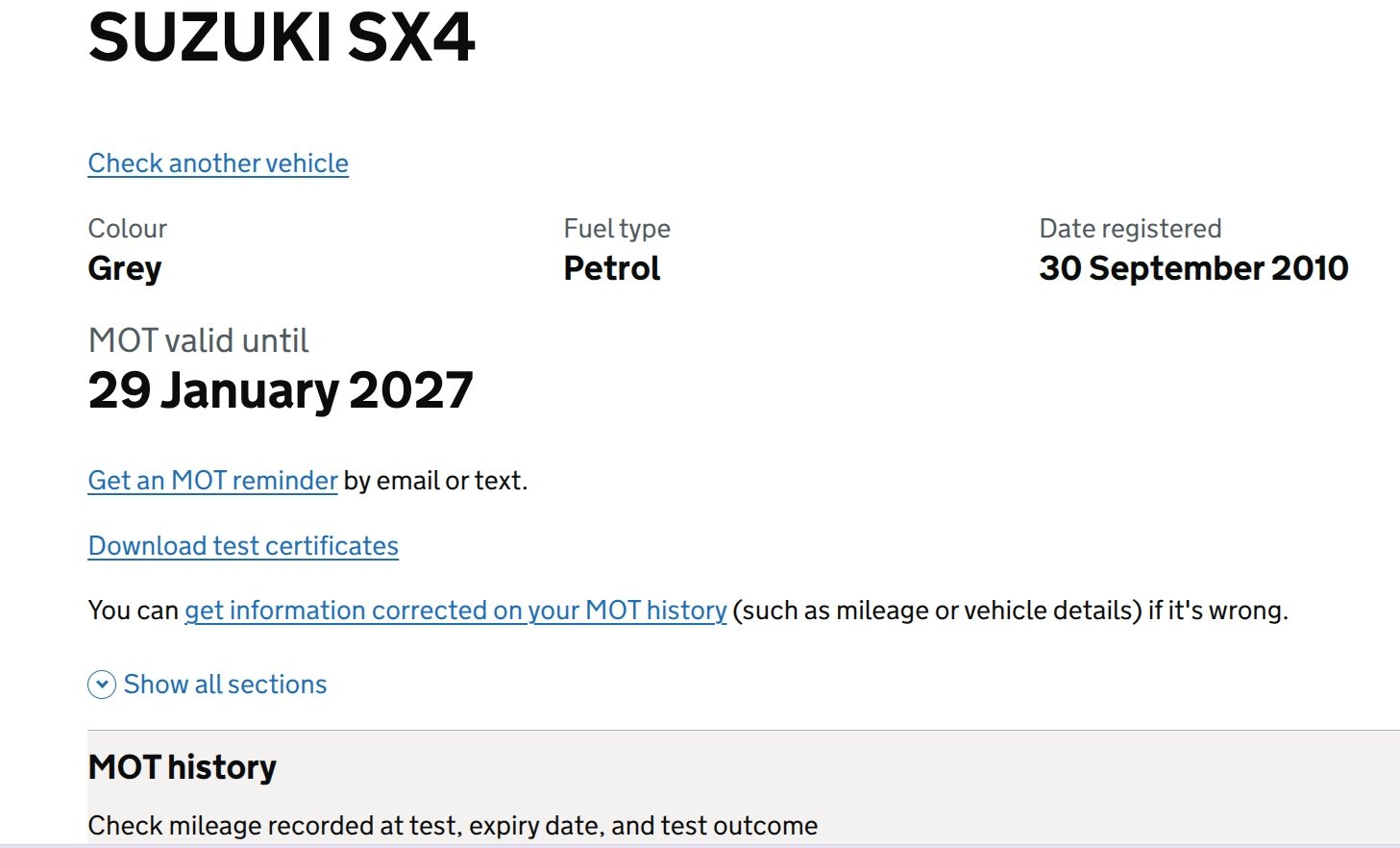

MOT,s in the UK are just so easy to get a Pass.
Edited by Evolution13
The specific code 1.1.11 (c) is technically the failure code for "excessively corroded" pipes. However, the distinction between an advisory and a failure is often a "judgement call" by the inspector based on the following:
1. The "Surface Rust" vs. "Pitting" Rule
  • Advisory: If the corrosion is just surface rust or scale that hasn't eaten into the metal, it is usually recorded as an advisory so you can monitor it.
  • Fail (Major): If the corrosion has caused deep pitting or the pipe's wall thickness is reduced by more than 1/3 (roughly 0.25mm), it must be failed under 1.1.11 (c).
2. Benefit of the Doubt
According to the DVSA MOT Inspection Manual, if a tester is unsure whether the corrosion is severe enough to be a failure, they are instructed to give the benefit of the doubt to the vehicle owner. In these cases, they will pass the car but issue an advisory note.
@Stonekeeper Yes i know. I also know that over the past 8 years has been fails and advisories and which have been there a few years back and not in the years in between.
