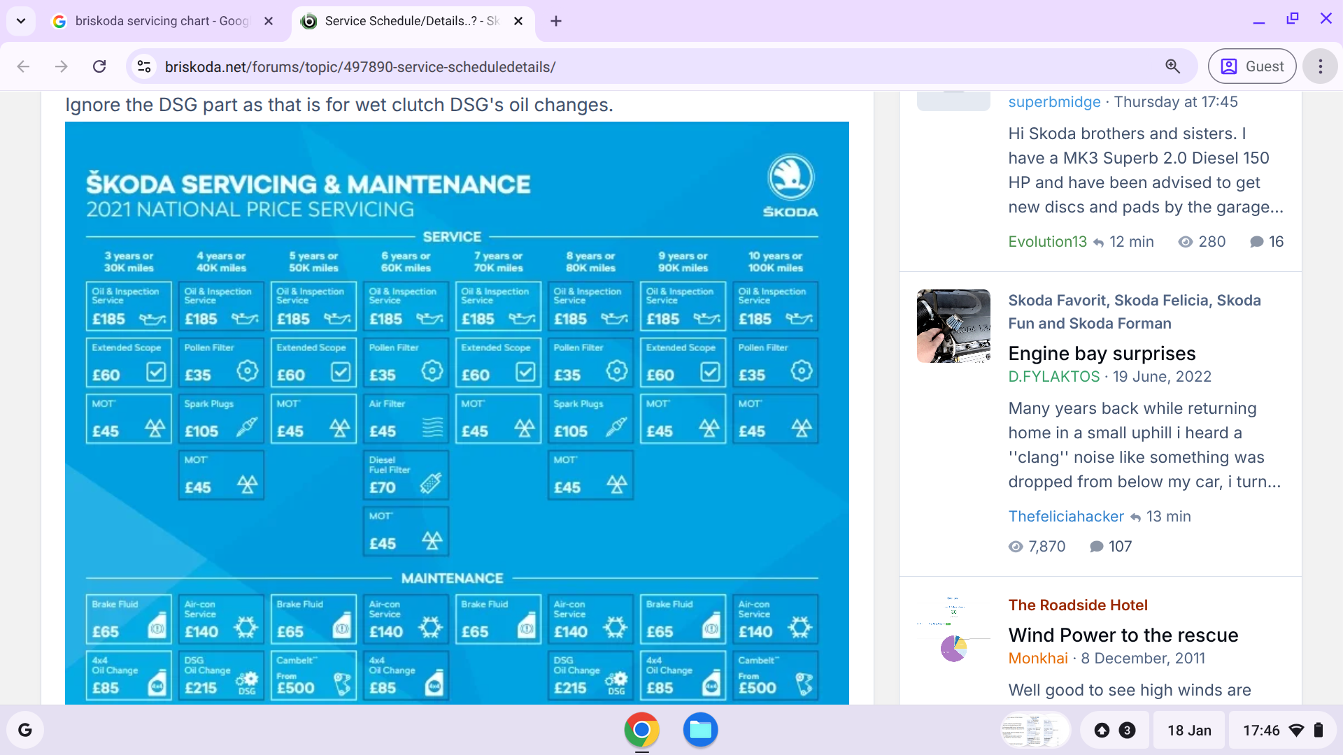

That is what you get with rubbish training of Service Staff at Main Dealerships. On job training from somebody who knows little about cars or servicing and maintenance. I do not change fluid on new cars i have no longer than a few years but with an old / used cars when upgrading brakes the fluid is changed. I have had 15 Motability cars, all got the brake fluid changed before 3 years old and the MOT, before hand back. Part of the Servicing. The last 3 EV,s i have had have had the Brake fluid changed @ 2 years old. Skoda had a chart like this 2018-2021. Not accurate, but gives an idea...

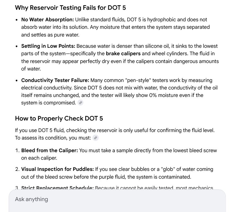

It can be tested for water content
Screenshot 2026-01-18 at 19-18-45 if brake fluid never needs topping up how long will it last - Google Search.png
Edited by Stonekeeper

Next time you check the Brake Fluid for H20 ain the reservoir, also then check the brake fluid you let out at the calipers if bleeding and see if there is the same content. PS Water in brake fluid, maybe never noticed, but driving spirited, sporting, lots of heat in the brake system then that water boils. Sooner than usual even not if ever on a track the XDS / XDS+ will disable its self. Also brake fade. And there is corrosion in brake pipes and calipers.

It has become more important now because of the change of fluids used.
Back in the day, as they say, replacing linings and bleeding the brakes afterwards was probably sufficient to return the fluid to a safe condition.
Nowadays brake linings seem to last longer, especially evs, and water getting in to the system by absorption effects the fluid differently, instead of dilution in dot3 and dot4 it separates out in dot5.
You will probably not notice it's happening until you need your brakes in an emergency or prolonged braking.
Gambling not to service it is a personal choice.
