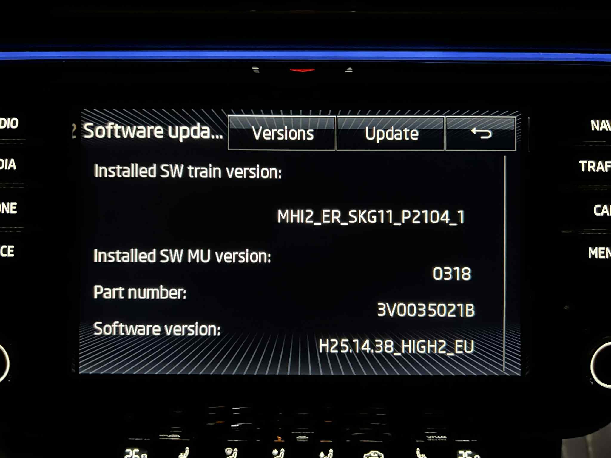

  • Researched about the infotainment system and as far as I understand, Amundsen system is a bit bad as per Bri(skoda) standards and nothing much can be done about.

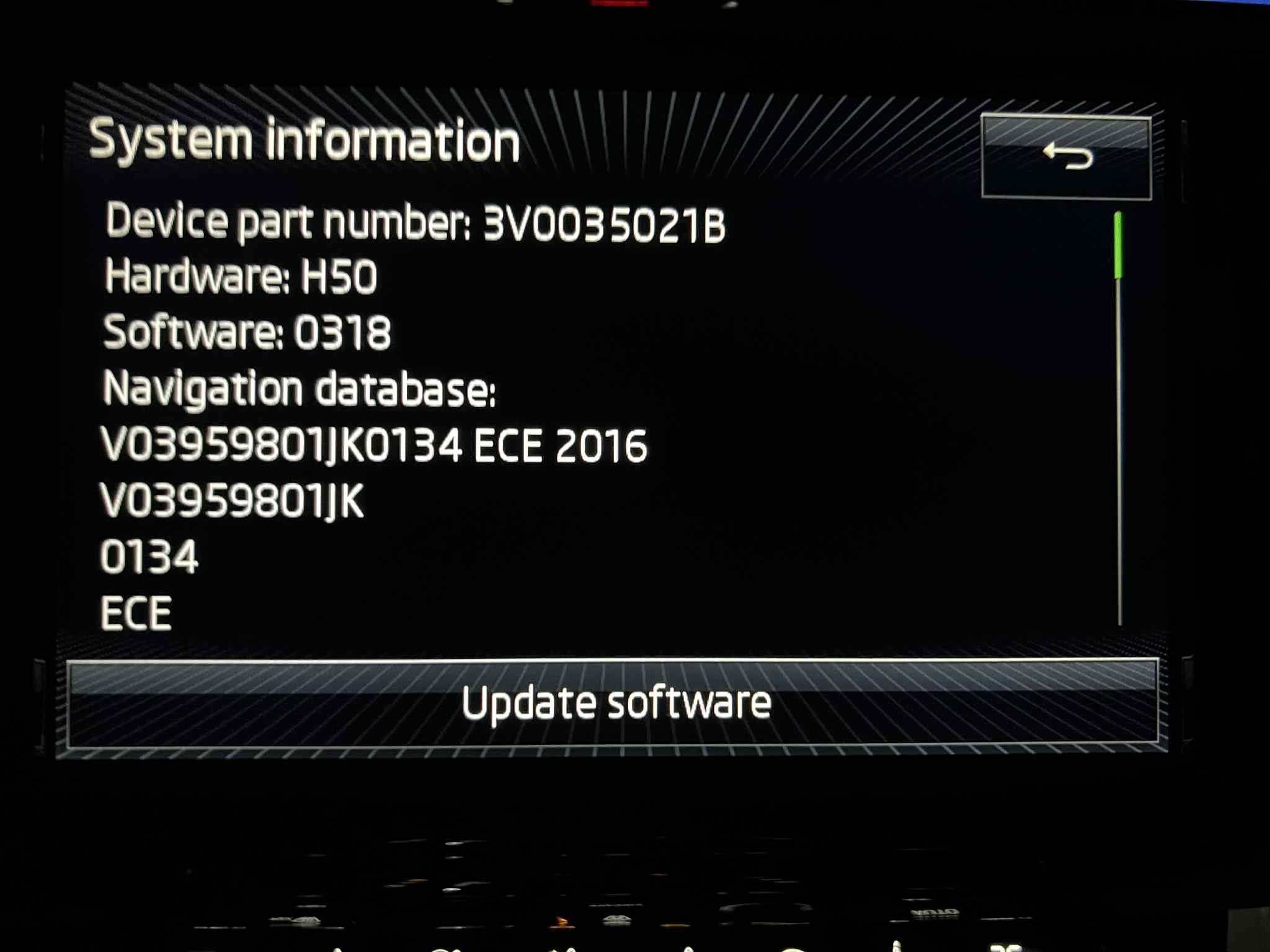

  • Went to - updateportal.skoda-auto.com, and used my VIN to check - it seems I have "ECE 2026" update.

  • Saw that 0330 firmware is available and people use it.
So my question is - can you guys advise me if:
  • My system is up to date? - Given first picture - ECE 2016 - I'd say it was never updated.
  • If I update with ECE 2026 (map update), will it add the new languages or I need to update firmware (menu 10 seconds thing that says 0318) with the files that are floating around.
I have recently updated my headunit, I have the mIB 2.5 version from when it was produced, 2018 to the latest version with no issues. I followed the MIB2 to MIB2.5 upgrade doc which was done by @JR RS
You have correct link for the map update, I went there and did mine from 2018 to 2025/26
