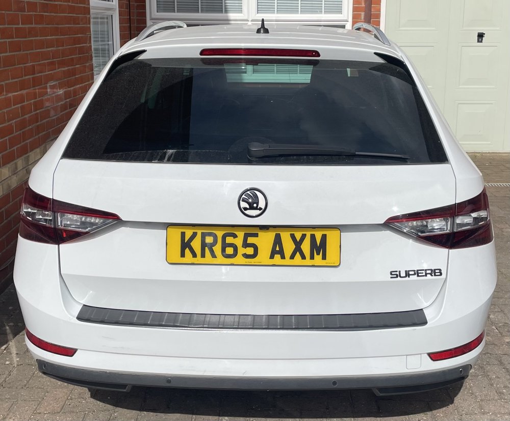

Tackled some of the easier of the dechrome tasks today.
Now need to take front bumper off to fit the grill surround and lower grill strip, fit roof bars and wrap window chrome.

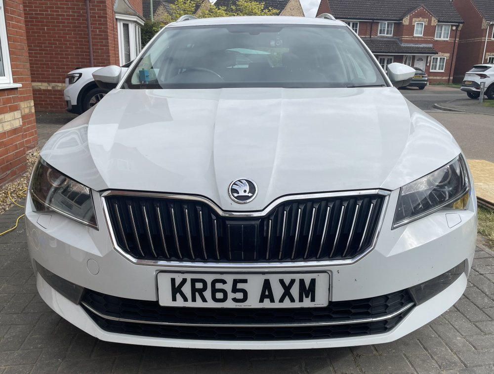

    Now fitted on the car and much better clean look I was after.

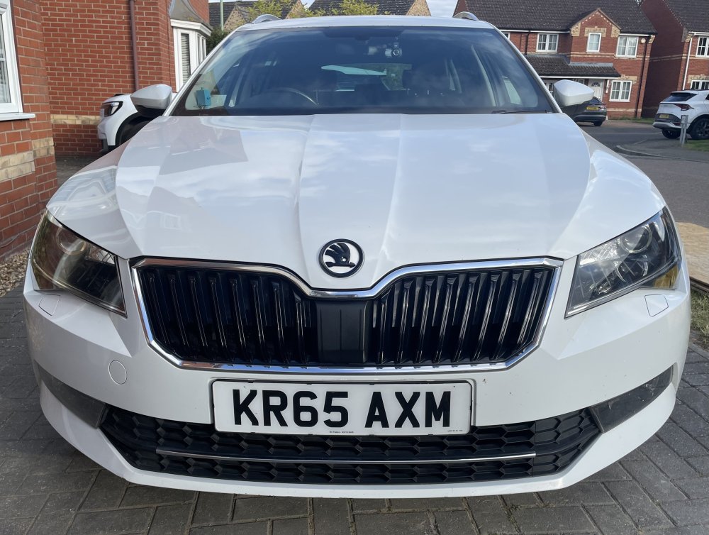

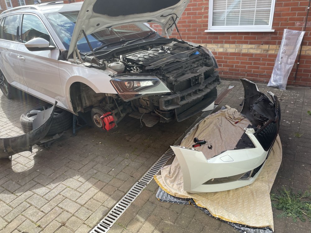

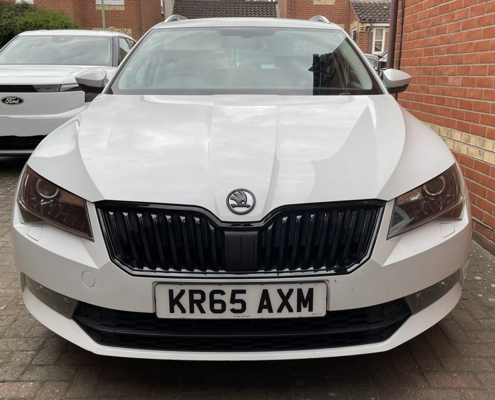

Finished off the front grill today.
Bumper off job. Once again a big thanks to @JR RS for a brilliant how to guide.
https://www.briskoda.net/forums/topic/469985-front-bumper-removal/#findComment-5277204
Lots and lots of Torx screws and fiddly clips but it wasn’t too bad a job in the end.
Really like the look now it’s all done!

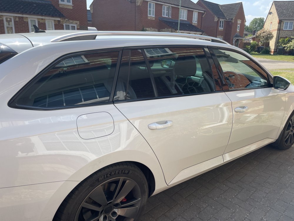

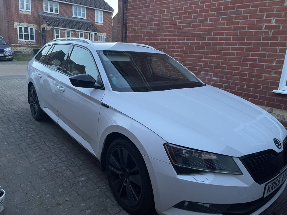

Just the side view left to dechrome with wrap around the windows and the roof rails to install

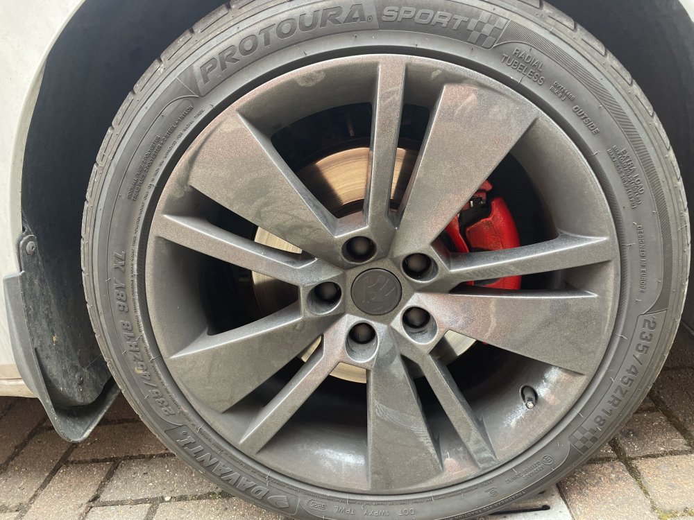

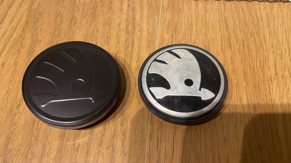

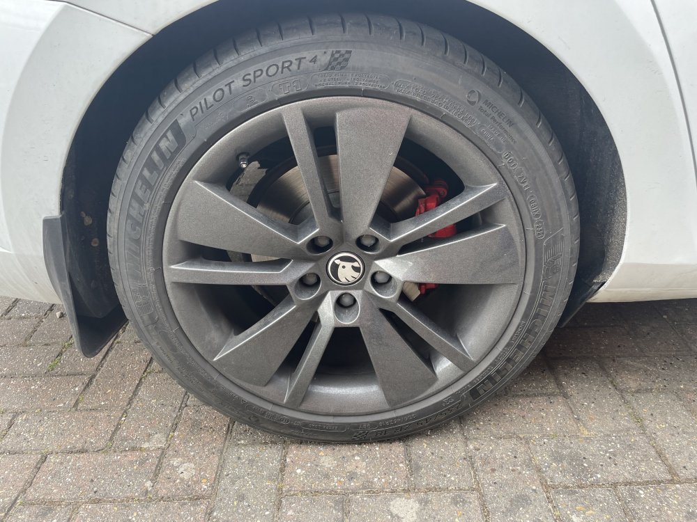

Fitted new black ŠKODA centre caps today. Didn’t look right with the slightly pale grey but caps so got some Matt black nut caps to match.
The centre caps are slightly larger and stand slightly proud compared to OEM but I like the cleaner non-chrome (and non corroded!) look.

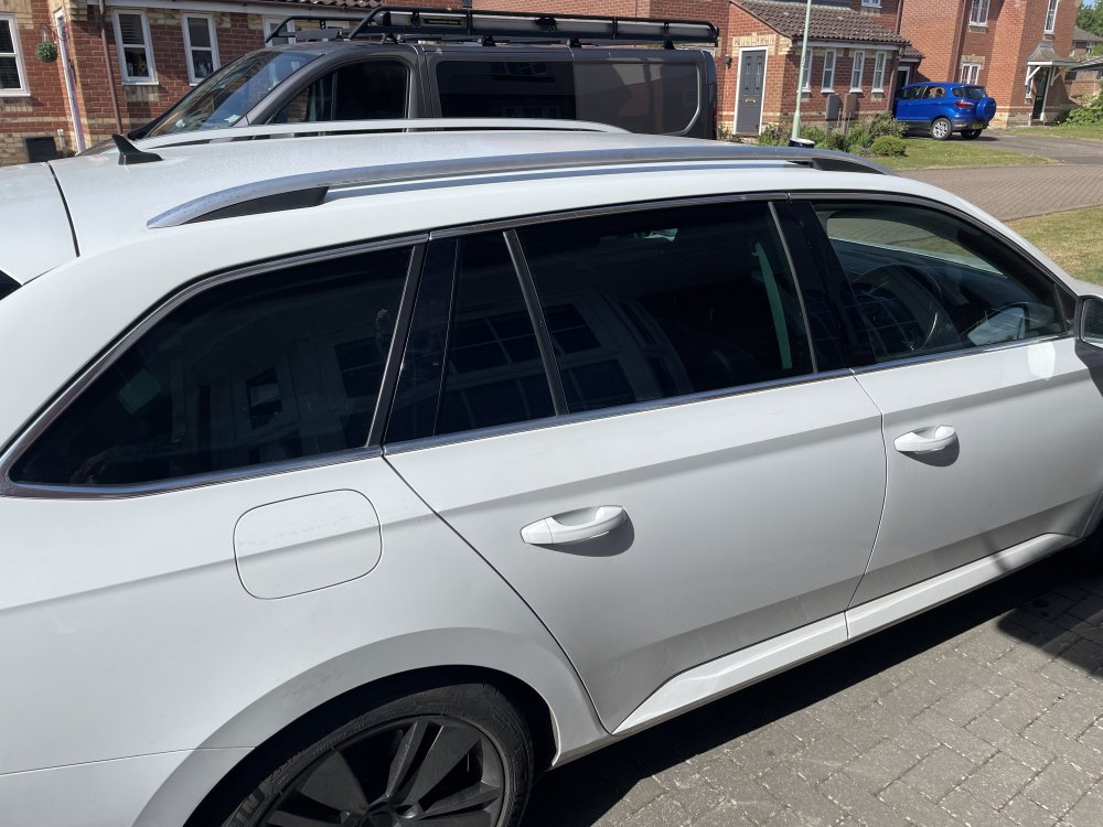

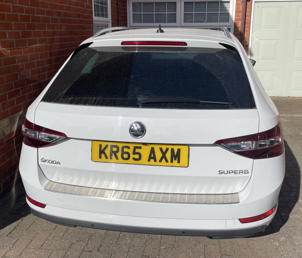

A nice bit of morning sunshine and no plans with the family meant I could finally finish wrapping the passenger side chrome strip. The rear quarter light has some dings on the chrome from an unknown event with the previous owner so that took about 4 failed attempts to get right. Eventually got it looking good enough with the only tiny crease of the whole project.
It looks great from a distance, just don’t look too closely! As I say with a lot of my projects “Stevie Wonder would be pleased to see it”
Just the roof rails to swap out and then the full dechrome is complete. They require a guaranteed dry day so may be some time before I attempt that!

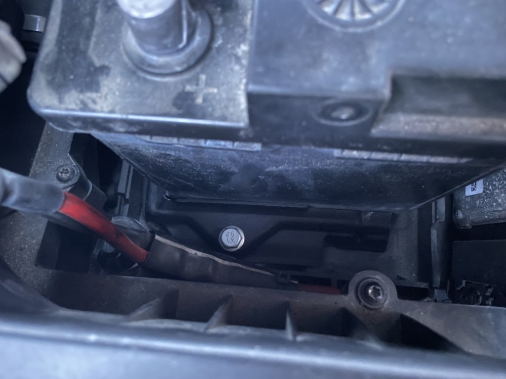

In the process of checking things under the bonnet I discovered the battery was not actually clamped down and had slid out from under the catches on the battery tray. No UK stock for the spare from OEM and Amazon was a long lead time too. So I thought an OEM- one from Ali express would suffice.

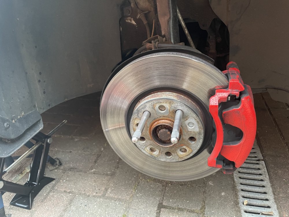

Also picked up new front discs and pads to try and finally solve the brake shudder.

AliExpress delivery day today for a few more upgrades.
First off - battery clamp that I found was missing. Nice easy fit.
https://a.aliexpress.com/_EvpbmXk

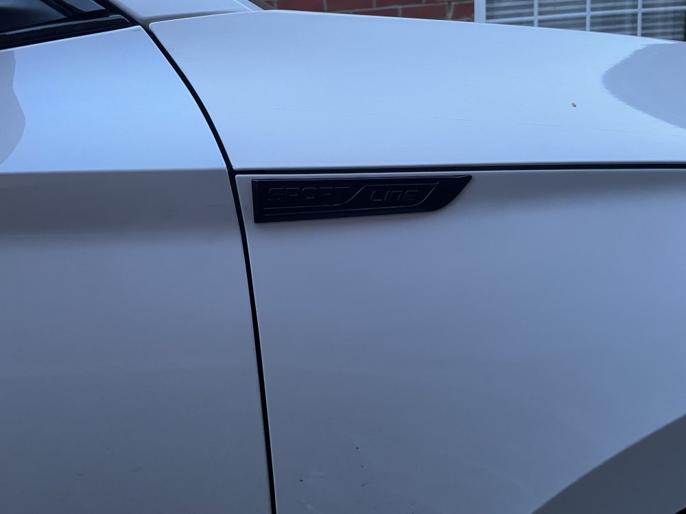

Black Sportline badges (not the best photo as it was getting dark)
https://a.aliexpress.com/_Ey0q3ro
Black mirror caps
https://a.aliexpress.com/_EyOVXV4

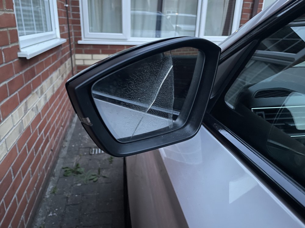

Again a relatively easy fit. Although the glass takes quite a bit of force to remove. As @JR RS found, the Chinese copies have the middle fixing tab in the wrong place. But secure well using the two side catches.
Unfortunately the passenger side didn’t go so well….
I was shocked at the price of the auto dimming glass. £300+! So I shall squint into a £25 non dimming version in future.

New (non dimming) mirror glass installed this evening. It doesn’t have the clip for the dimming wiring plug so I had to tuck it away. Initially it fouled the swivel movement so had to very carefully take the glass off again and tuck it away a bit neater.
