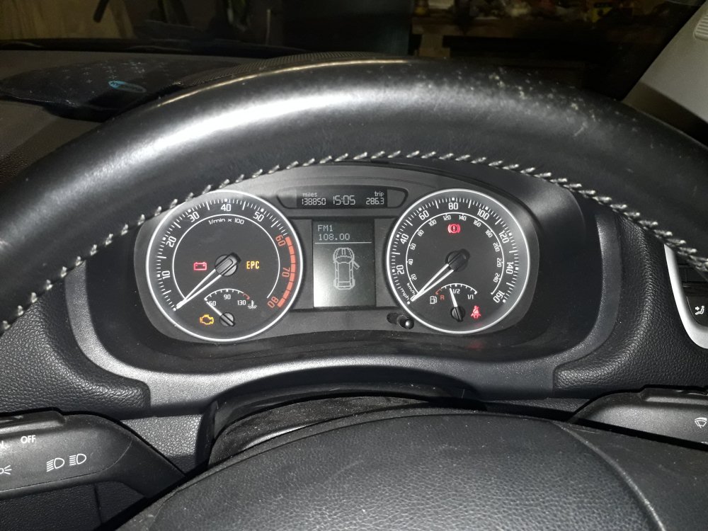

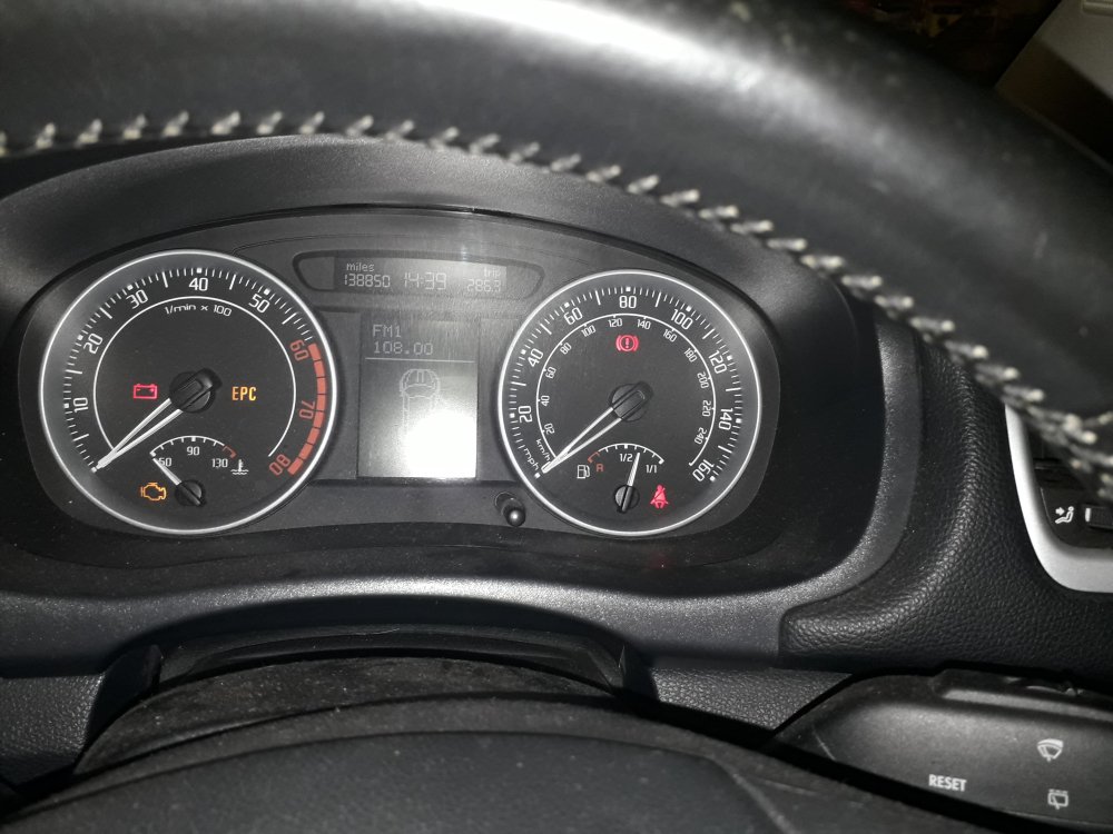

I took pictures...
Reverse display
Correct display
As you can see on the clock they are 30 minutes apart.
The BCMs have the exact same PN and nearly the same age. The biggest difference is that the BCM I bought as a replacement for the failed one came from a VW Fox from 2009, so the same year as my daughter's FII.

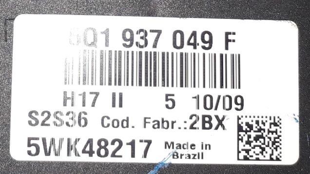

Is there a date code on the Fox BCM? There's a different document of info either side of August 2009.

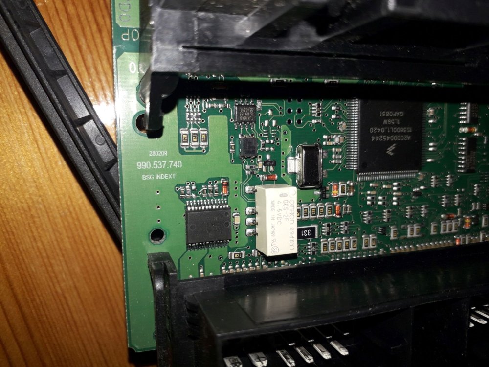

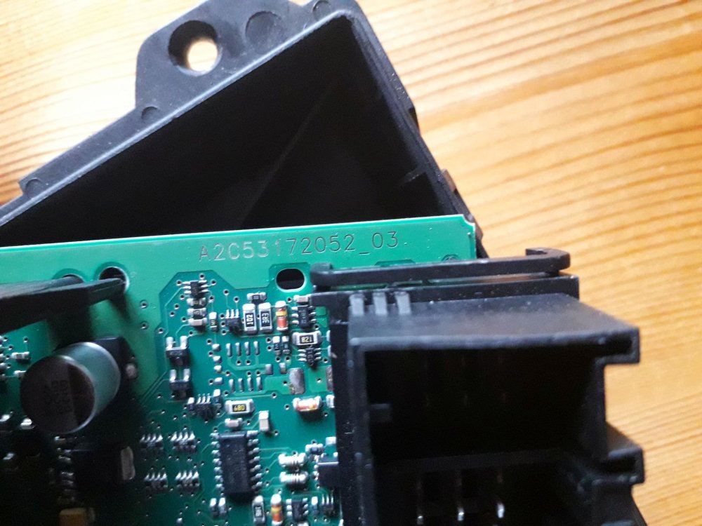

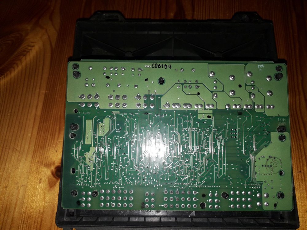

Hi,
I will attach some pictures of the VW BCM.
I cannot compare this at present because the old BCM is still in the car until another replacement arrives.
