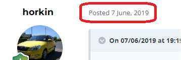

Each post has a date above it as shown below:, it's always worth checking:

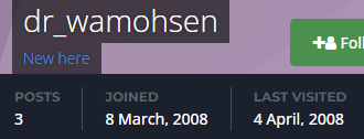

If it is an old post, then it's worth clicking on the users name which will give you some useful info:
