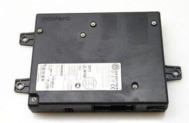

Can anyone confirm what is the correct part number of the bluetooth unit I need as a replacement for the one in my 2009 Superb Elegance (with the Columbus head unit) in order for it to work with iPhone 5S ?
I'm sure this is the one you need
http://pages.ebay.com/link/?nav=item.view&id=271473907930&alt=web
The link doesn't seem to work, but stick this part number into eBay
 3C8035730D
Hi, I'm wondering the same thing:(
I just bought a 2009 elegance with a columbus unit. my iPhone 5S won't connect. I need to understand all this talk of RSAP and HPP??? or why the iPhone has a problem in connecting? In the other posts here people talk about a unit you can buy on eBay to simply swop out to all the iPhone to connect. Did you get to the bottom of this yet? thanks, John.
  • 2 months later...

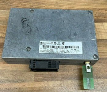

Hi there, I can supply the correct bluetooth unit, which would work with Iphone and all new phones. Straight swap with your old unit.
Hi Guys,
FYI, I eventually took the plunge and bought this , NEW 2015 VW SKODA SEAT BLUETOOTH WI-FI HOT SPOT MODULE 3C8035730E.
It works perfectly.
The eBay seller I bought from is maeik-maeik and it was a great experience. No issues. The box simply plugs in under the seat, Job done. No programming, etc. hope this helps,

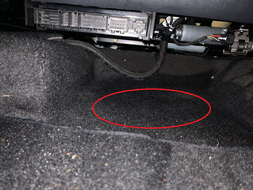

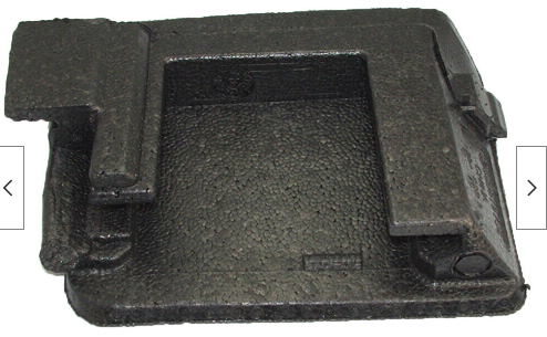

Lets start with some basics. Your profile states you have a 2002 Polo but that very much looks like an early MK2 Octavia. What have you actually tried to do, stating "The phones don’t pick up the stereo" isn't super informative or useful.
As standard, that age of Bolero doesn't include BT. Instead, it uses a separate module that's normally fitted under the front passenger seat. Please can you check for such a module and add a picture of the label.
