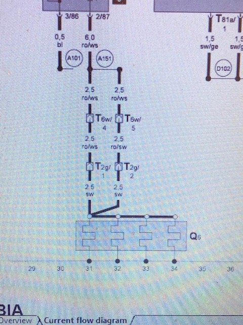

Glow plug wiring harness
Well that doesn't sound like you have the correct part then, if the one on the car has 2 wires but your replacement has 4 ???
