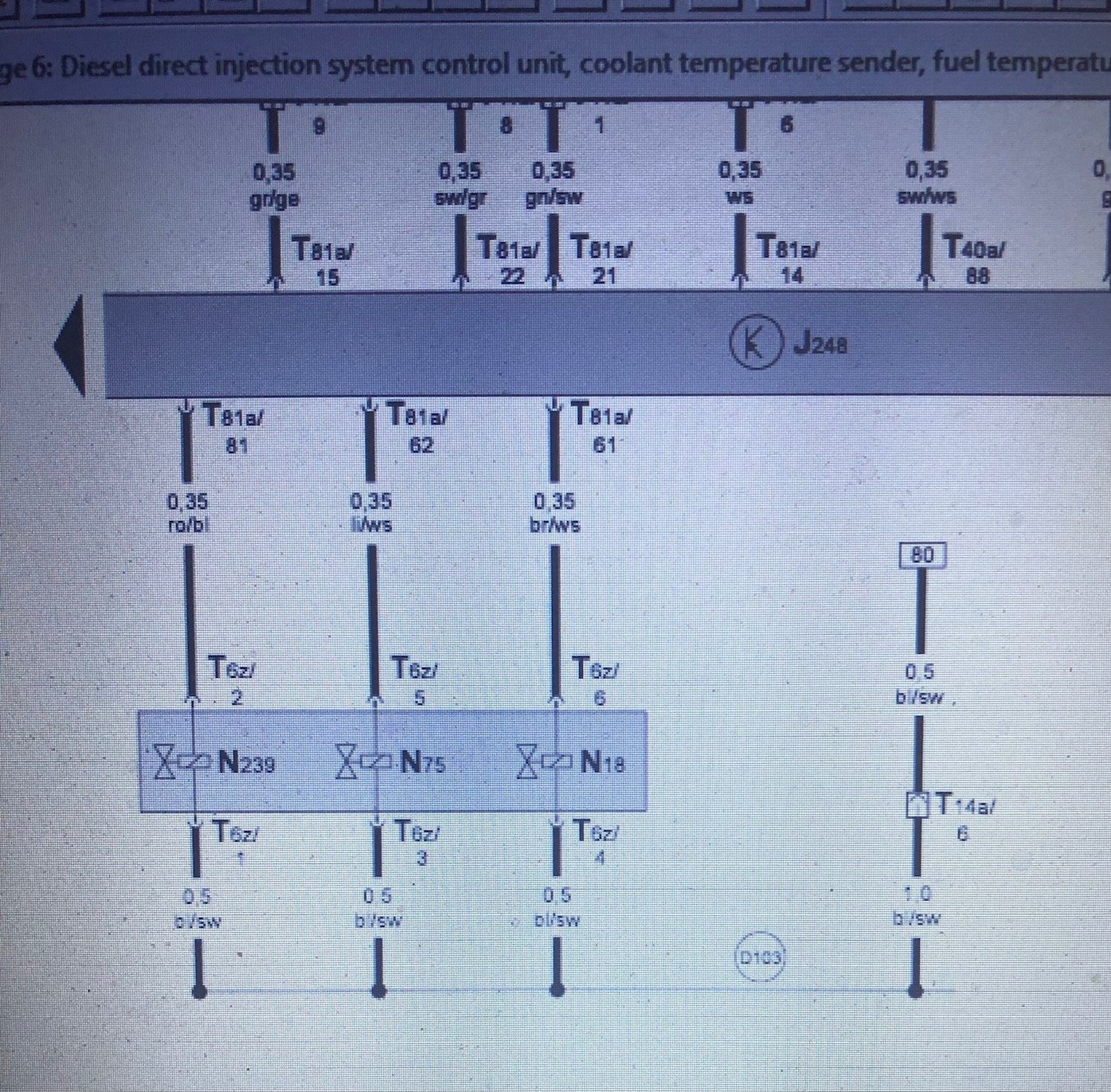

1.9 TDI running on pump noise when ign off
This is the connections to the vacuum distribution box N239 Variable intake manifold flap change over valve N75 Charge pressure control solenoid valve N18 EGR valve On engine shut down the N239 will be commanded to close, if that valve is clogged up with carbon deposits it might be taking longer to close and that's why you can hear the valve pulsating trying to close the valve
That is the vacuum distribution box there are only solenoid valves inside no motors
