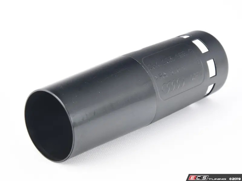

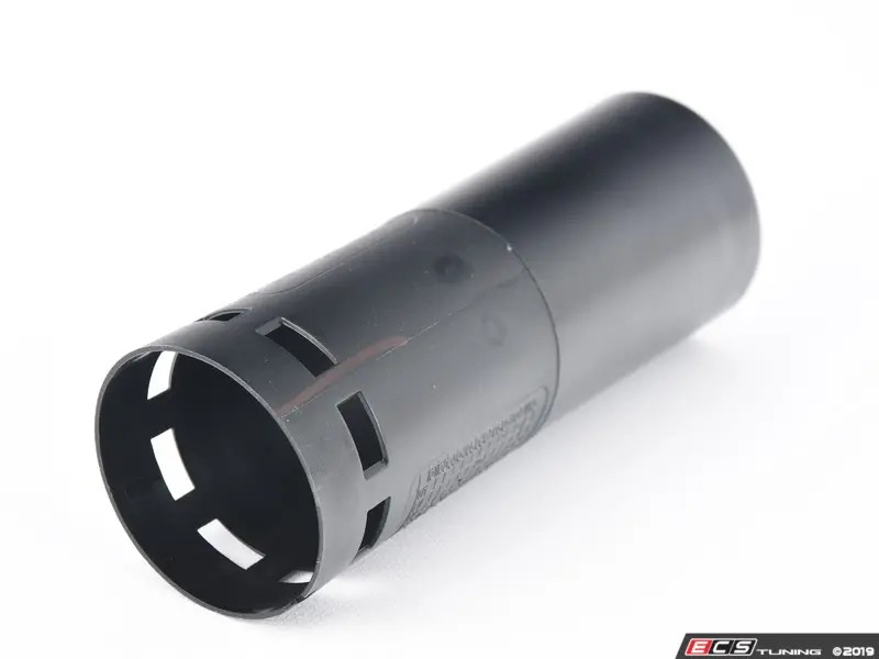

  12. There are cooling jets underneath each piston close to the crank and aligned to centre of each piston . Not sure if the closest one, could reach the balance shaft recess - only if the recess is not fully closed and has an open gallery area to the crank area below. Looked at the VW Self Study Guide which has some good diagrams of oil supply and return schematics and of the balance shafts and chain and tensioner but doesn't show or touch on the plastic tube.... Spent a bit more time looking at other videos this morning, got no further really. On the gen 2, there is quite a few balance shaft seizes out there on golf GTis and the like. All that I saw videos on - are on the exhaust side. On the gen 2, on the bs it doesn't seem that they ran the needle roller bearings now present in the gen3, but they still had a plastic tube on the exhaust balance shaft.... One of the videos I saw, with a siezed balance shaft, had damaged the plastic sleeve melted and distorted, from heat due to a strainer oil intake mesh on the balance shaft being partly blocked. Assuming that is the correct order of events. It's one hypothesis. It hadn't full broken apart though - the tube on that video it, the engine seized solid after a dyno run. And for the plastic parts that size to get to the bottom of engine like in this case, maybe there is a void or big return gallery in that exhaust balance shaft recess open to bottom of engine.... The debris can't come out the front of the balance shaft its bolted - to block. The debris size couldn't travel by fine oil galleries.. One worry I'd have is that the plasitc tube has failed due to excessive heat - due to a starved bearing on the balance shaft which could present a balance shaft failure risk without addressing.. The other, is whether that sleeve is directing oil or retaining oil in a particular way to ensure reliable operation of the balance shaft. Admittedly, it is expensive to address any of this and it seems to be running well for time being, so is it worth it on a fairly high mile vehicle.... It's all got a bit over my pay grade. And my head hurts now. I may post a comment on one of the gen 2 video failures I've seen and ask what they see the plastic tube purpose as...... see if I get a bite...
  13. Not sure I haven't seen that. I doubt it tho. He goes by the brand name humble mechanic in the US of A. His first name is Charles. He is mates with Paul Barrett from Shop DAP.com (US vw part retailer). He's done hundreds of videos (now pretty much exclusively youtube I think) on VW parts, failed parts, tear downs, fixes, mods. Some of them with Paul. They're both ex vw techs. Not the best photo but it is what came up.. Paul Left - Charles right with ZZ top beard.
  14. A bit of investigation and/or research into the purpose of that liner may help. I can't imagine the designers thought why not, we've got a big recess in here, so let's add in a plastic liner for the he'll of it... Someone who's actually dealt with balance shaft removal / renewal on one of these engines would be able to comment better than me. Say a vw specialist garage or vw / edit skoda worksop but you'll always be talking to a front line advisor there, certainly initially until strip down or investigation anyways. The bearing is at the back, so the bs is not riding on that plastic sleeve as such. Maybe it's a oil deflection or oil direction / edit retention sleeve to stop oil ON the shaft of the balance shafts (which are not round, flanged) getting thrown about at high velocity. The balance shafts run at double engine speed I believe. So 5k engine speed is 10k shaft speed. Good luck. Yes, do report back..
  15. im wrong about 2 x liners. There’s 1no liner on the exhaust balance shaft. No liner on intake. But there are 2 x balance shafts and given mileage and problem of plastic sleeve break up they both may need inspecting, cleaning, maybe replacing. That said the intake looks like a pain. versa. Yeah. He’s a good guy Charles, I have watched and used heaps of his vids on gen 2 and gen 3 ea888s. The tear down video I saw, linked below is of the gen 2, the predecessor to what’s in your car but there is a lot of similarity given the shared family. I think the sleeve breaks up. Then finds it’s way out. Not sure how through block galleries. Why, I don’t know. Brittle maybe or catches. Not sure at all. Those balance shafts will need checking and the strainers at least. If that’s all you will have got off lightly. balance shafts at about 7:30 duration. https://www.google.co.uk/search?q=vw+golf+mk7+balance+shaft+tube+broken+up&ie=UTF-8&oe=UTF-8&hl=en-gb&client=safari#fpstate=ive&vld=cid:f70bfe40,vid:OQfdq4V6A-8
  16. Yeah. I think it's timing chain work ++ some more. There is 2 of those liners, for 2 x balance shafts, so the other's going to be needed replacing as well along with all the other timing gubbins whilst your in there.. doesn't sound cheap I'm afraid. If the rest of the engine is sound I guess it will be someway cheaper than a new engine.
  17. Just rewatched a humble mechanic 2.0tsi tear down video. I knew in the back of my mind I'd seen some plastic toilet roll holder in there somewhere!
  18. https://www.ecstuning.com/b-genuine-volkswagen-audi-parts/tube/06k103199a/
  19. Oh I see. Didn't notice names with you not being the op in on the other thread. Yep. It really does not look like a guide or rail. Much chunkier plastic. Not thin. And although curved in places not cylindrical!!
