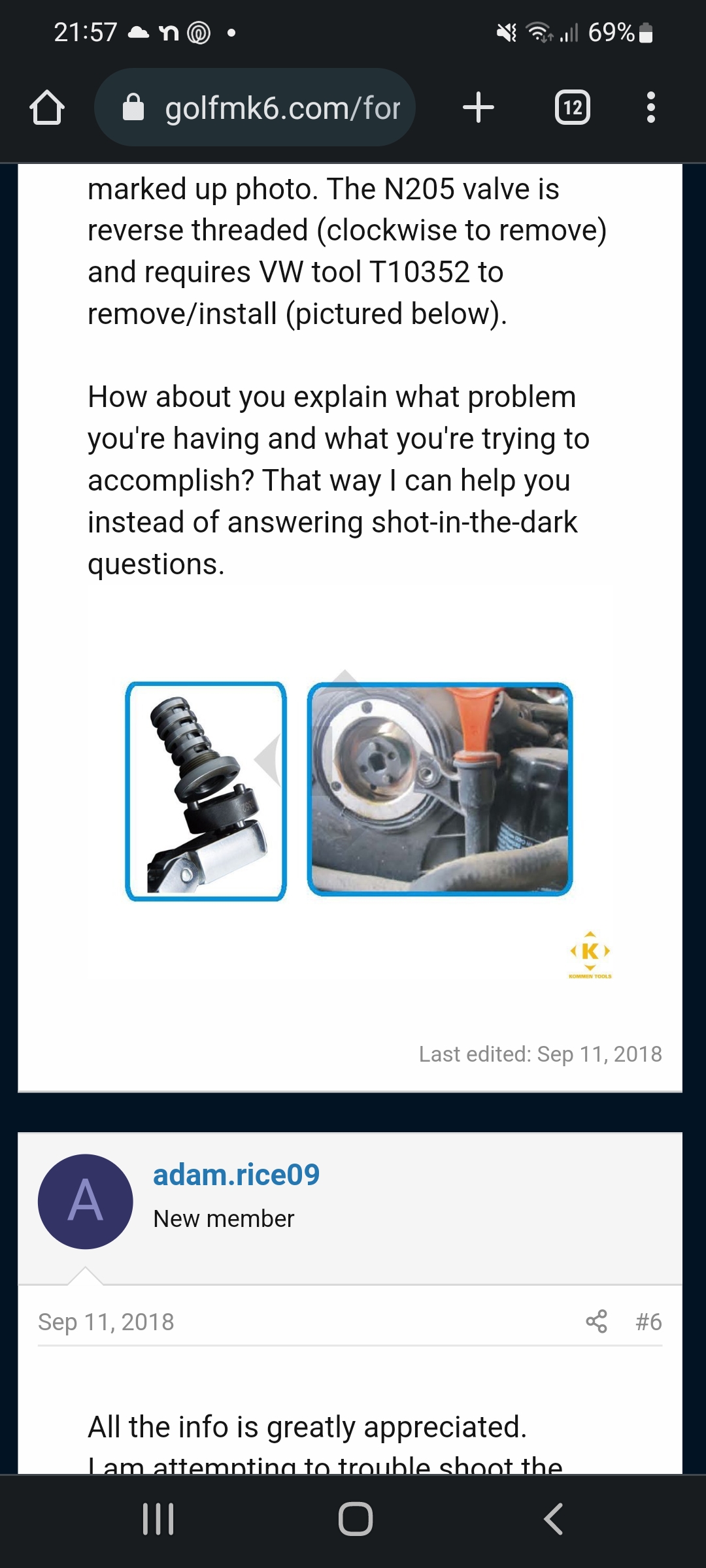

  16. If you can't press in the button on the valve then it must be frozen stuck and faulty. You should be able to remove the valve with a variant of the t10352 vw tool. I don't guarantee that is the right variant but this article says so. There'd a t10352/1 /1a /2 etc. You ger the idea. Note: reverse thread on valve thread!!! This is assuming the engine is a Ea888 gen 2. The tool should fit in the magnet aperture and the valve should be removable through the same aperture without taking off the upper timing cover. Nb. Unless I'm rembering incorrectly, always possible, the upper cover camtiming cover be removed though without engine mounts being taken off. Bottom on definitely requires engine mount off.
