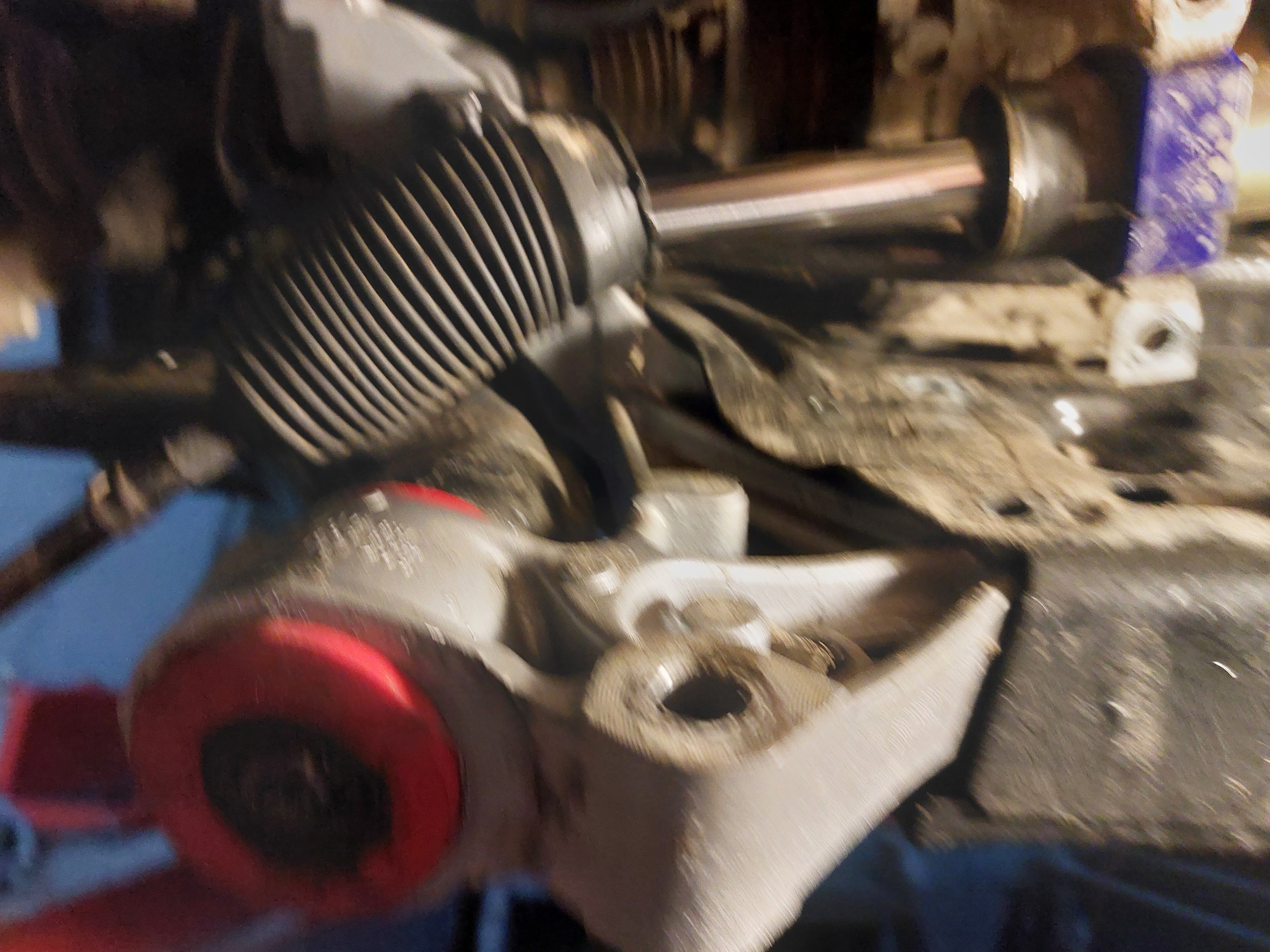

I was a bit worried about those superpro bushes, didn't want to gamble on taking the car apart only to find they needed to be pressed into my old bushes. So I bought new Wishbones. Approx £25 each, including bushes and ball joints. Used a vice to press the old bushes out, and the superpro ones in. These bushes being offset need to be clocked so the hole is near the inside of the car. Fully assembled. Painted them hammered black, ready to go into the car next day. Choosing to keep the front wishbone rubber, as its a solid bush it doesn't make a bit of difference if I keep it rubber or switch to Poly. Also, Made a start on some new engine mounts. This time however I'm using proper polyurethane instead of tigerseal. Gutted an old engine side Hydroil mount, gave it a deep clean and paint ready to be filled next day. Also did a dogbone mount, came off the 1.2l petrol fabia I got the subframe for the mk1 from a while back. Filled this with 70 shore hardness stuff, spilled quite a bit because I hadn't sealed it properly to the cardboard. Debating whether or not to use 60 shore stuff on the hydroil mount. This dogbone will go onto the Monte, I have a powerflex bush in it now, but it is a 65 shore one and I want one that's just a bit firmer. Made a bit of a mess but otherwise went OK.

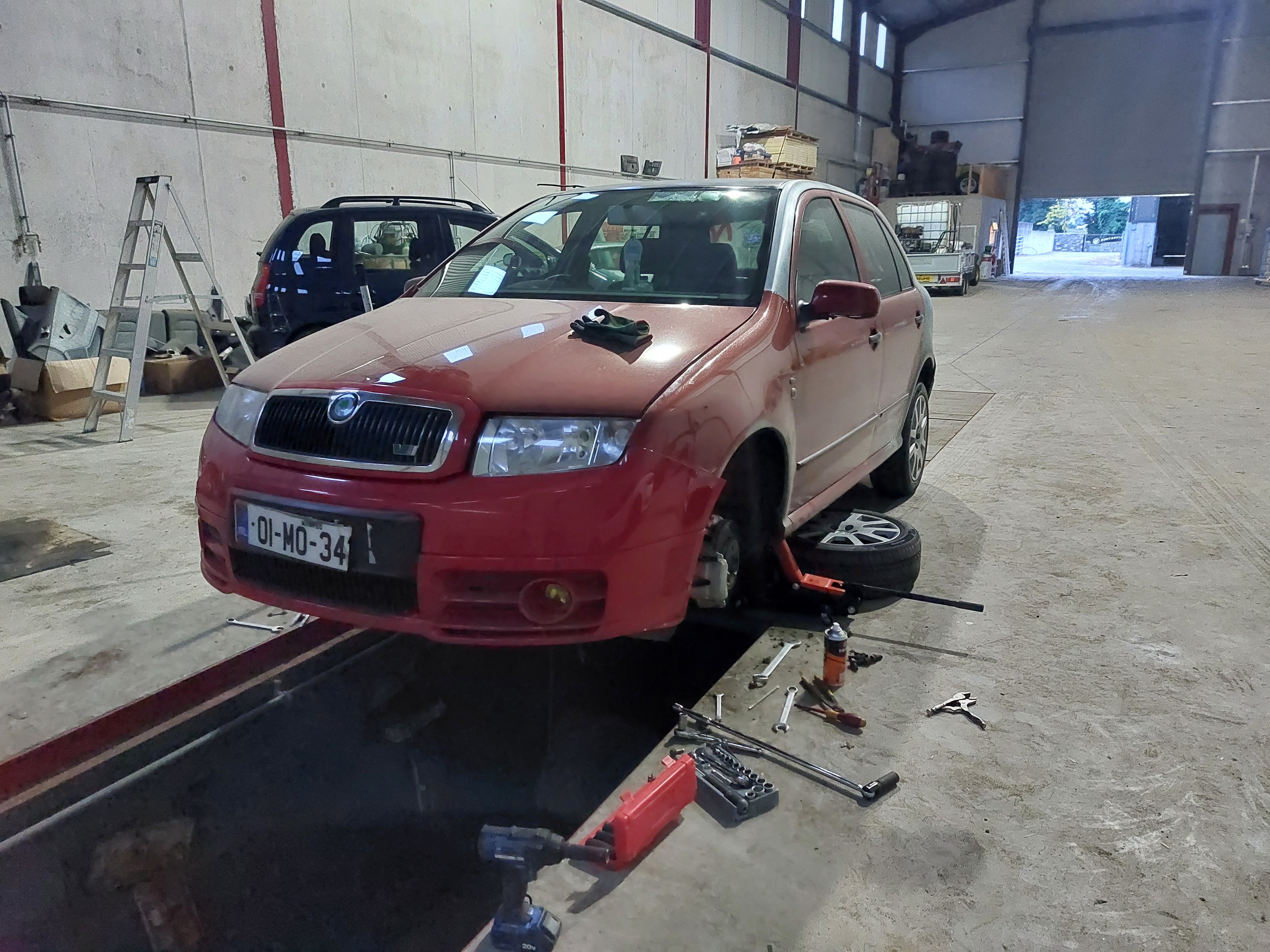

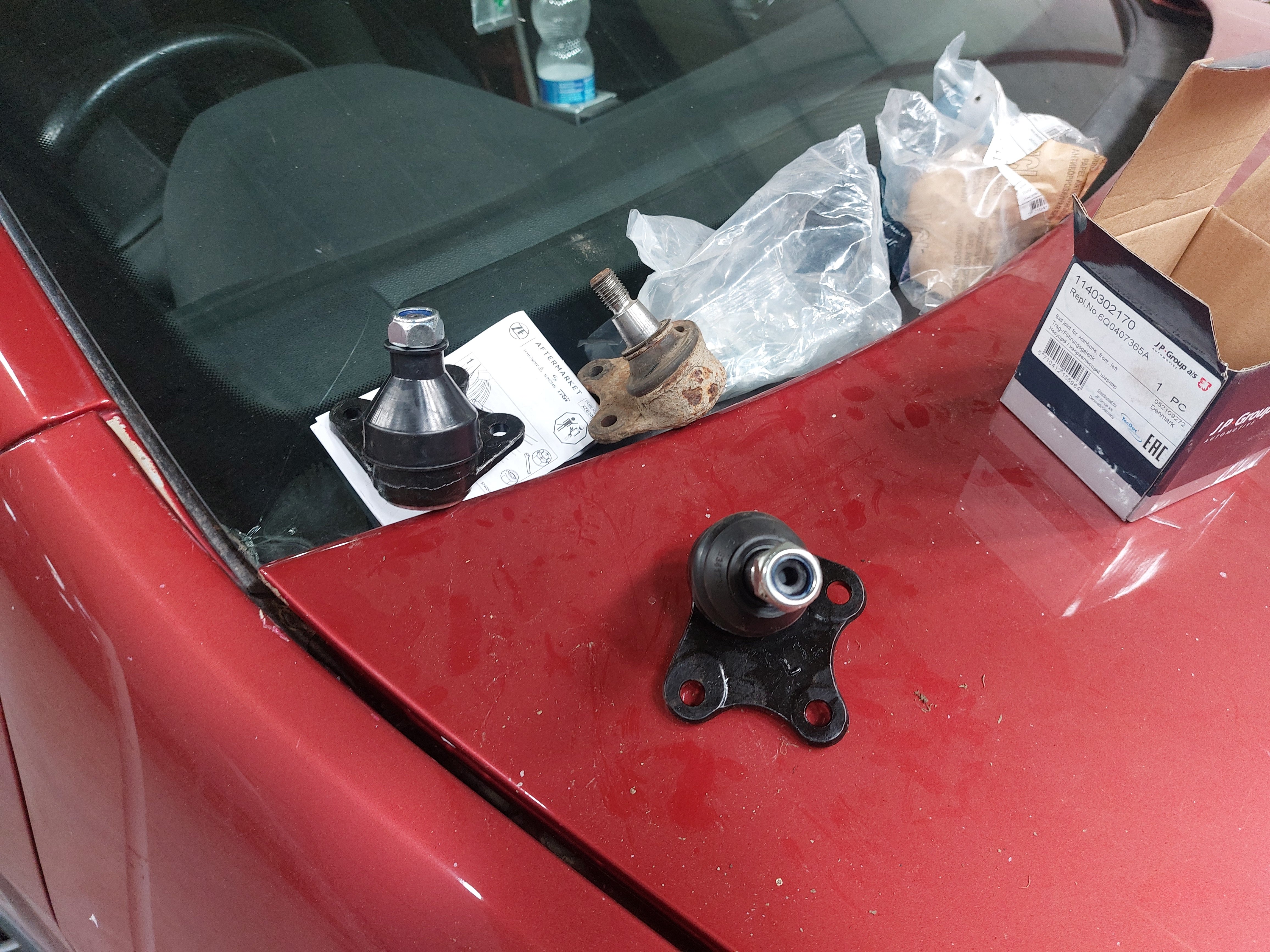

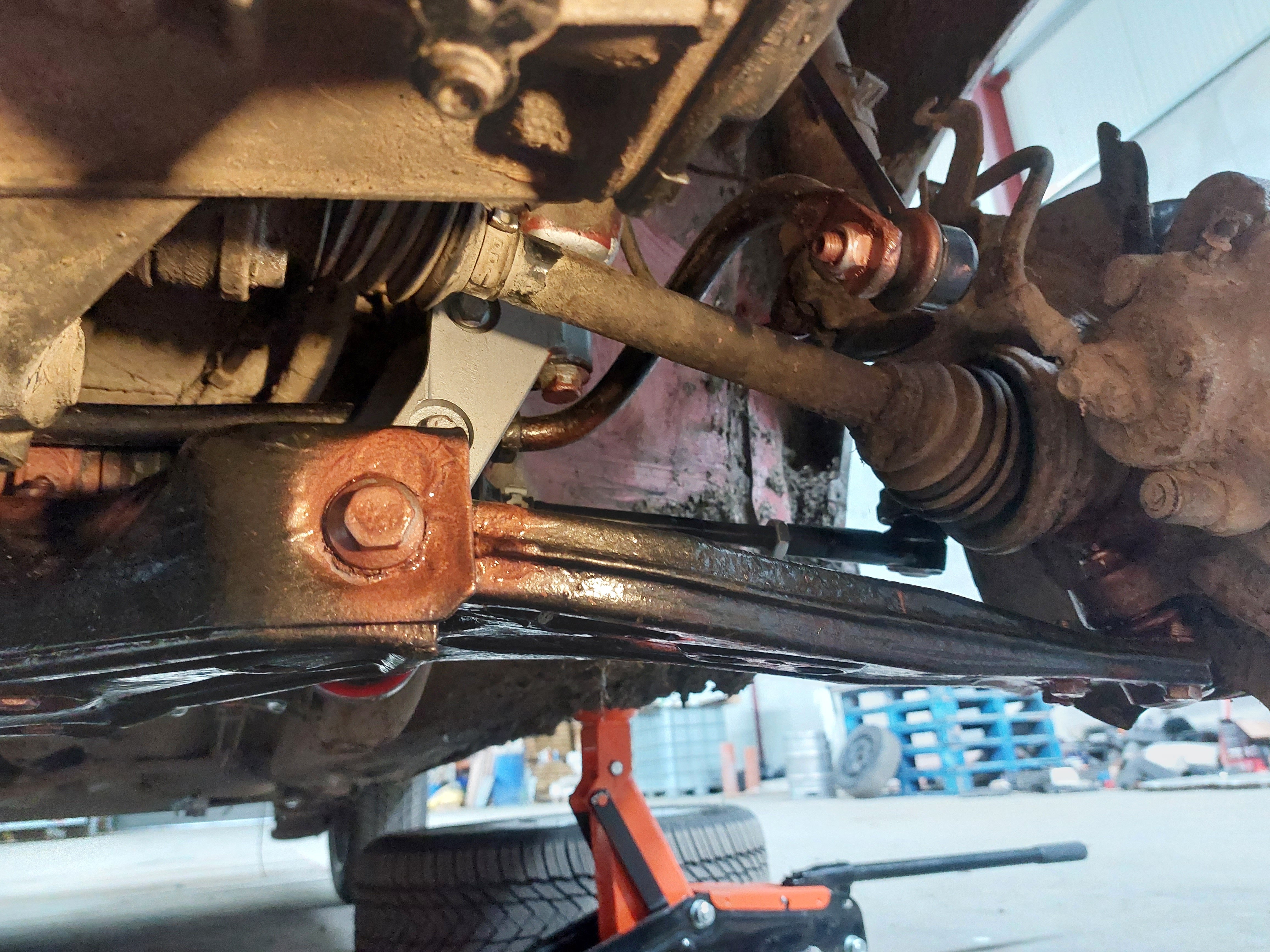

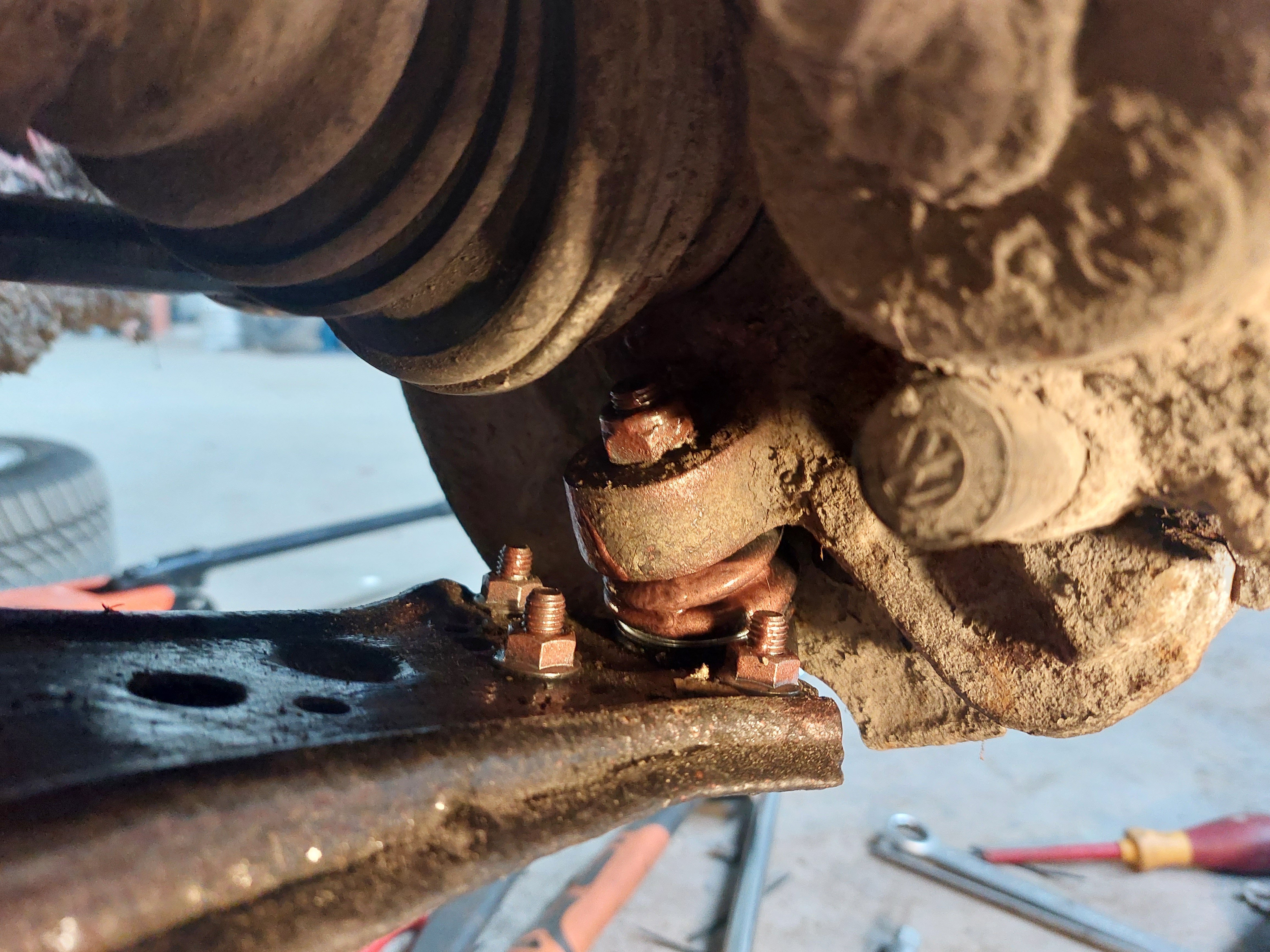

All back together, went back together easily. Bit of weirdness with the ball joints but got it sorted. They were as bad as the track rods. Drivers side ball joint was a nightmare to get out. Had a ball joint fork bought, and it needed to be forced in with a sledgehammer to separate the balljoint. Think I bent the brake shields, they're scraping a bit now. Not the end of the world. Looks a lot fresher than the old stuff. Drives a lot better, feels a lot tighter and took out a knock this car had in the steering. Even tracks fairly straight. Suspension stuffs sorted now atleast.

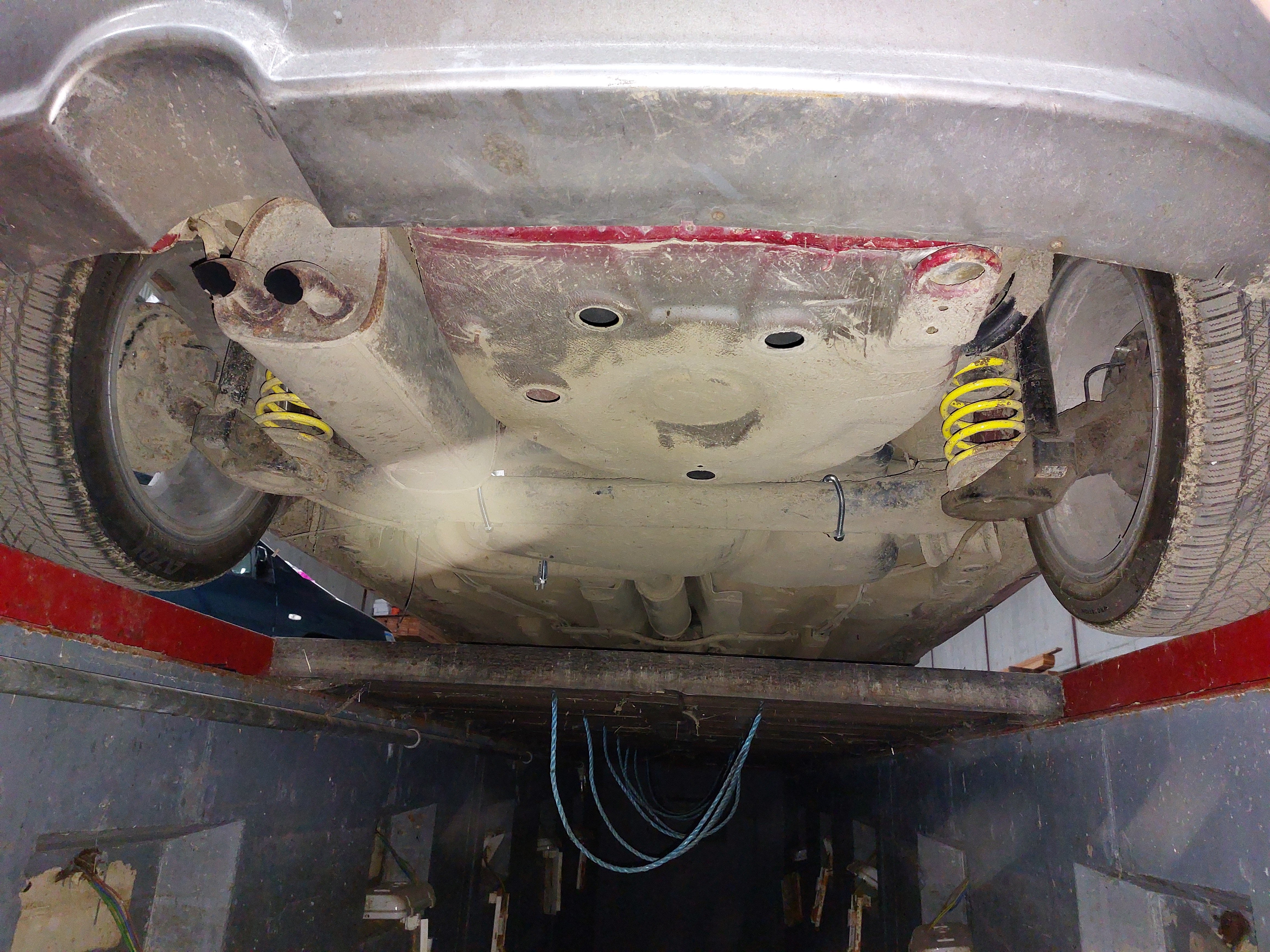

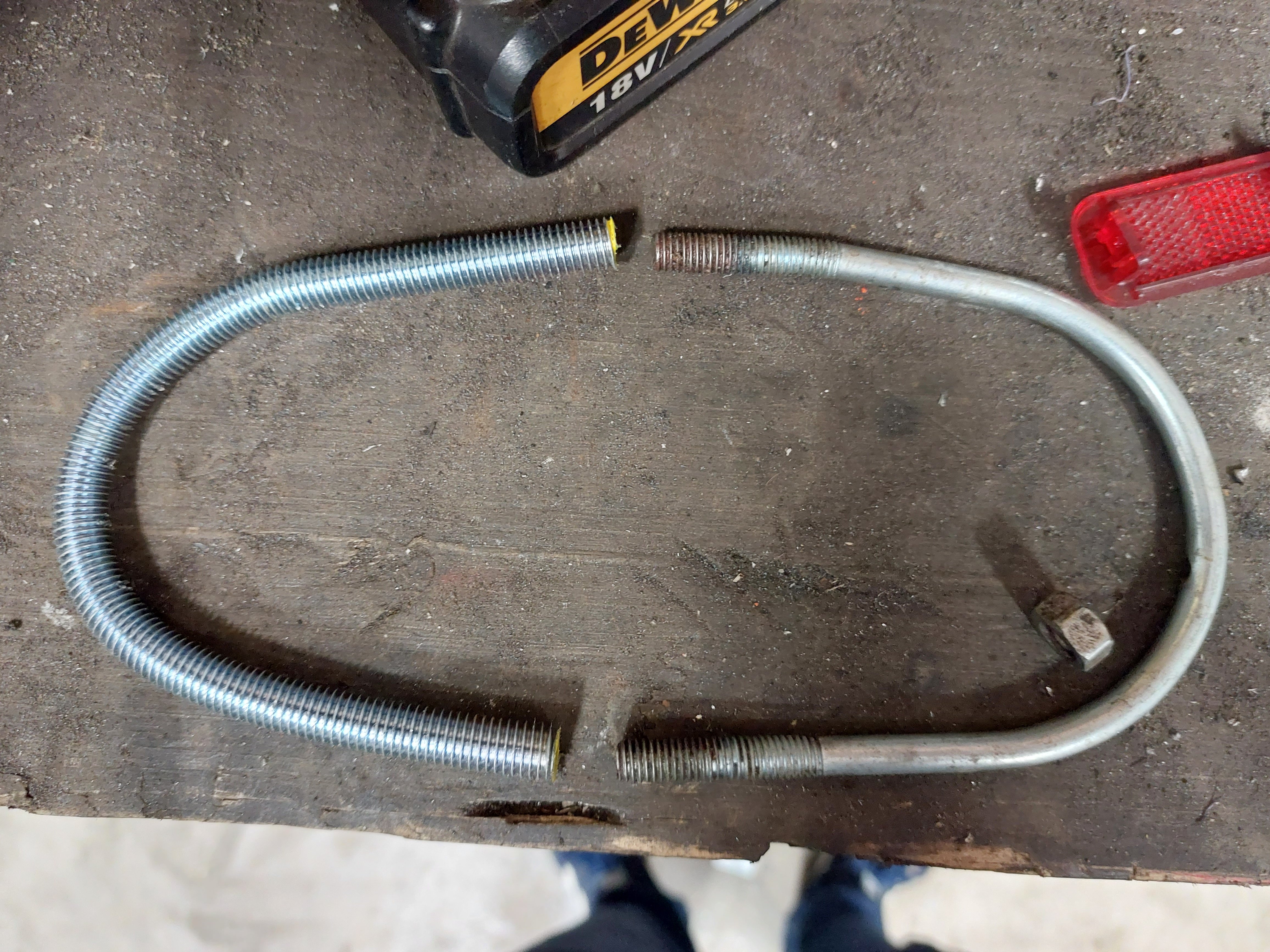

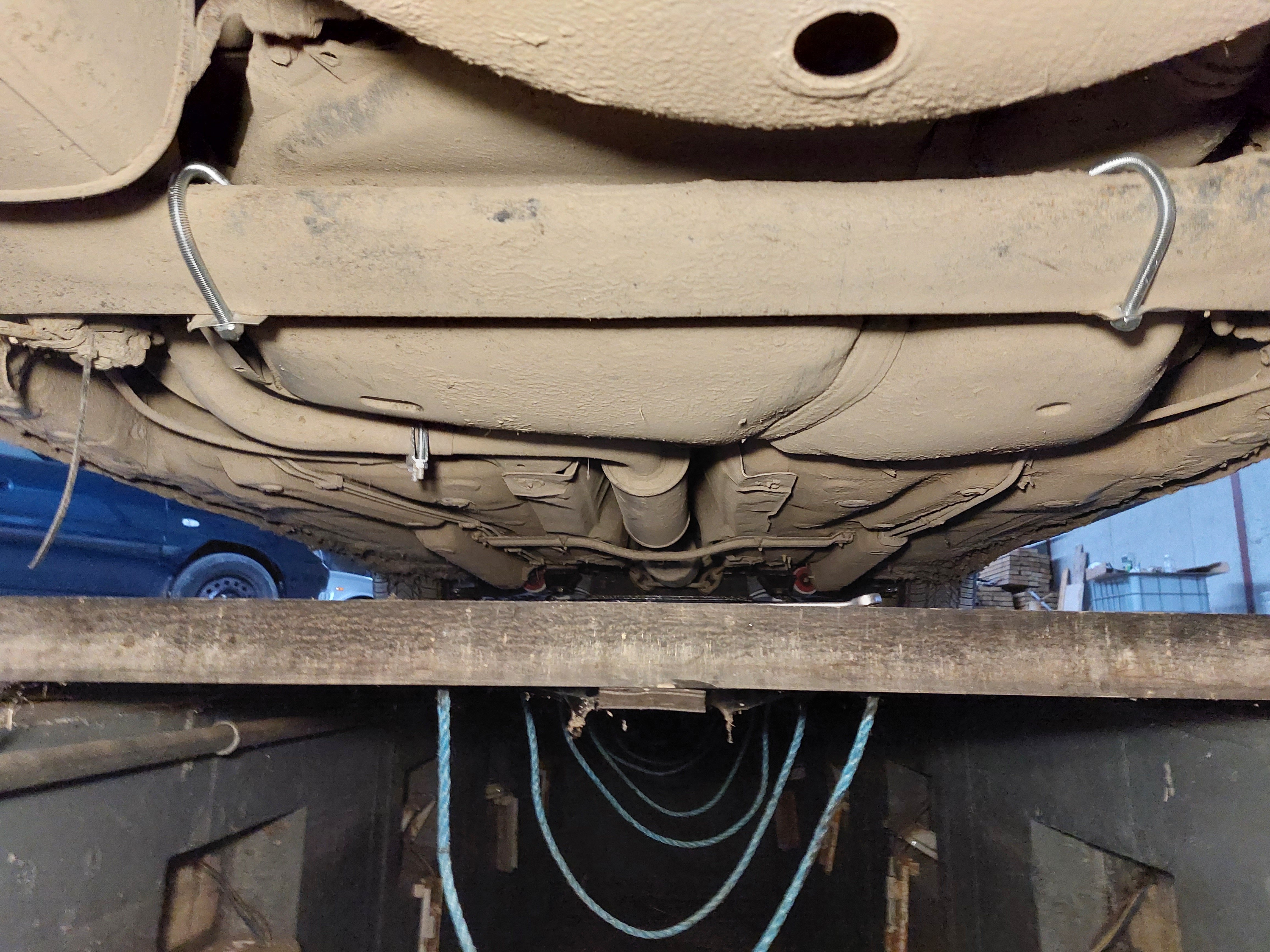

Very hack project I've been working on As Ryan says trying to get a similar effect of a rarb without spending the money. I got the idea from this article. https://www.autospeed.com/cms/a_113302/article Your man did this to a roomster no less. I think my approach is lacking in a few areas, namely the metal I use is really thin compared to what is shown in the article. I use a 10mm threaded bar and bend it to suit same as that article, using my old drum axle as a reference to get the right shape. Then used a strip of thin metal to go over the open V part. Currently a pair of these fitted to both my fabias. I'm still fairly worried that I'm just experiencing a placebo effect on both cars, but I think it has tightened both of them up a bit more. Mk2 has quite a lot of work done to it, including a rarb, mk1 less so but still has a little bit done to it. I hope Ryan can weigh in if he puts them on his car. If I'm proven right then it's great, if not well it just means I need to go back to the drawing board. I do like these little hack projects, and the Mk1 is a great excuse for me to try these things.

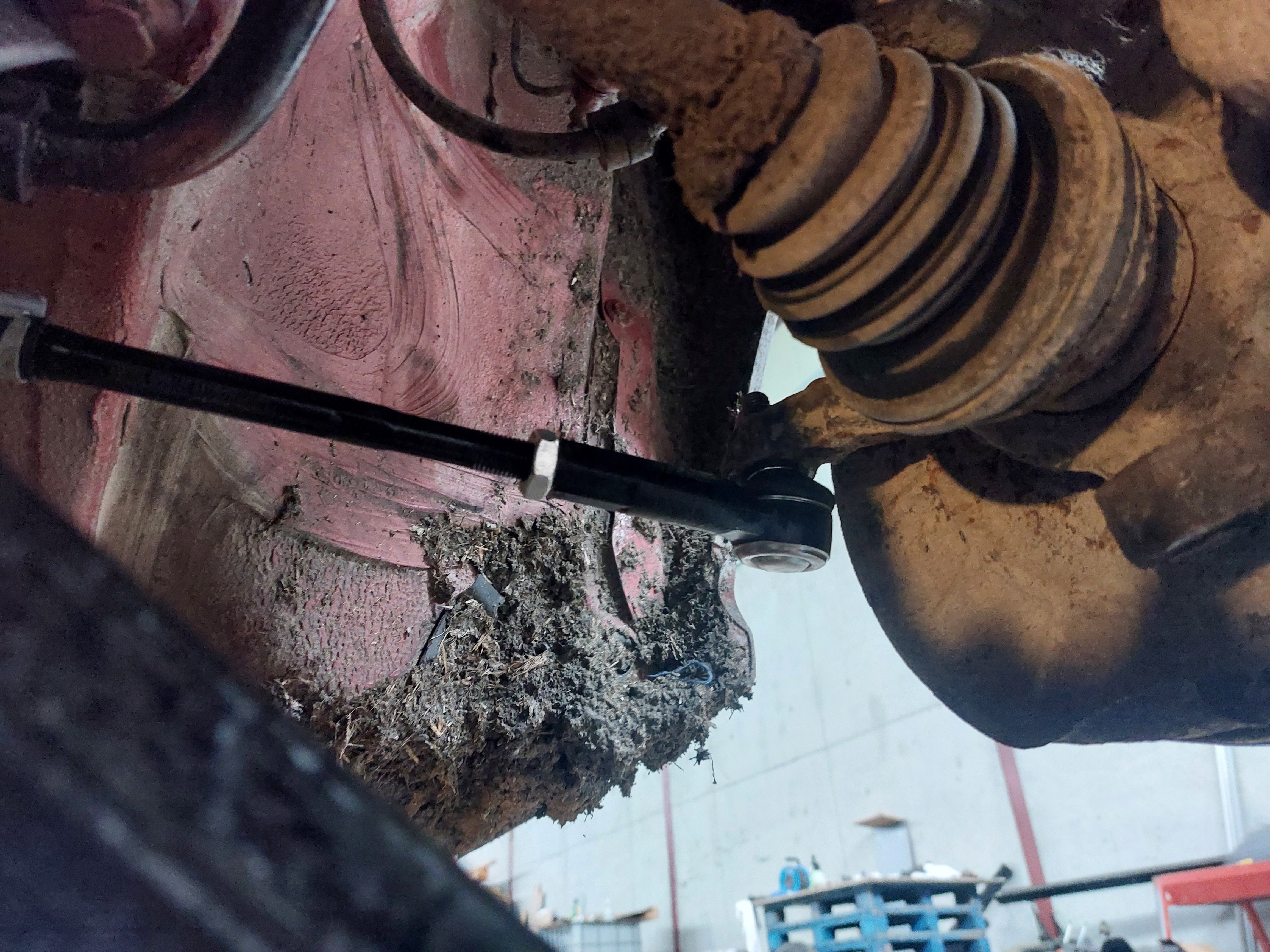

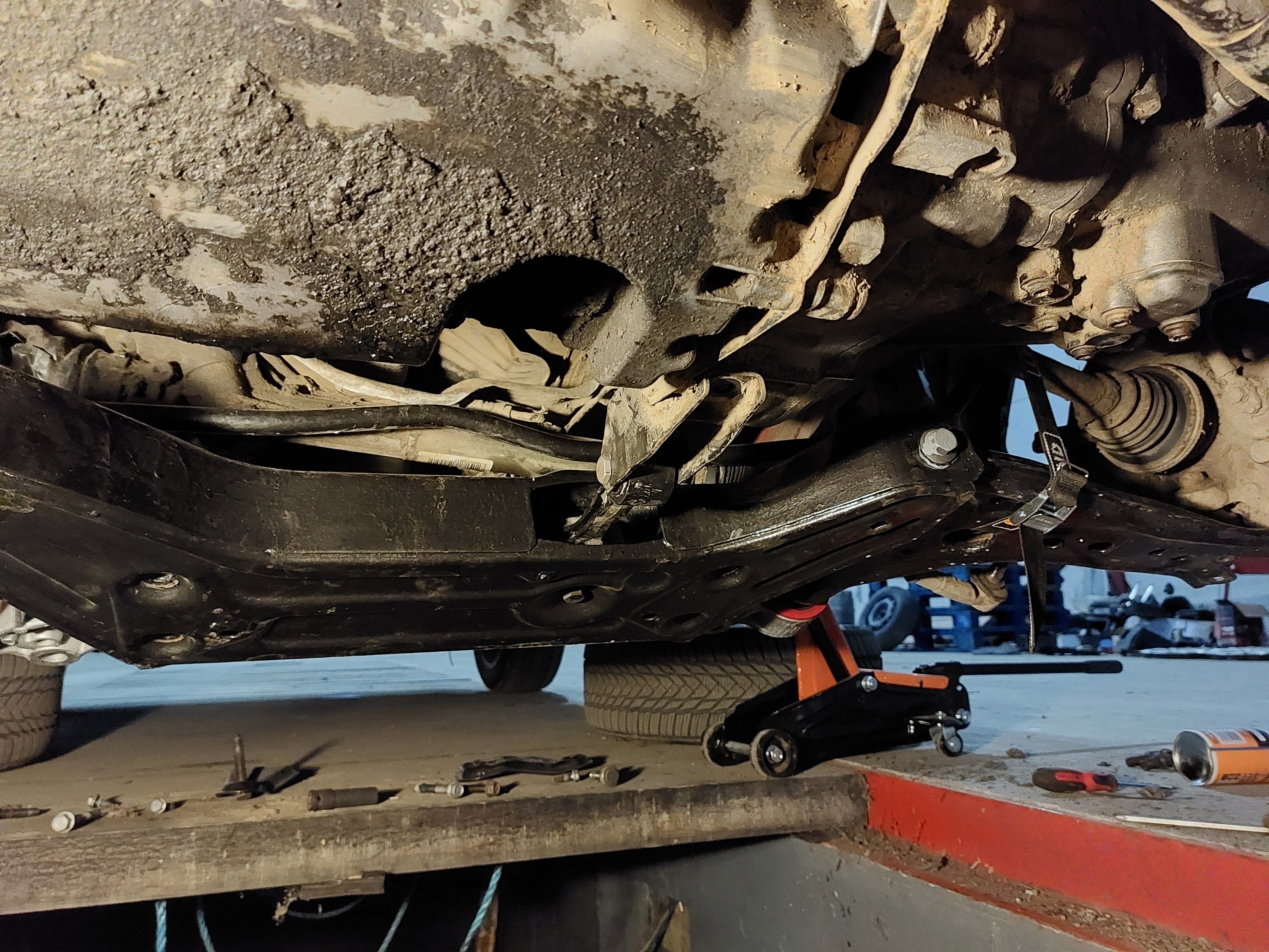

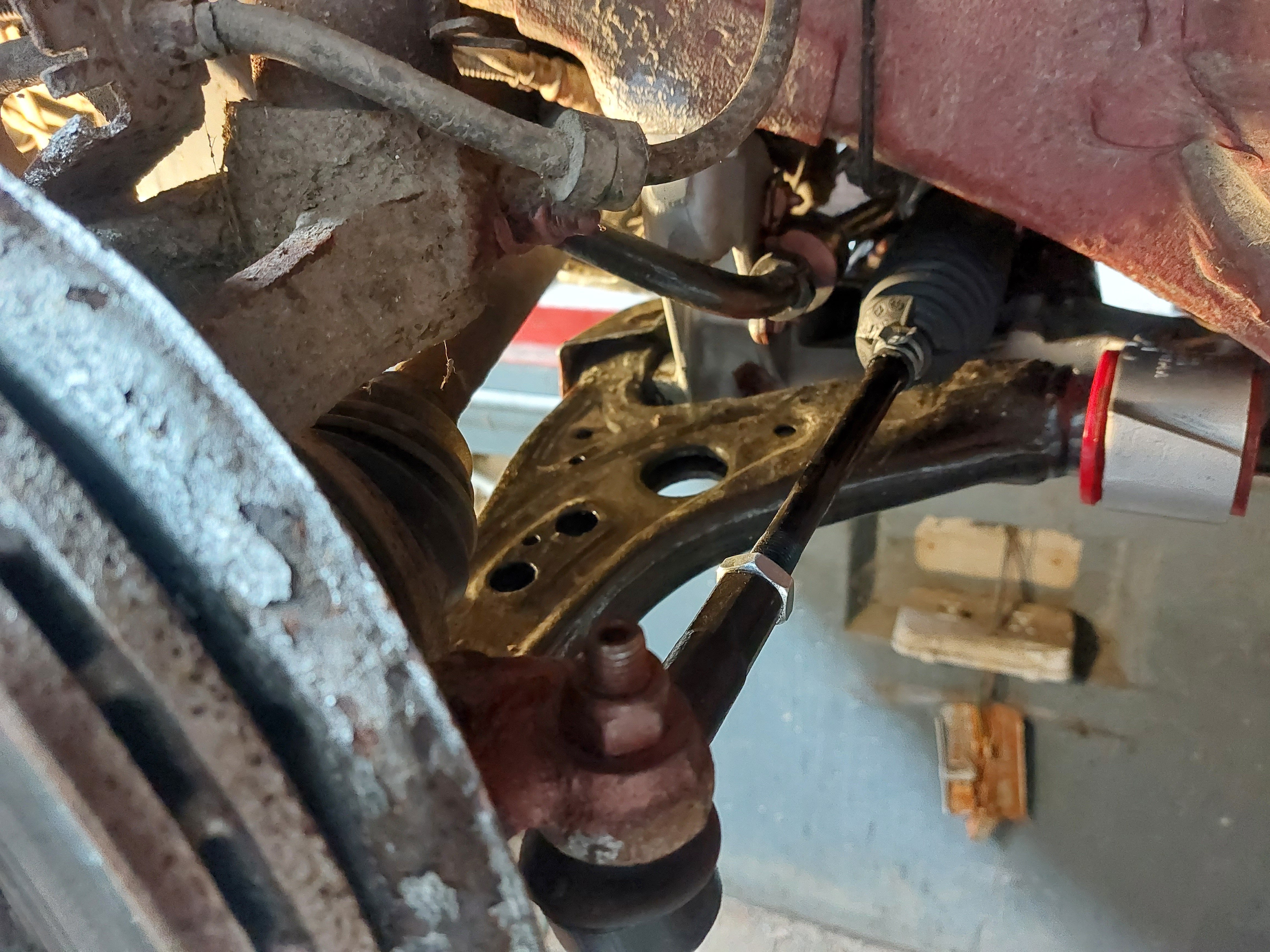

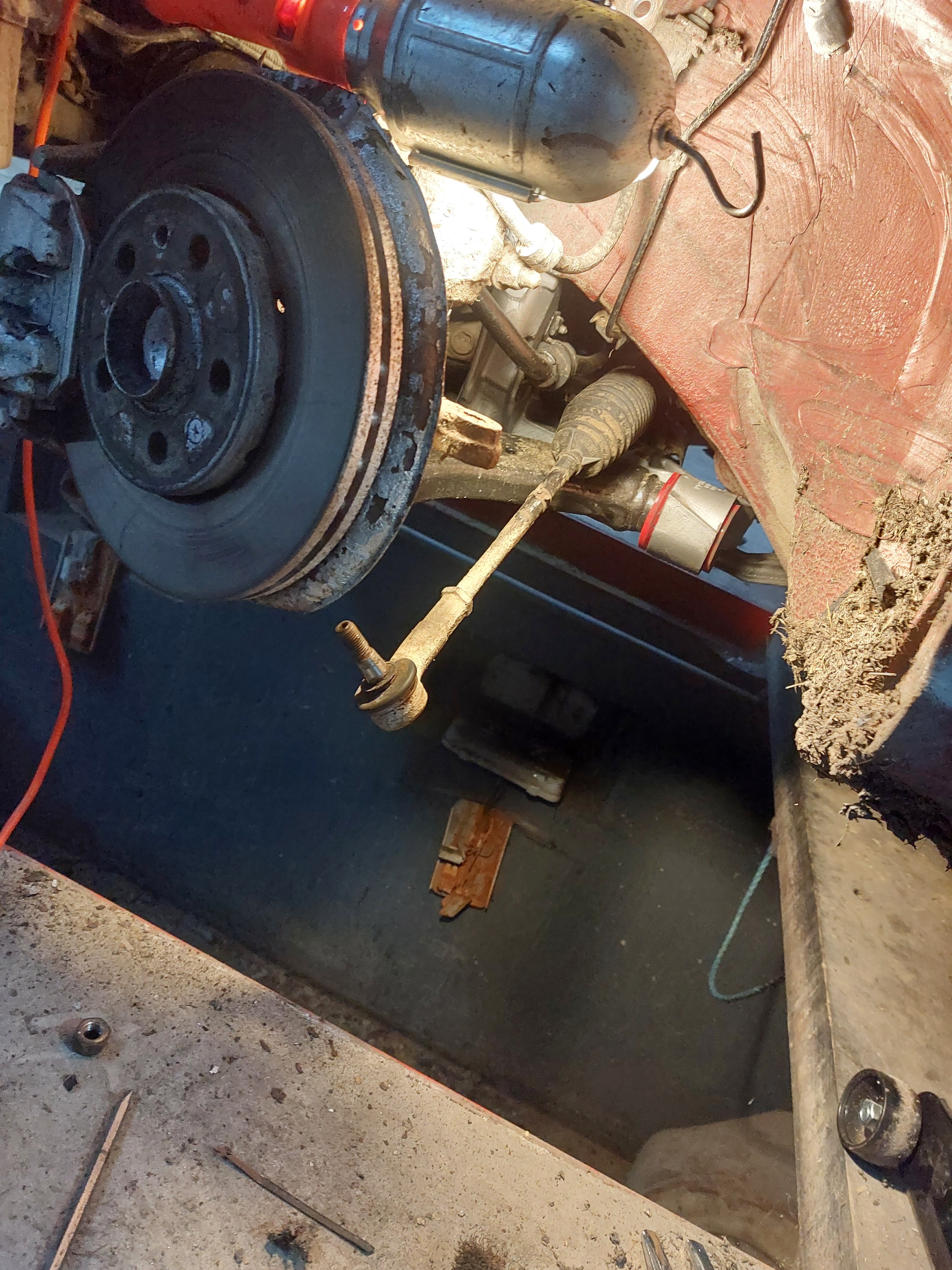

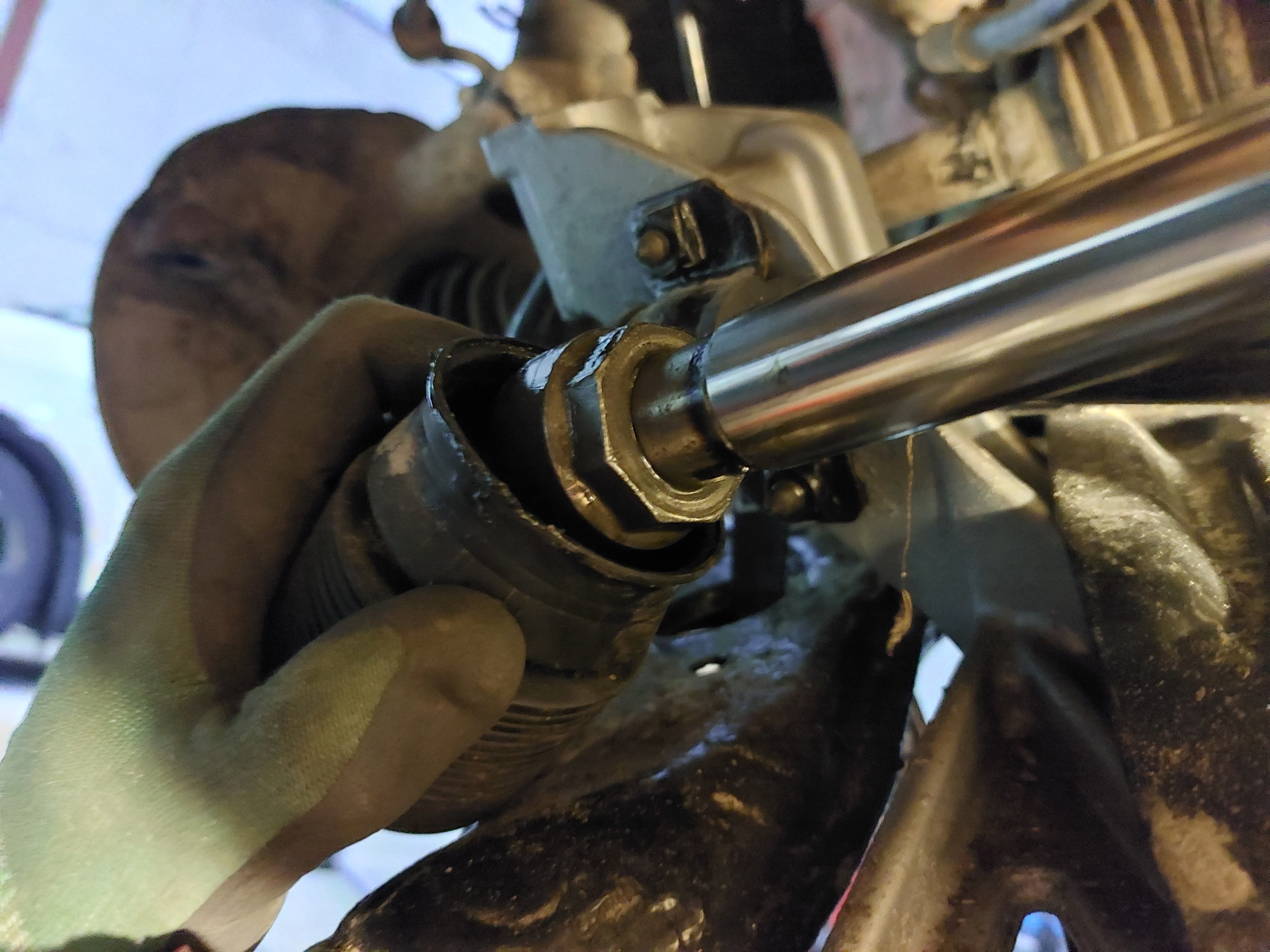

In the process of changing the track rods this evening. Inners were going to be a pain with the subframe in so I dropped it All came apart easy since It's all fresh, took not even 10 minutes. These take a 32mm spanner to get off Might be able to use vice grips, but I had a 32mm spanner luckily. Quick video of the old one vs the new one. Have new Bellows and clips to go on. Will probably use heavy duty zip ties on the large end though, just easier. Will go back together next day.

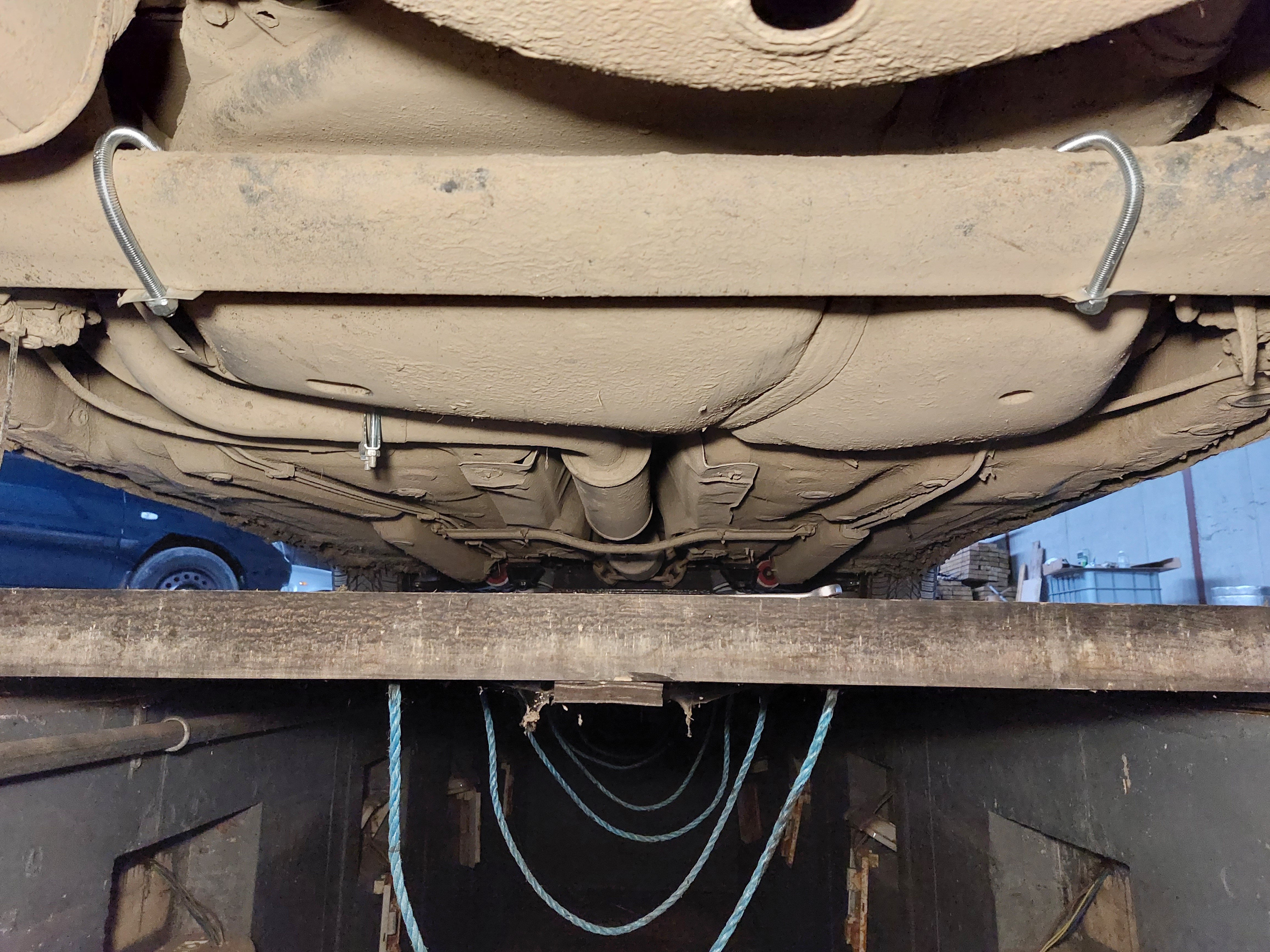

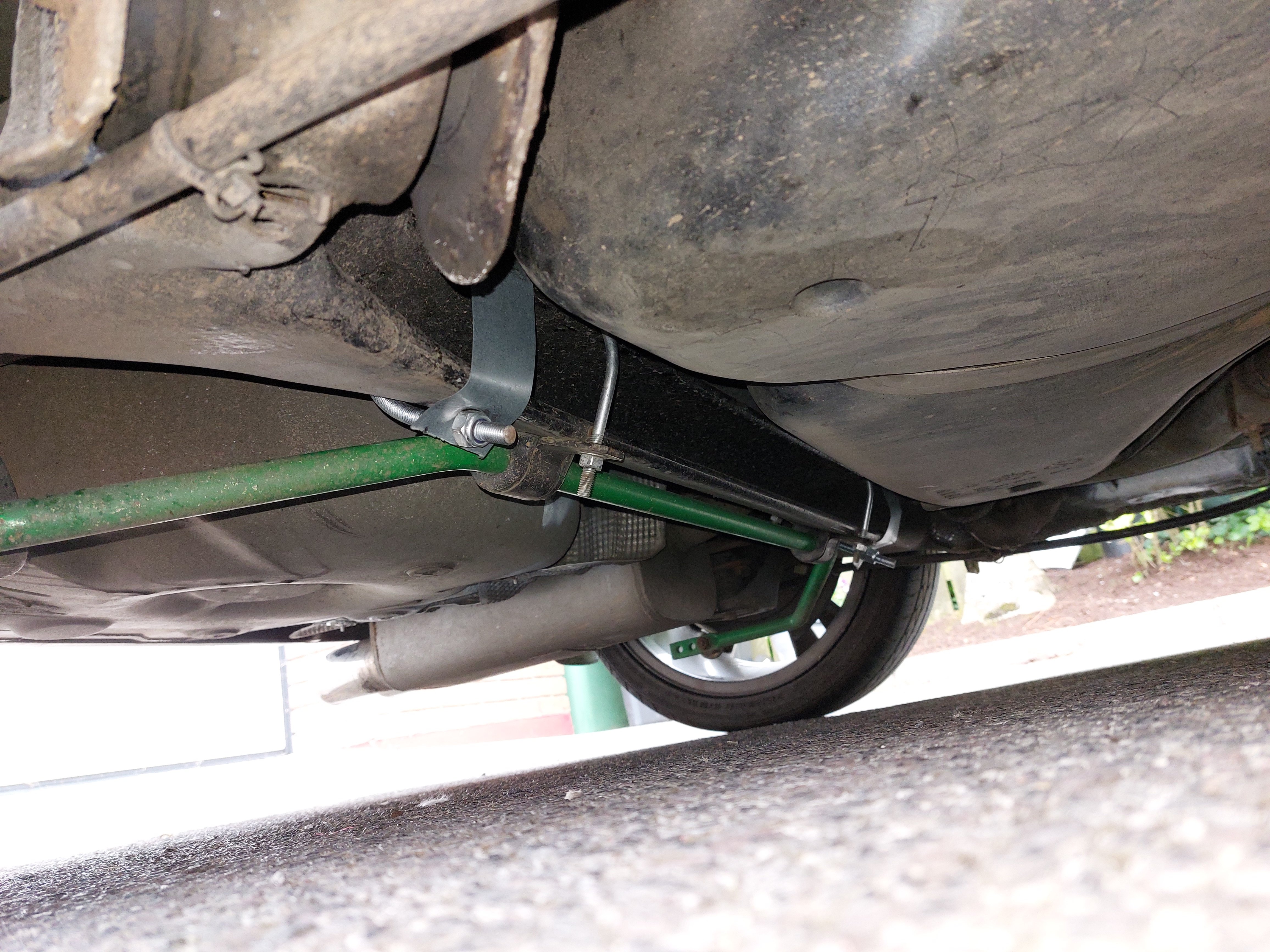

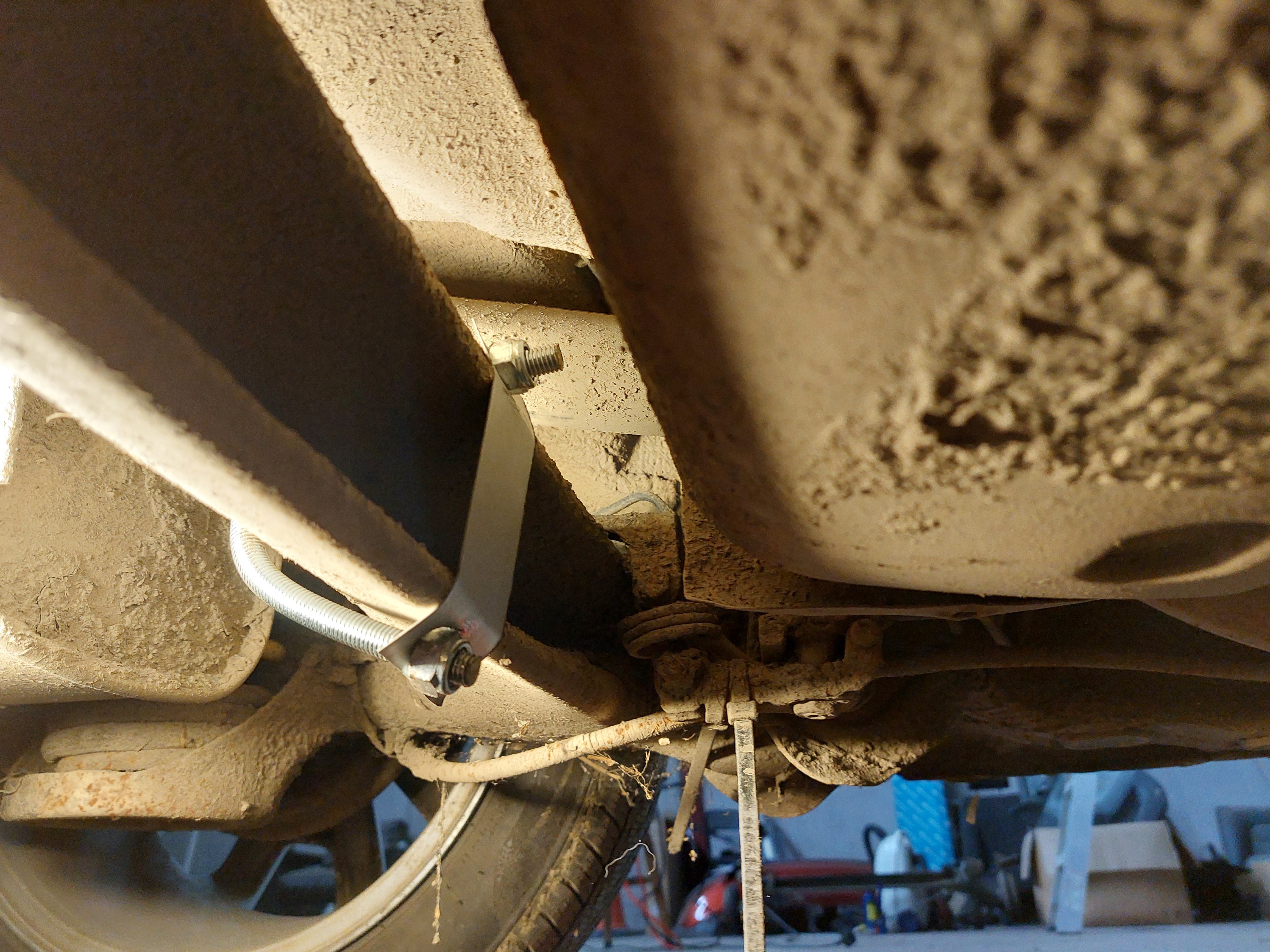

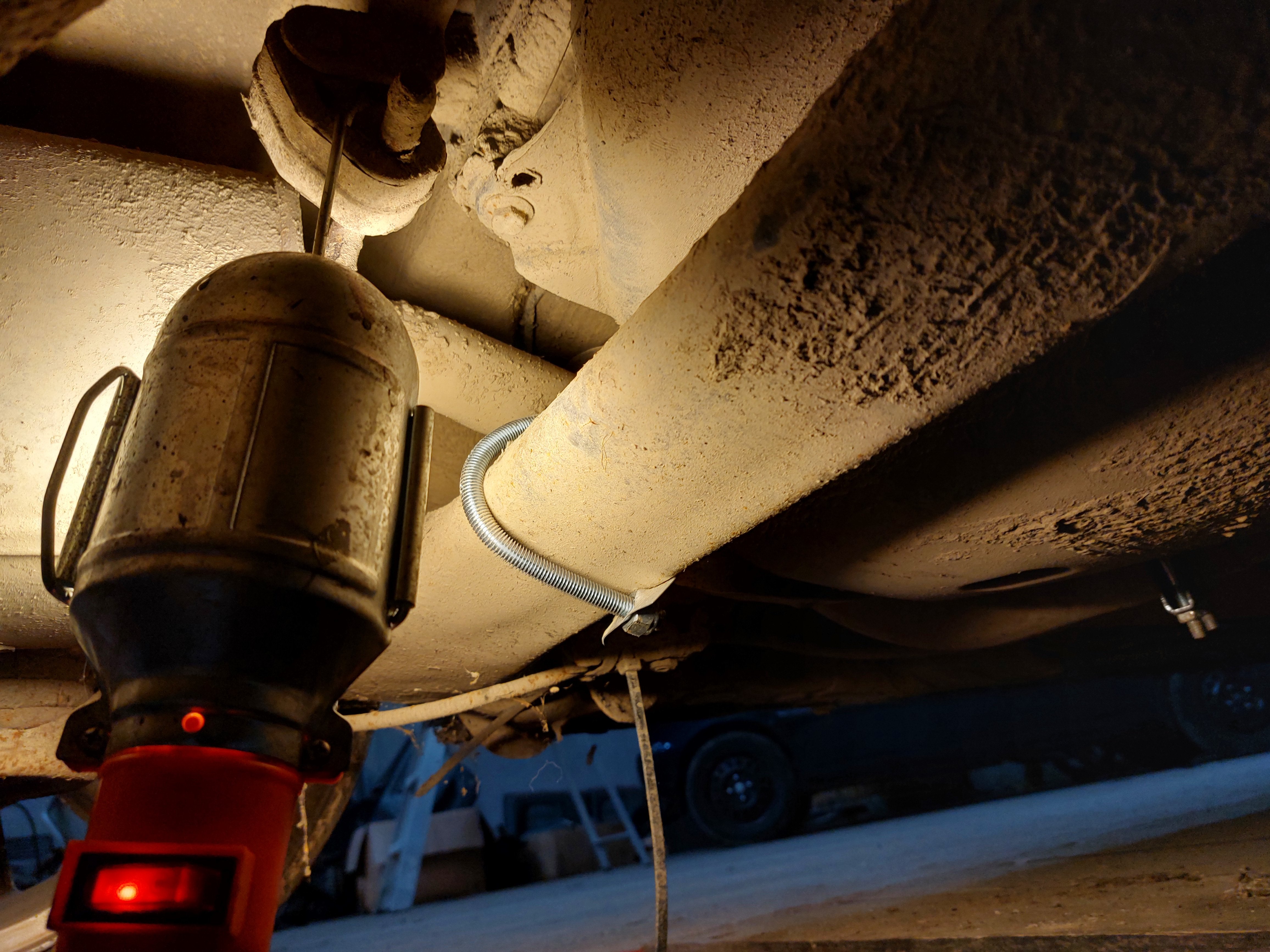

Had tried to change the stalks today and the airbag would not come out. Gave up and made more clamps for this car. Firstly, I've realised that I could have just used some 80mm exhaust clamps. Anyhow. Fitted the ones I made up, easier to fit onto this than the mk2 for some reason, more access. Took it for a few runs and it seems to have made a bit of difference. Seems like it's giving a similar effect to a proper rarb, but to a lesser extent. Driving really well this.
