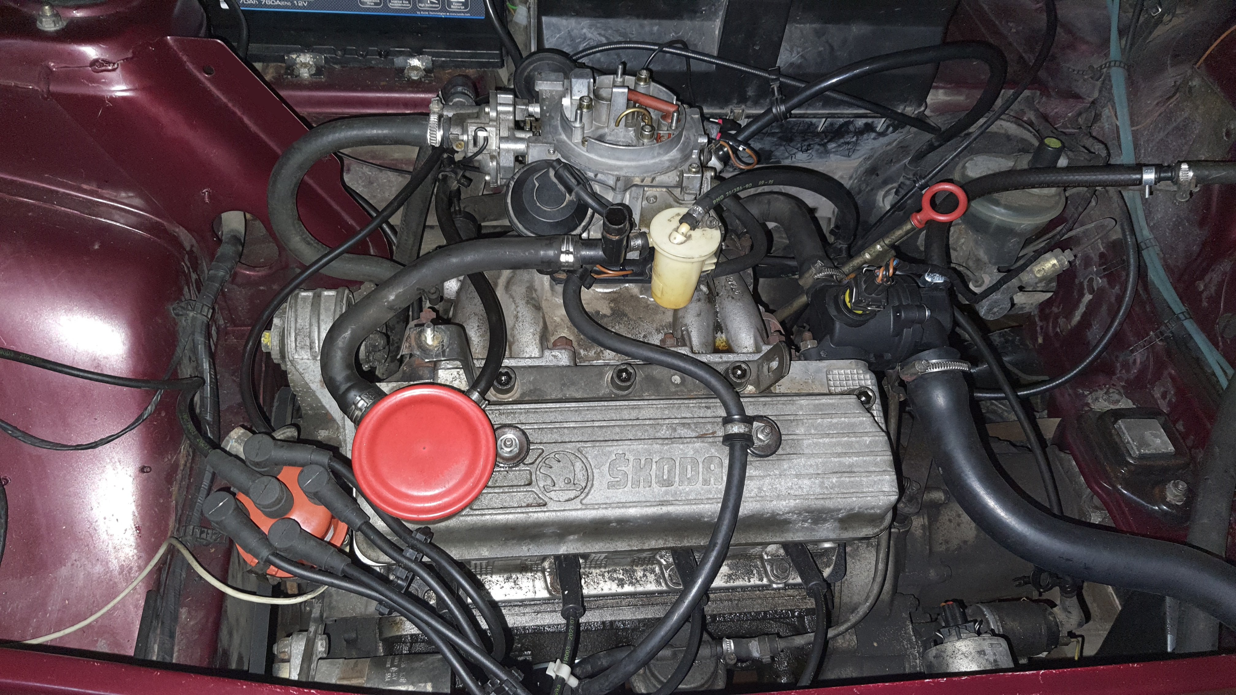

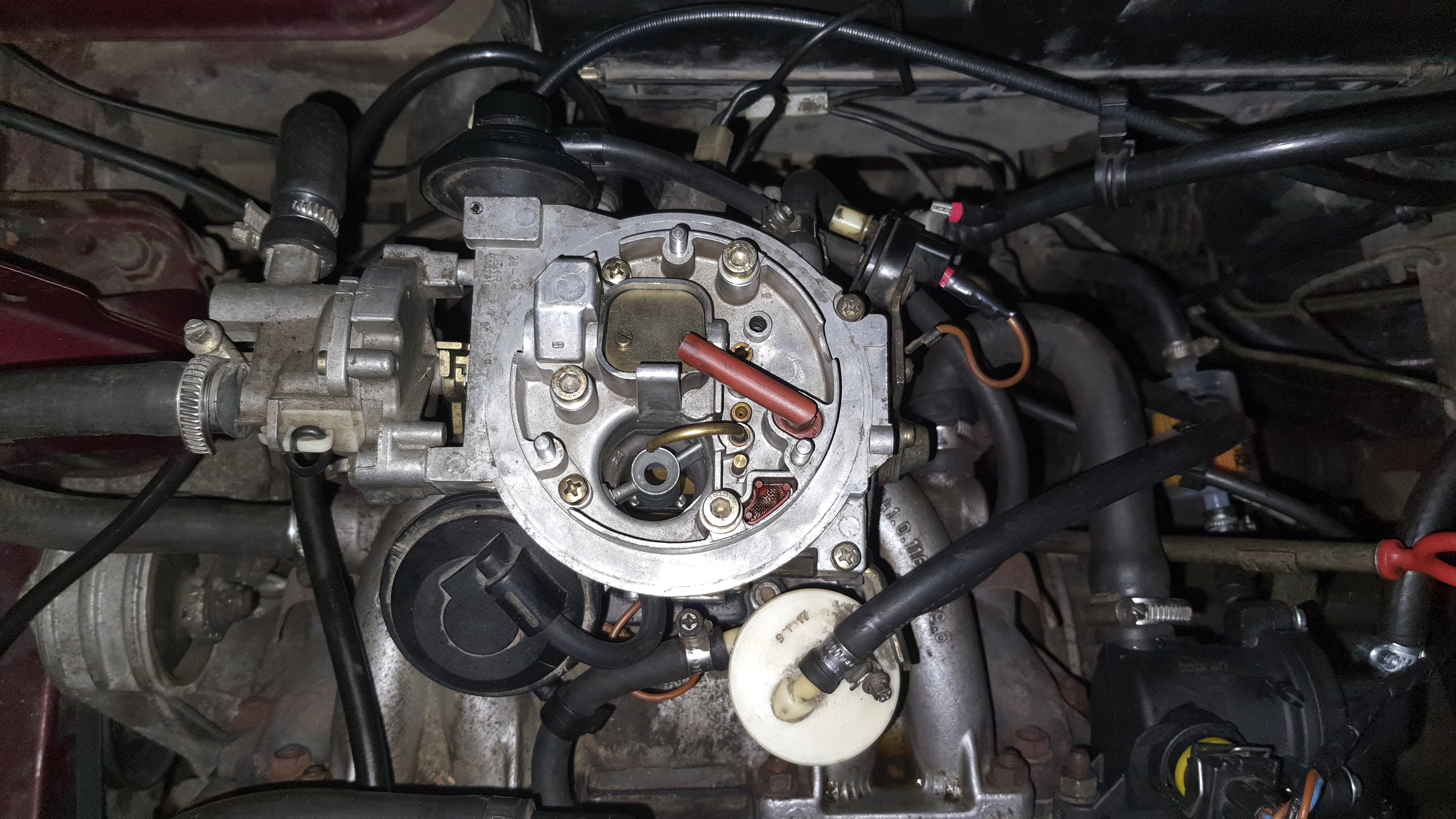

I purchased the car a few months back (driving back home, it averaged around 7.5 L/100km), and it was already smoking then. After checking the vehicle at a technical inspection place, it ran way too rich. (too much unburnt fuel exited the exhaust). It also started icing (I believe). The throttle becomes unresponsive, the car starts jerking and eventually dies. After a few minutes of standing, it's fine again. So I took the carb apart completely and put in new gaskets. The idling problem was occurring then as well but mostly when the CO screw was turned out only about 2 turns and the car wouldn't turn off when the idle cutoff valve wire was pulled. The base gasket was in bad condition, but I couldn't find a new one, so I used Victor Reinz gasket maker (which @RicardoM recommended in another forum thread). After fixing the gasket, the engine would shut off when disconnecting the wire. Not the same case when turning in the CO screw (it should cut off fuel). It only died when the idle screw was set so low that it just didn't have enough rpm. Also changed the head gasket (quite new looking) and manifold gasket (pretty rough). Before changing the head gasket, some white residue would collect underneath the oil cap after driving (occasionally) but disappeared after standing still for a night. Oil seemed fine. Dont know what was done previously with the car. Only has 100k km. I haven't driven it much, only a few hundred km, since I want to fix it. Pictures are taken without the air filter on. I also changed the distributor cap, spark plugs and wires and the belt.

@RalfRannet @nta16 @Thefeliciahacker Well, I can't actually prove this over the internet, but I think the carb is very badly set up, and may possibly also have a air leak.

Have a good look at the top surface of the carb. The circular brass bits are the top of the emulsion tubes. There should be a tiny air orifice in each. There may be debris blocking the idle one.

Zooming way in on your photo, I think the idle one is the one with slots that could allow a screwdriver to unscrew and remove it.
Thank you for clarifying, but both of the holes were clean.
