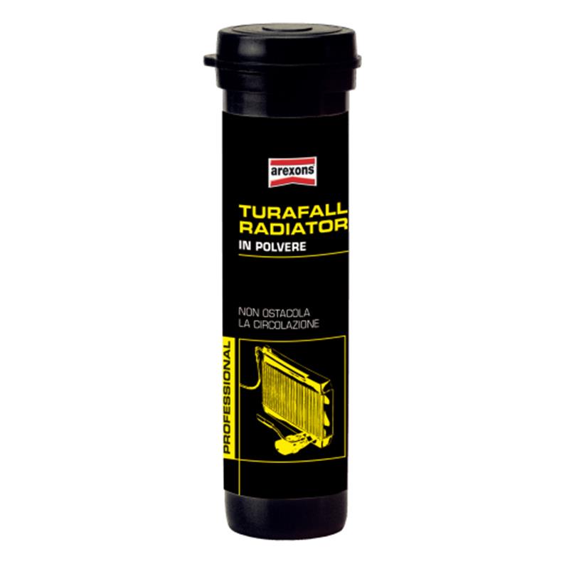

Amsoil additive is red colour, my coolant is Blue so maybe the combination turn to Green.
No was many years ego and was like these which Yes were like ''dust''.
https://autocorner.gr/wp-content/uploads/2020/04/fwkia-arexons-skonh.autocorner.gr_.jpg
https://www.angelidis.gr/photos/4011.jpg
The weird was that i had no ''glitters'' inside the hoses or on the coolant sensor, everything was clear. I checked those ''glitters'' in my palm, were small detritus like some pulverized material. Unfortunately i had no magnet available at that time to see if it was iron.
Turafalle in polvere per radiatori is powder leak stopper for radiators perhaps combined with coolant that creates some "glitters" again you could contact the manufacture.
A breakdown service added K-Seal to my car's system as it got a leak to the radiator when I was far from home, it sealed the leak but later I notice dark brown or brass type (I forget which) "glitters" in the metal expansion tank.
Your "glitters" might have been from either of those powder sealants, or even perhaps the Amsoil additive, or perhaps even a coolant, or a reaction from any combination.  As everything else seems clear then perhaps these "glitters" have just come to the top of the system and residing in the expansion bottle.
I'd not worry about it at all.  Next coolant change if you wanted to you could not only drain the existing coolant but also perhaps clean and/or thoroughly flush, back-flush and flush again the whole system and thoroughly drain before refilling with fresh new coolant.

I would NEVER use such a radiator sealant type again.
