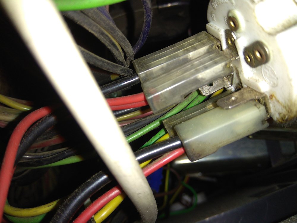

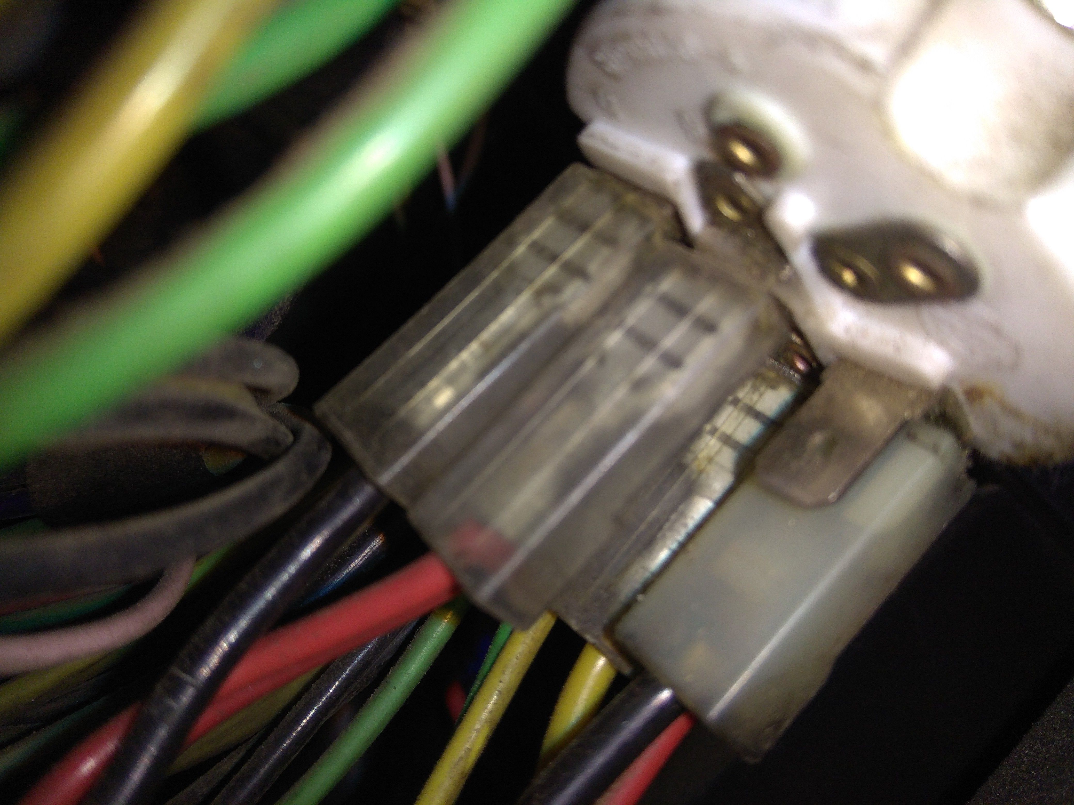

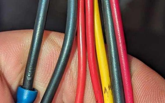

In my pics and the OP's the wires look red. After looking carefully, I think among @Wezzlers's cables, there are two lighter tone reds.- Ignition barrel wiring favorit

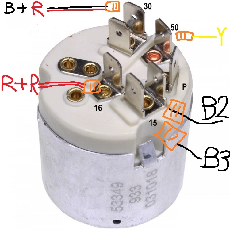

More visualized version. No:30: Two terminals. Black + Red crimped together in one connector. Black is Battery (+). Red is side light switch. Second terminal is reserved for stereo. No:50: One terminal. Yellow. Starter motor connection. P: not connected. No:15 Two terminals. One black goes to fuse/relay box. Another black goes to ignition module & coil feed. (Unfused! Design flaw?) (In my previous pictures above, the second connector is hidden. Probably the extra black cable you were asking is this. Your stereo may be connected from a ring connector bolted on fusebox.) No:16 One terminal. Two red cables crimped in one connector. One red is from the low level warning switch of the brake fluid reservoir. The second red is from instrument cluster brake light bulb.- Question about clutch and gearbox on 1.6

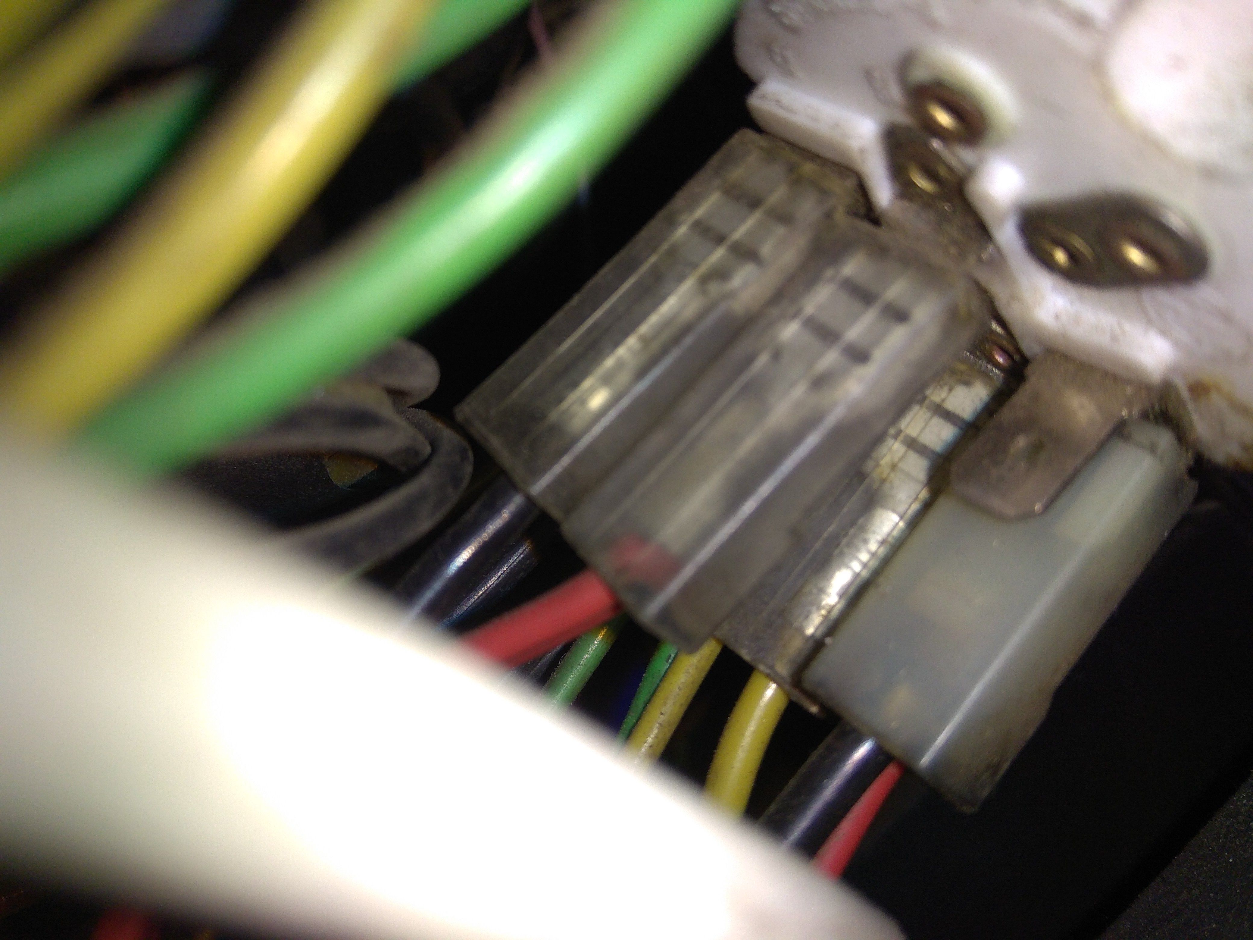

I'm uploading 15 pages from electrical blueprint covering old and new electric system. I tried to decipher it meanwhile. The black/red bundle: Black cable is connected to ring connector with bolt on the fusebox you pictured above. It's battery + connection. Red is connected to sidelight switch. Double red is responsible for brake fluid level. One is coming from instrument panel bulb the other one goes to brake fluid switch. Yellow is starter motor signal cable. The black cable cable which stands alone is connected to the fusebox. It's triggering the X relay and other devices connected to the fusebox. The extra black you have could be the power cable to the stereo. If that's so, you must connect it to the empty socket near black/red bundle. (See my picture) Wait until other members see the blueprints. Coming soon.- Ignition barrel wiring favorit
The thick black is alone. There are two reds clamped together at the end of one terminal and there is another red clamped together with another black. Yellow is alone.- Ignition barrel wiring favorit
