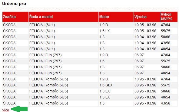

https://www.amd-autodily.cz/zadni-naprava/zadni-napravnice-zesilena.html The list in this link made me thought they were compatible. I saw Felicia Fun (which is a pickup) above the list but did not notice the "Více" word below the list. Which means "more". Surprisingly Felicia pickup is not listed and it turns out Felicia Fun has a different rear suspension system. I should've done my research deeper. Sorry for the inconvenience and thanks @Papez for his expertise.

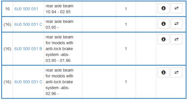

@Neilswheels welcome. According to this: Main difference is the presence of ABS. Maybe there are some factory welded mounting points for the extra cables and/or mounting points for different paths for ABS models. https://skoda.catalogs-parts.com/#{client:1;page:part;lang:en;region:cz;model:felicia;modification:fel;year:2000;modetype:101;group:5;subgroup:500;pnc:500000}#16 And, according to this: https://www.amd-autodily.cz/zadni-naprava/zadni-napravnice-zesilena.html Rear beam axles are interchangeable between all Felicia models. I don't know about the last letter difference between beam axle numbers but if that is something like different mounting points for small details like cables etc. It can be dealt with, without too much hassle.

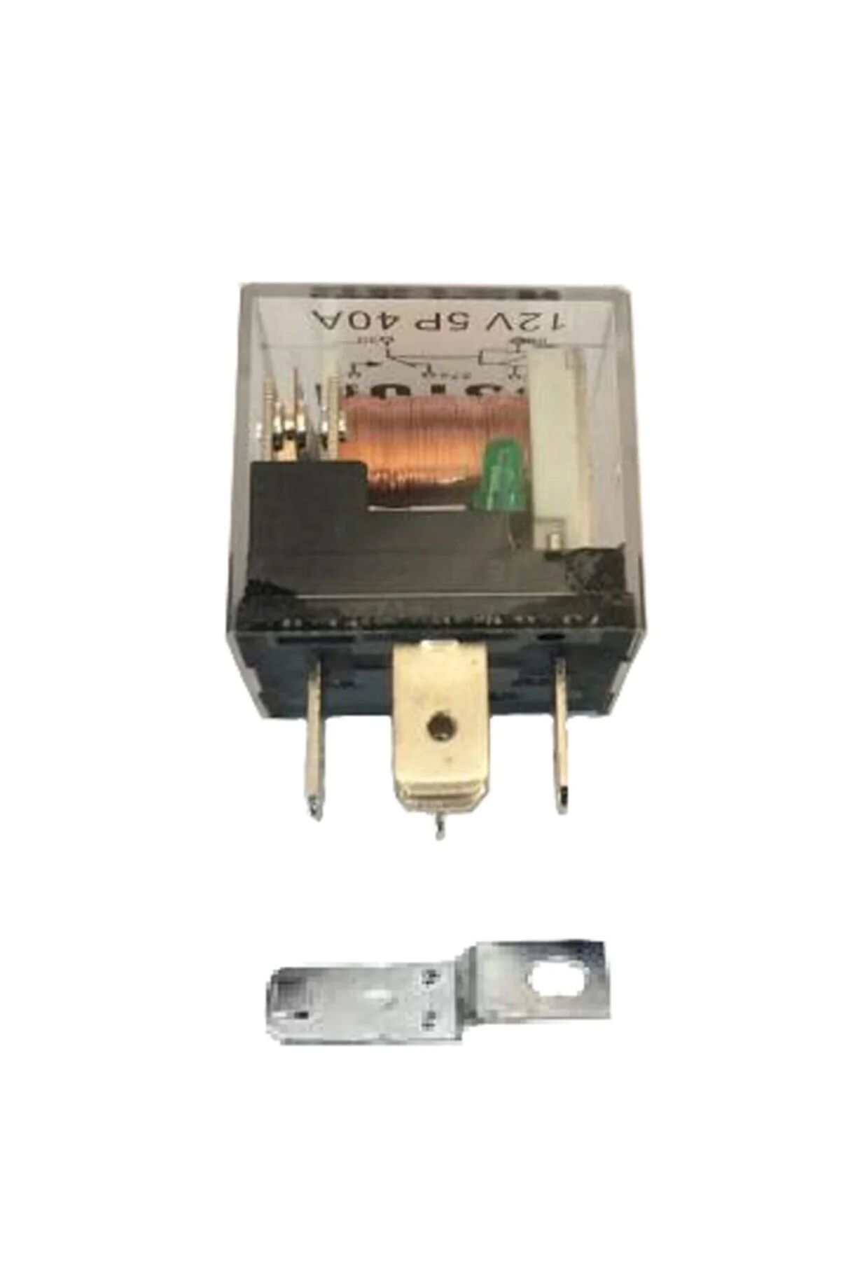

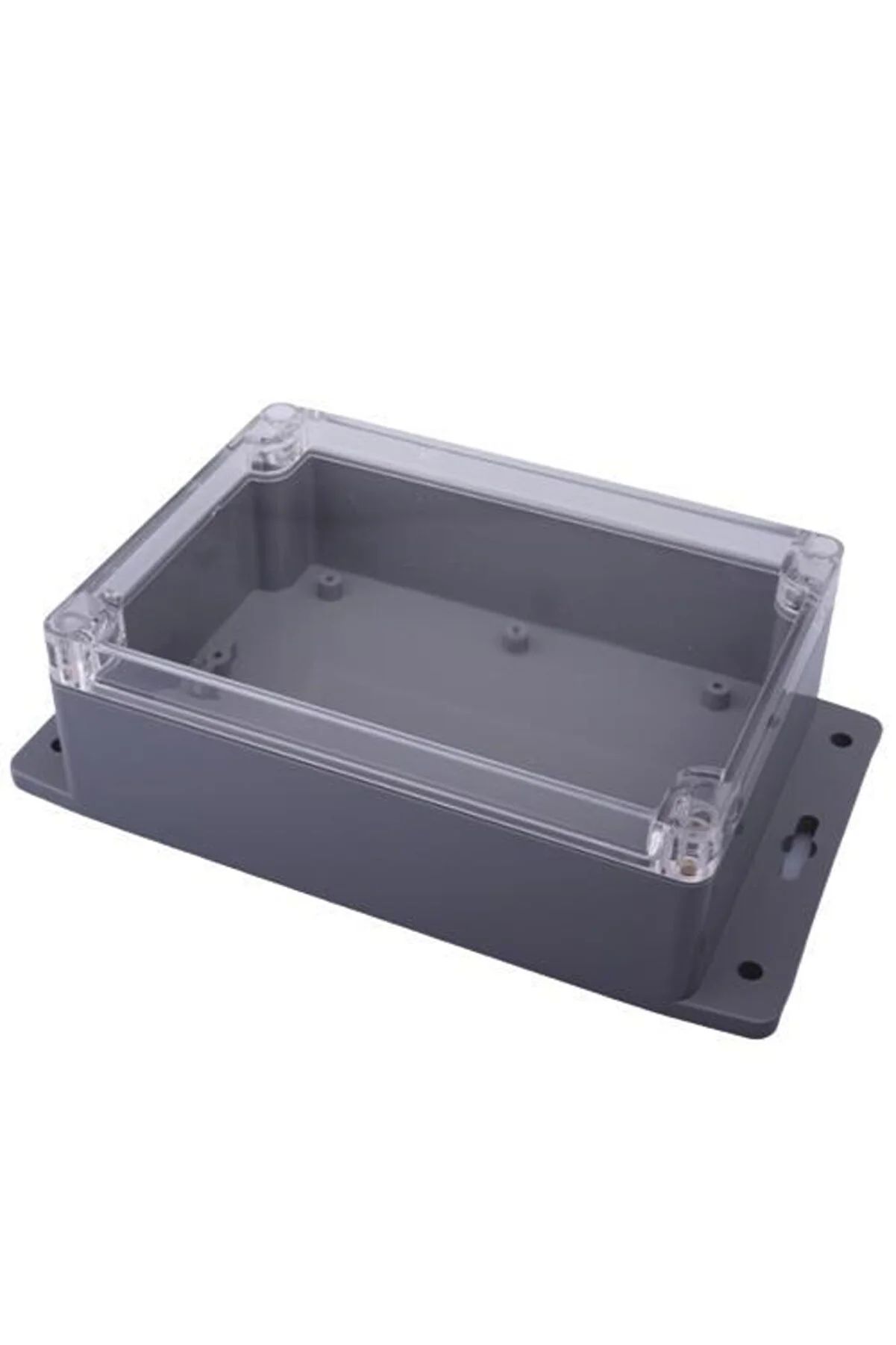

I like your dual speed fan controller circuit. Thanks for sharing. I agree with others about the initial placement of the relay group though. That was too low. New place is better. You can always use 5 pin relays instead of four pin relays too. Like this one: These are very cheap and very common. Also, instead of searching for a special relay box, you can use a common electronic project box. They are dirt cheap and easy to find. I found one example box, which has a clear cover too. If you place the relays and fuses appropriately, you can check their conditions visually (relay leds, fuse condition etc.) after closing the box. For waterproofing, you can use red liquid sealant around the cables' box entrance and around the box cover before screwing it.
