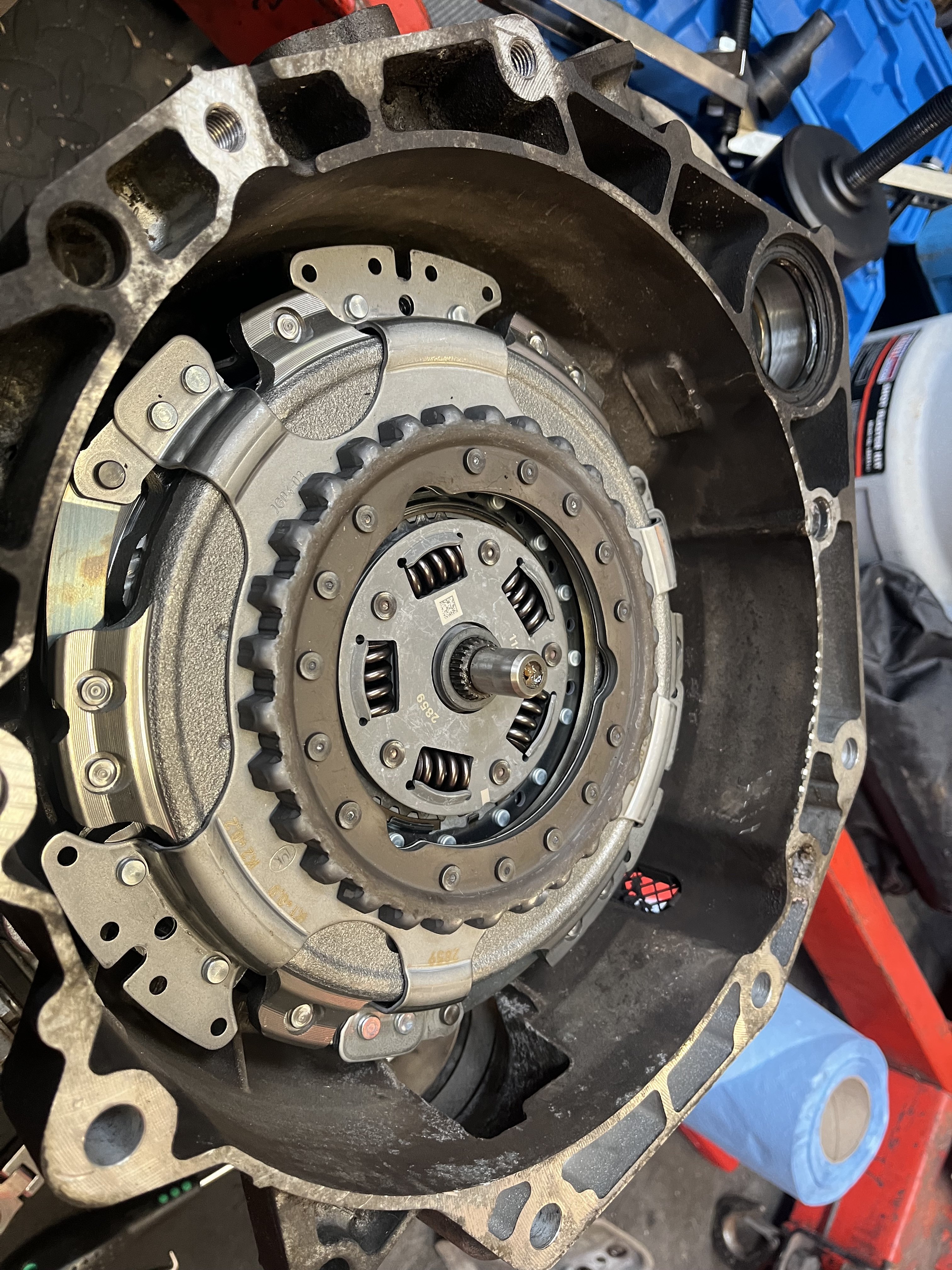

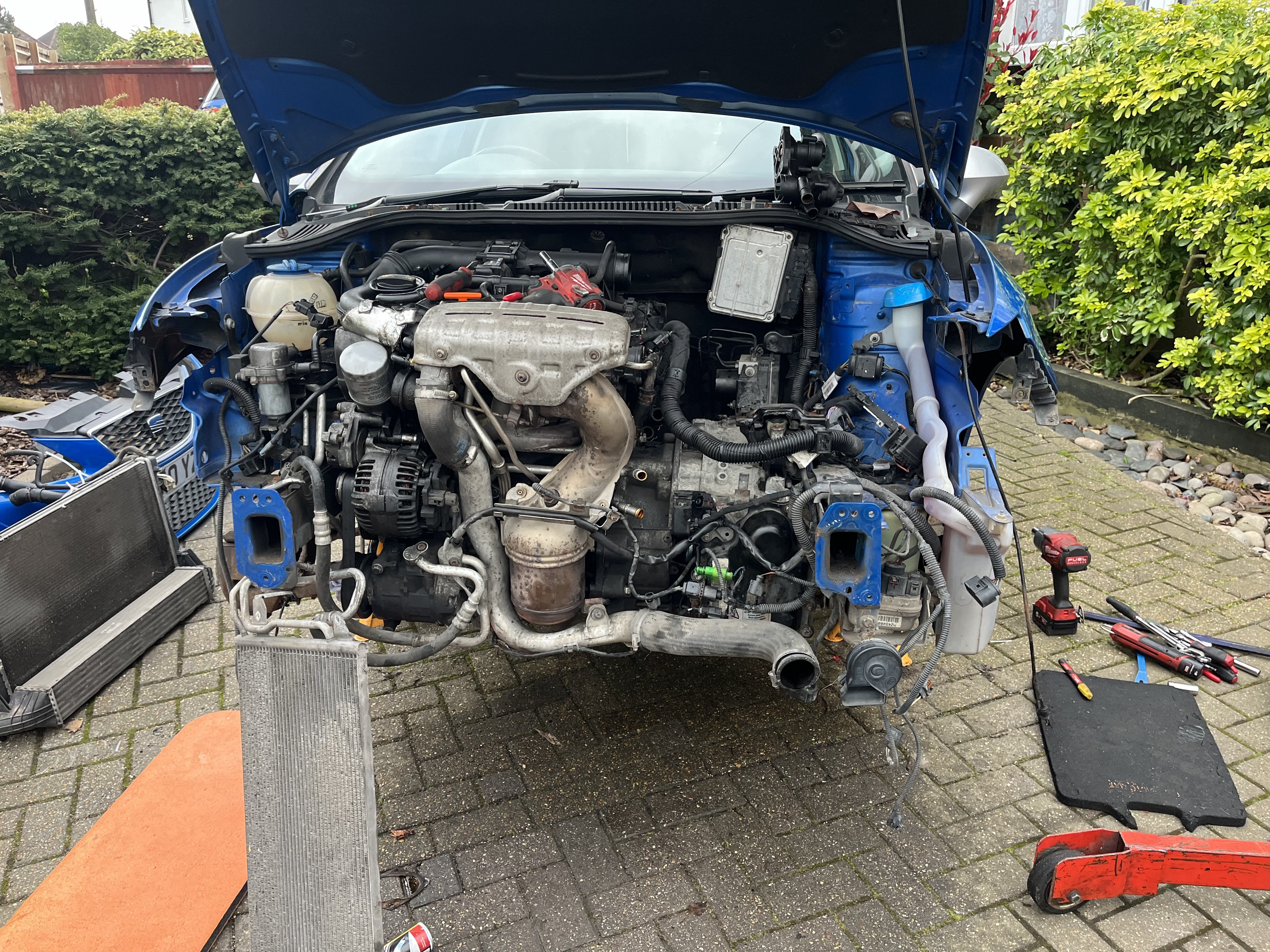

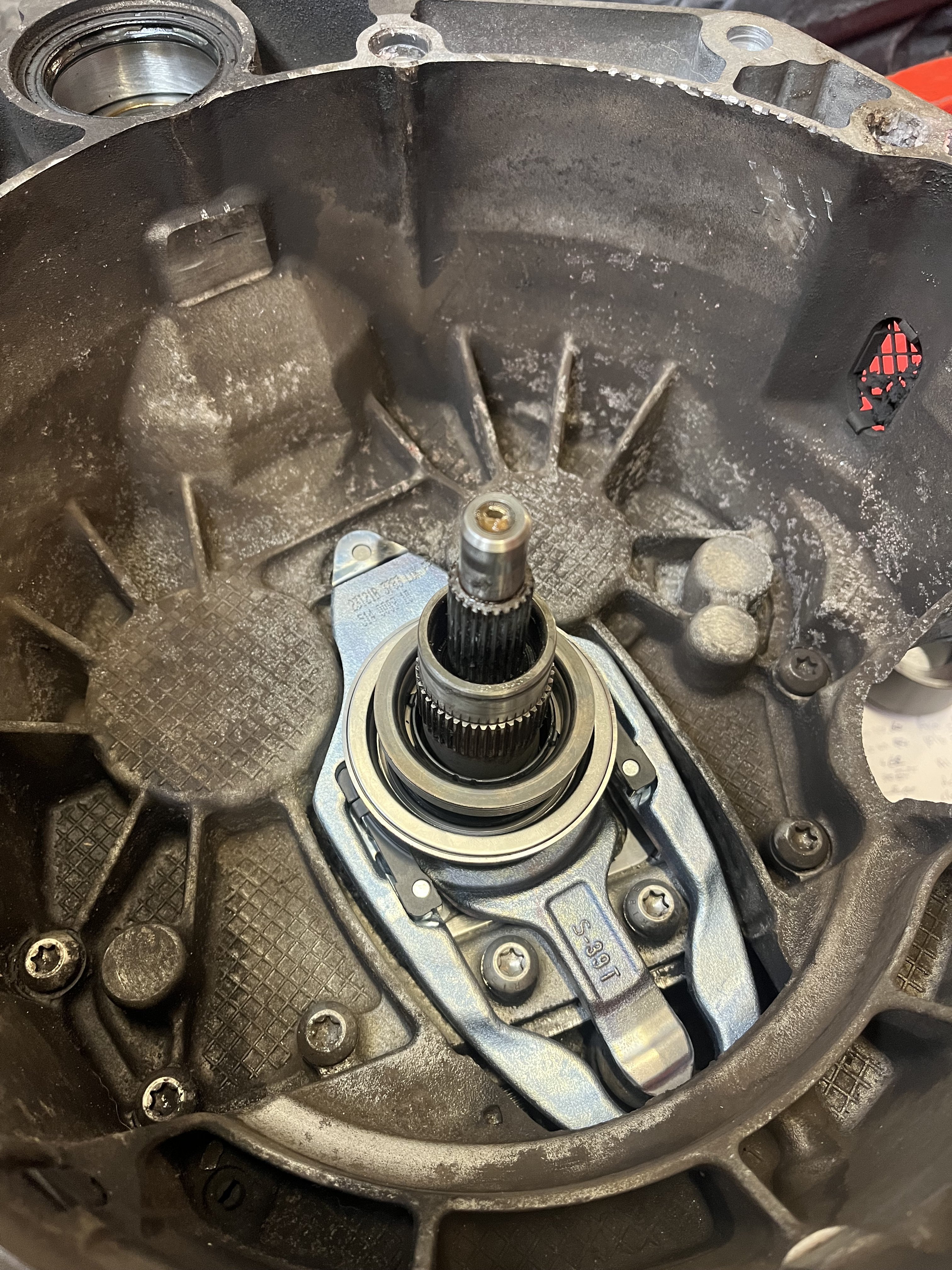

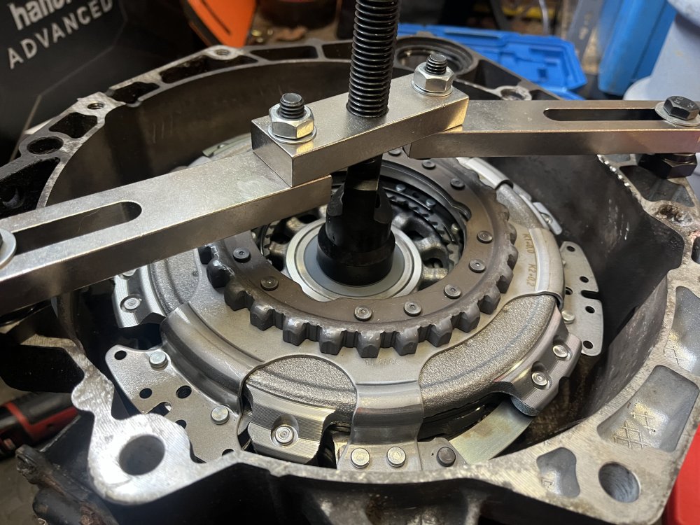

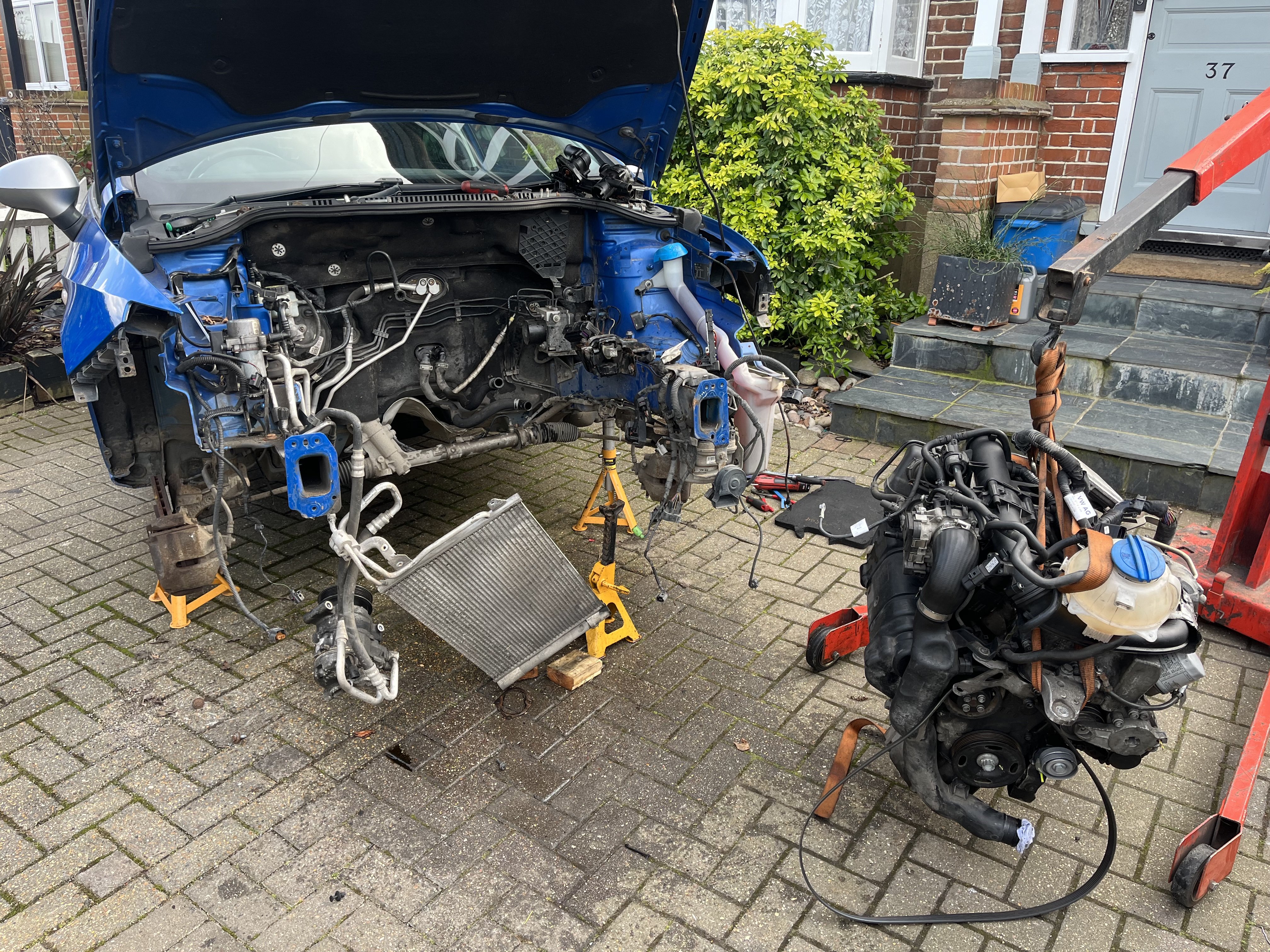

Car in question - Seat Ibiza 1.4 TSI DSG 2010 - 85,000 miles So I had the pleasure of my girlfriends car making a nice clunk noise under acceleration. On further inspection the noise was from the gearbox even at idle albeit quieter. After jacking the car up and driving it through its gears, one of the clutch forks (visible outside the gearbox) could be seen moving side to side when in or out of gear. When force was applied to this the noise disappeared. This confirmed the fault with the clutch and possible further issues on gearbox input shaft failure. The next step was to order all associated parts - clutch, all bolts, all tools and read up on the repair procedure. Once all the parts were here we got to working, gearbox whipped out and oil drained (no signs of any metal fragments which is a good start) and no play on the input shafts from what i could feel. The old clutch pack was removed and inspected (LuK not genuine) so it is not the original and had a fair bit of meat left on the clutch packs so to me it wasnt the oldest thing. Next the clutch release bearings were inspected and although the smaller one was fine, the larger one had fallen apart and all the ball bearings were missing meaning this was running metal to metal and was full of rust! Point of failure detected. I then had to find the cause of failure - First thing to note were no shims were installed at all for clutch freeplay adjustment and also no pilot bearing was installed in the flywheel. The release bearings also didnt match the condition of the clutch assembly. Fault and cause have now been identified - clutch fitted by someone not knowing what they were doing and cutting corners. Solution - new clutch pack and set it up correctly! Whilst here we noticed a few more issues - a small coolant leak behind the supercharger and a split CV boot (a fair bit of grease had left and dirt had entered). These parts have been ordered, but thinking ahead, rather than struggle to get the supercharger out from behind the engine and as the coolant would be getting drained anyway, also it was a pain to get the box off the engine, let alone getting it back in! I took the decision to pull the engine completely which took around 15 minutes. (Anyone wondering why the AC rad and compressor are sitting like that - I didnt want to drain the AC system for the front end or engine removal so they were tucked to the side) The clutch has now been fitted and shimmed correctly - this is done with some fairly precise measuring (down to 0.01mm) and used a depth gauges, straight edge, vernier caliper, micrometer and torque wrench. As well as the maths and equations involved. Engine and gearbox now mated back together and refitted with new coolant pipe behind the supercharger. Just got to wait for the last few gaskets/bolts/CV boot kit to turn up now to get the rest of the car fitted back up. For anyone interested in price - A few garages quoted between £1200-1500 for the complete job. I have done the job (including buying the specific clutch removal/fitting/shimming tools) and replacing all TTY bolts and gaskets for £600. If anyone is interested in buying/renting the 0AM clutch fitting/removal/shimming tool for pre 2011 clutches, feel free to get in touch.
