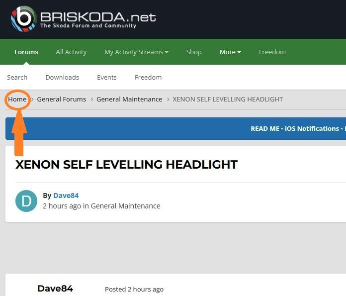

  13. Hi, welcome Dave. You might find more traffic and answers by looking at and if required asking on the 'Škoda Yeti' section of the site and its forums. Good luck. 'Škoda Yeti' - https://www.briskoda.net/forums/forum/170-škoda-yeti/
