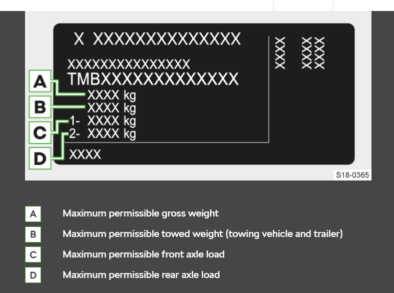

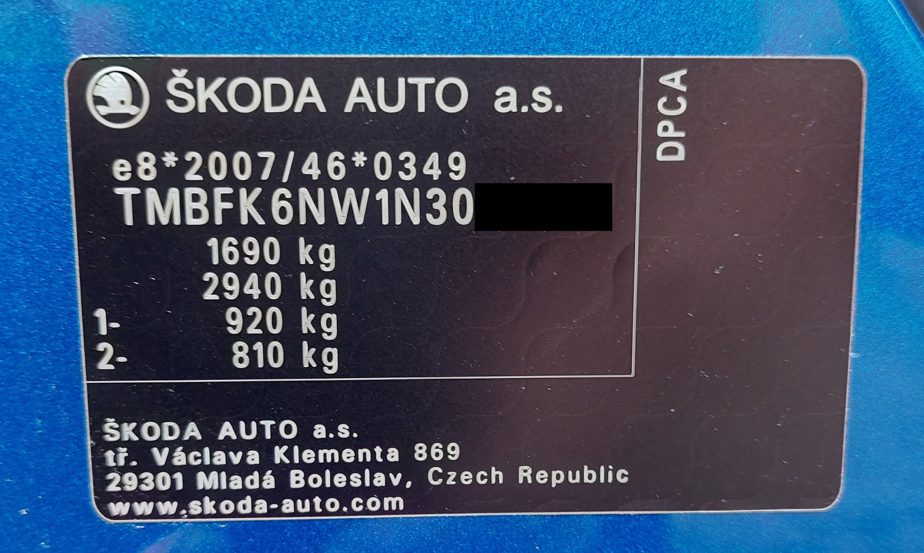

  22. The whole subject of being plated for towing - or not - is very confusing. I wonder how many forum members have Scalas (or other Skodas) that are not plated for towing. Because cars not specified for towing at the point of order leaving the factory plated for towing contradict the brochure.
