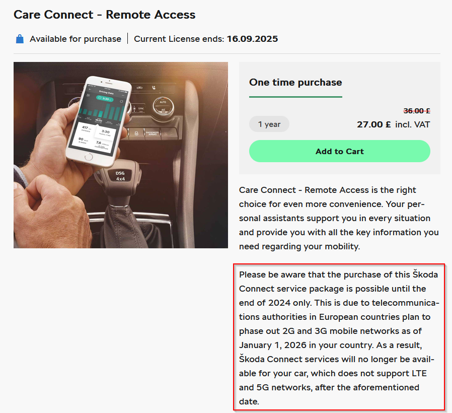

  8. I could try that... but historically my experience of them has not been great. They were no help when I received the e-mail last year saying my car had a 2G antenna and would no longer receive Skoda Connect services! I tried telling them that the car had 4G LTE - but they had no clue what I was talking about, and really didn't seem to care. 🤷‍♂️
