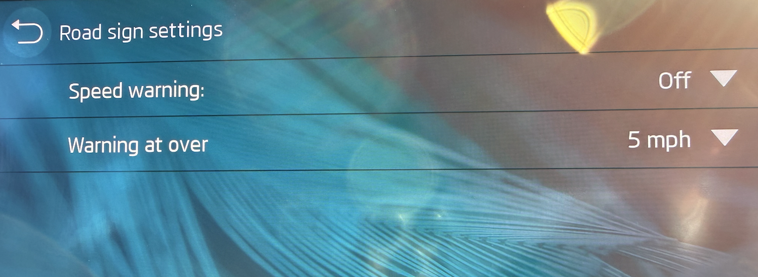

Road Sign Display on Columbus Navigation
I had a look there too - and it's not there 😃 So I've managed to answer my own question. It seems that the speed limit display is permanently on. Unless you are parked on your driveway off road. This is where the car was parked when I was logging back in, checking settings, etc. I didn't think the GPS would be sensitive enough to know that being a few metres away from the road would be enough to turn off the speed limit display. But it seems that it is. As soon as I took the car out tonight and got on the road, the speed limit appeared. Parked on driveway: Parked on a road:
Hi All, My car has come back from the dealer today after having both the OCU (0311) and Infotainment (1989) updated. On previous versions of infotainment I had the road sign display enabled in the navigation as I don't have the traffic sign recognition feature on the car. I found it quite a useful feature. As the OCU had been updated I had to log back into the car and set myself as primary user, etc. The road sign display was never on by default. However, on 1989 I cannot find any option in the navigation settings to turn it on. I've even resorted to looking in the owners manual. Where it states it should be here: Route Guidance Settings -> Road signs -> Show on map However, the option is no longer there for me. Here's what I get on my display: Can anyone with 1989 confirm if they are seeing the same thing? Many Thanks...
