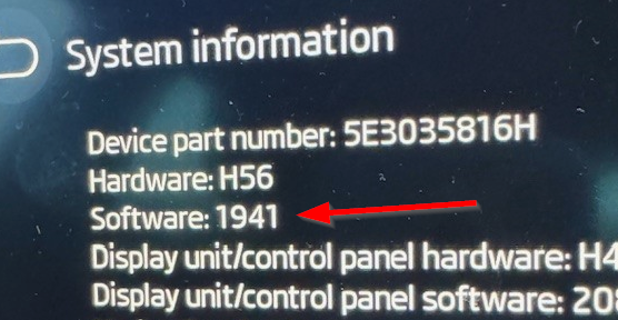

  3. Hello... The version numbers are the same, so you would want the infotainment to be on 1941 or 1969 at a minimum. Minor software updates have been applied to my car via OTA. However, I was under the impression that after 1941 was installed by the dealer it would allow larger updates to be downloaded and installed. As yet, my infotainment system has not downloaded 1969, and to be honest I don't expect it to. Given that you are buying a 2021 'early' vehicle, there are other software updates you may find need to be applied. I had the "Pop, Pop SOS" issue, climate control SYNC setting not being remembered, issues with the matrix lights not being correctly calibrated. It took a lot of visits to the Skoda dealer to finally get resolution. You will probably find any required updates will need to applied by a franchised Skoda dealer, so you may need to factor this into the purchasing decision. Certainly do not be fobbed off about the software issues on early cars. It'll be worth your time to browse the forum to get a good understanding of the issues you could face if you purchase a car with older software installed.

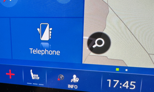

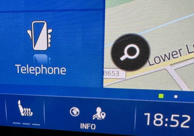

  5. In my car I don't do anything to specifically "turn off" the WiFi, as it is needed for any wireless CarPlay or Android Auto. I just make sure the e-Sim is turned on. When I first owned the car I did try disabling the e-Sim, and connecting the WiFi to my home broadband in the home that it may help in downloading updates as I live in a poor mobile signal area. However, I seem to recall it didn't do anything. Is the issue you're experiencing that your phone will not connect to Android Auto at all? When I first had my Octavia I had many issues with the Bluetooth and wireless CarPlay. On some days it would not connect to Bluetooth automatically, or connect to Wireless CarPlay automatically. It usually required me to go into the car Settings and manually select the device. Then it would connect. It was very frustrating. Every time I used the car you never know if the phone would connect at all... or just to Bluetooth, or maybe even CarPlay. An infotainment software update did fix it, but I was originally on a much earlier version (1668). So... I do think you need to get your infotainment updated by the dealer to at least 1941 or 1969. I think that would fix the connectivity issues. However, I don't recall having issues with map updates being affected by it. Hopefully a dealer visit, followed by a software update will put everything right.

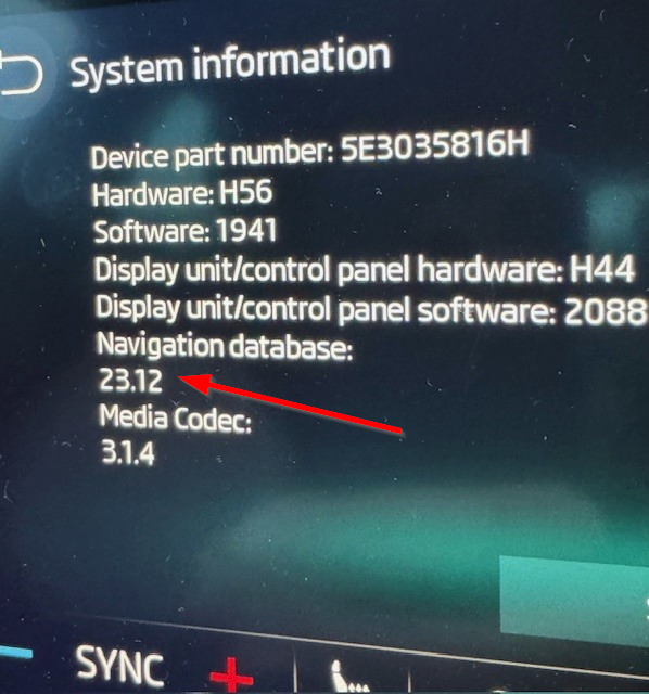

  7. I would recommend toggling the e-sim back on and see what happens. I suspect you may well find it updates the maps. As pointed out above by @WaveyDavey you should definitely ask the dealer to upgrade your infotainment system to version 1941 or 1969.
  8. Hi @AlanOsborne If you're paying for the Infotainment online subscription then the system should be automatically downloading the map updates for you. There shouldn't be any need to manually download the map updates. I'm currently subscribed to infotainment online. I've just checked my map version and it's showing as 24.5, so it last updated in May 2024. The previous update was 24.2 (February). Maybe call your local dealer if it's not downloading for you, as it's part of the service you are paying for. If you're not subscribed to infotainment online, then you will need to download manually. I've heard the download portal does lag a little behind what is downloaded direct to cars, but 23.6 is nearly a year behind, which seems a lot.
  9. I’m not convinced the early Mk IV Octavia infotainment has the ability to apply such a large update to itself. It may not have enough local storage to download the 10gb compressed files and then extract them internally and apply them. Correct me if I’m wrong, but I’ve not seen anyone on here with an early car reporting that their infotainment has upgraded OTA from 1941 to 1969. I’ve deliberately left my system at 1941 to see if it will update OTA, and so far there has been nothing apart from a couple of minor app updates. If the early units DO have the ability to perform that size of update OTA, it may be Skoda that are not releasing it. Given the number of software issues with the early cars over the past 3 years, Skoda may be concerned about creating more. Given many early cars are now coming out of warranty, perhaps there is a concern of “what happens” if an infotainment unit bricks itself performing a large OTA update. I think it would give rise to an interesting discussion at a dealer as to who pays to rectify it.
