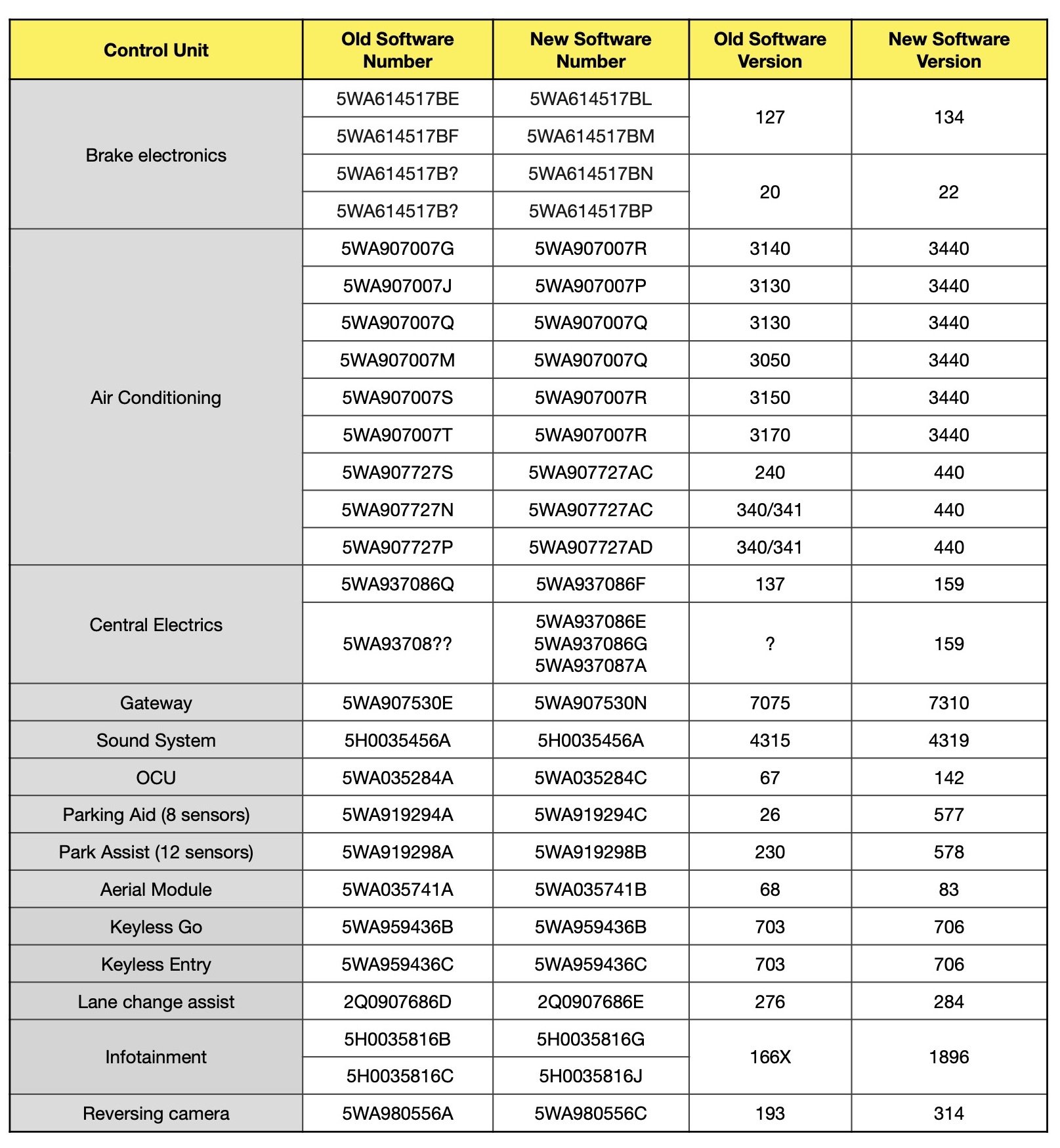

I did post this over here for someone else, and if you check the very large list of modules, you should see that "OCU" get's updated with the SW1896 upgrade AFAIK.
Just remember this information is from Golf Mk8 platform, but appreciate that they share parts.
https://www.briskoda.net/forums/topic/505794-epb-auto-hold-not-releasing-issue-again/?do=findComment&comment=5679205
The post might indeed be O/T or possible red herring, it would be nice to actually have someone post the TPI for the Skoda infotainment update.

@PoloPaul I am in the process of getting my hands on the TPI from a friend with access to try and dig into the situation a little deeper.  As you can see from my linked in thread to the image from a Golf Mk8 they seem to update a fair few control units, I am wondering if the list if same or different for Skoda.
I am forming a possible picture that there is a different list of updates for Skoda compared to VW (though they share a lot of the same hardware) or that some dealers are simply scanning the TPI and cherry picking their way to the fastest way to load SW1896.
As for future SW updates, once you are on 18xx or the 1896, you should be able to get the online updates yourself, as you know if you are on 16xx you cannot simply go to 18xx as there will most likely be some hardware changes to accomodate the update physically.  So unless they find yet another major issue, you should be getting online updates from now on, if the car is set correctly (registered and security levels are correct)

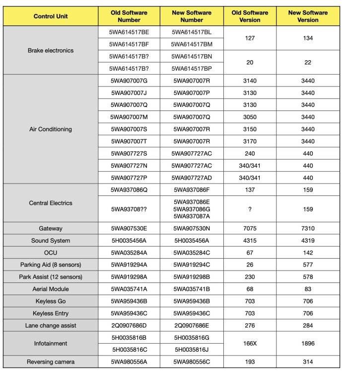

This list is for the Golf Mk8 platform, same software version that is applied to Skoda (with some tweaks of course)
If you look at the amount of modules that should be updated as part of the recall, it gives you some insight as to how tied in the MMI is.
Pay attention to "OCU" this is the part that is giving you issues.  My theory I am working on, is that some dealers doing the update are not applying all of the updates they should be, this causes headaches as the SW1896 is expecting to be talking to OCU and other modules for information it seeks.
I wish I had this document for Skoda (I am looking!)
