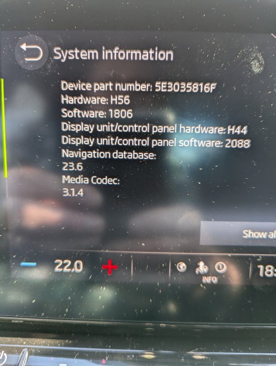

Hi, I live in Wales and drive a 2020 Mk IV 1.5 TSI Octavia.  I have been waiting for the navigation database (v 22.9) to be updated to include the 20mph speed limits.  Yesterday I downloaded ECE2024 (CW 45/2023, Nov. 2023?) and manually updated the navigation system.  The system now shows navigation database version 23.6, i.e. before the Welsh speed limit changed!  Therefore the system still does not include the new 20mph roads in Wales.  My subscriptions are all up to date btw and I was wondering if there was a more recent version available anywhere?  I recently drove a friend's 24 plate Kodiac whose maps DO show the new speed limits.  Cheers Alan

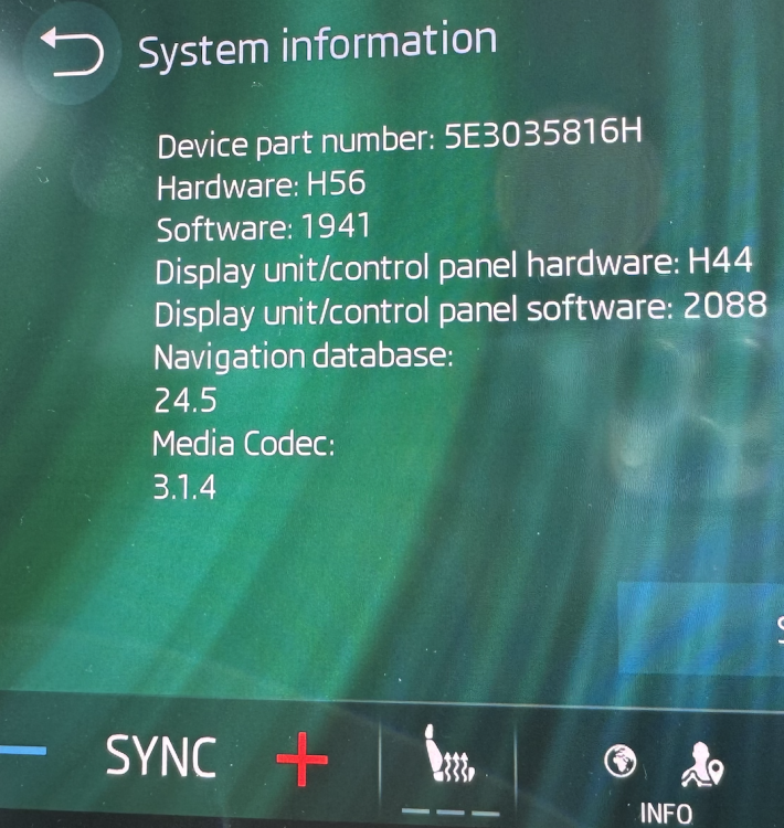

Hi @AlanOsborne If you're paying for the Infotainment online subscription then the system should be automatically downloading the map updates for you. There shouldn't be any need to manually download the map updates. I'm currently subscribed to infotainment online. I've just checked my map version and it's showing as 24.5, so it last updated in May 2024. The previous update was 24.2 (February). Maybe call your local dealer if it's not downloading for you, as it's part of the service you are paying for.
If you're not subscribed to infotainment online, then you will need to download manually. I've heard the download portal does lag a little behind what is downloaded direct to cars, but 23.6 is nearly a year behind, which seems a lot.

I'm subscribed to Infotainment Online and can confirm mine is currently 24.5 (May 2024). I subscribed when I got the car in April and this is the second update I've had. (It initially updated to 24.2 when I first subscribed and then to the current 24.5 within the last few weeks).

Hi All, thanks for the information.  I currently subscribe to 'Infotainment Online' and 'Care Connect', but not the 'Data Plan'.   My car connects successfully to my home WiFi.  The Head Unit Software version is also lagging behind it seems at 1806!  the car is due for an oil change towards the end of the Month, I will have words with the Dealer!

Yes your Infotainment software is very very out of date. It should be at least 1941 but i'm not sure if that would stop the maps from updating. You don't need a data plan to get the map updates they just download via the car's eSim once you subscribe to the Infotainment Online service. (I don't have a data plan either). The data plan is so that you can use the car as a hotspot and people without mobile data can connect to the internet via the car's hotspot and then use the car's p[aid for data to browse etc.....
I believe the car's eSim uses the Vodafone network (That's who Cubic backbone off in the UK) so could it be that you live in a Vodafone blackspot so therefore the car isn't downloading the updates? Or it could maybe be a fault with the eSim in the car? Are the rest of your built in apps updating OK like store, pay to park, pay to fuel etc.....?
