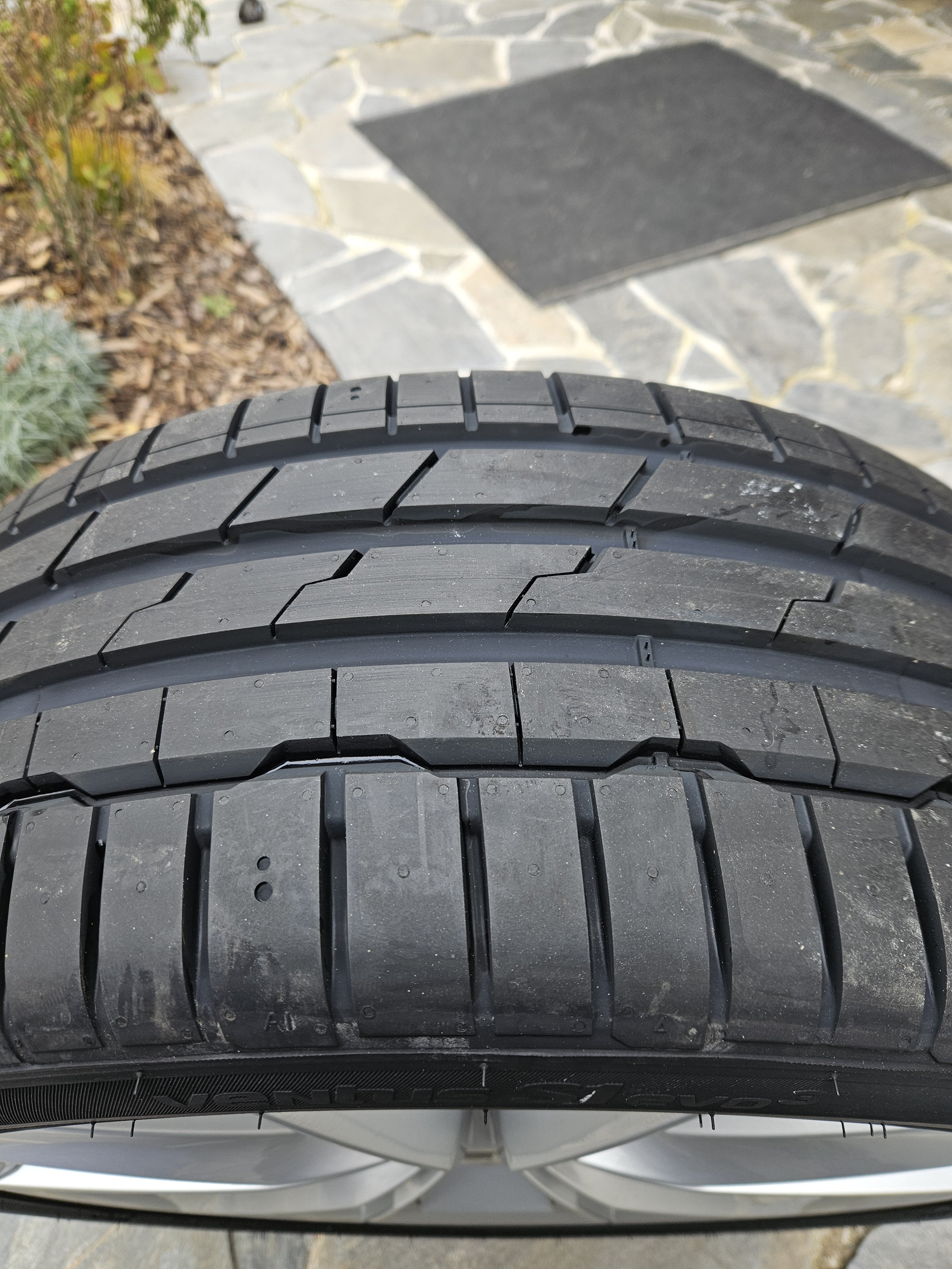

The grip on the pirelli p7 and the rim protection are awesome (18inch).They are a bit noisy but small price to pay. I went on a road trip through Bulgaria and Greece,3700 km of bad roads,very bad highway...I has angry as hell,total nightmare.You can barely tell if is Bulgaria or Ucraina on the roads. Came back home straight to the best tyre shop in my country to check the wheels....I was shocked when the guy told me that the rims are perfectly straight.
