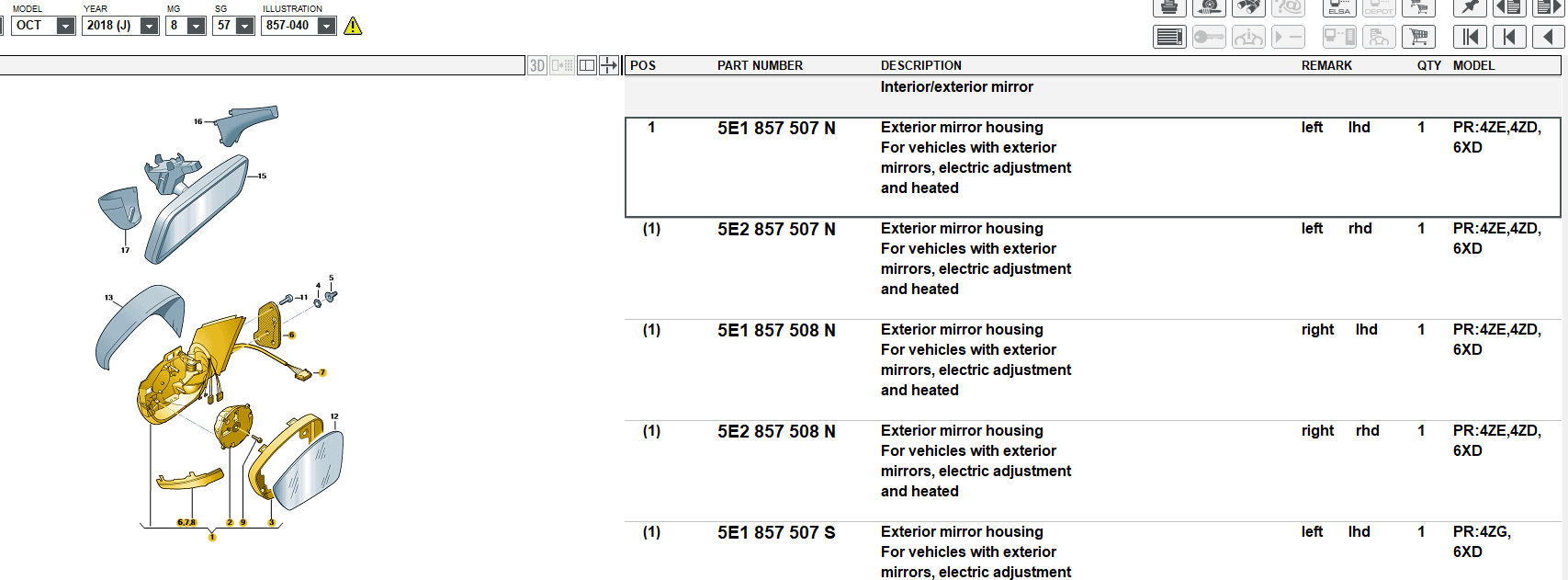

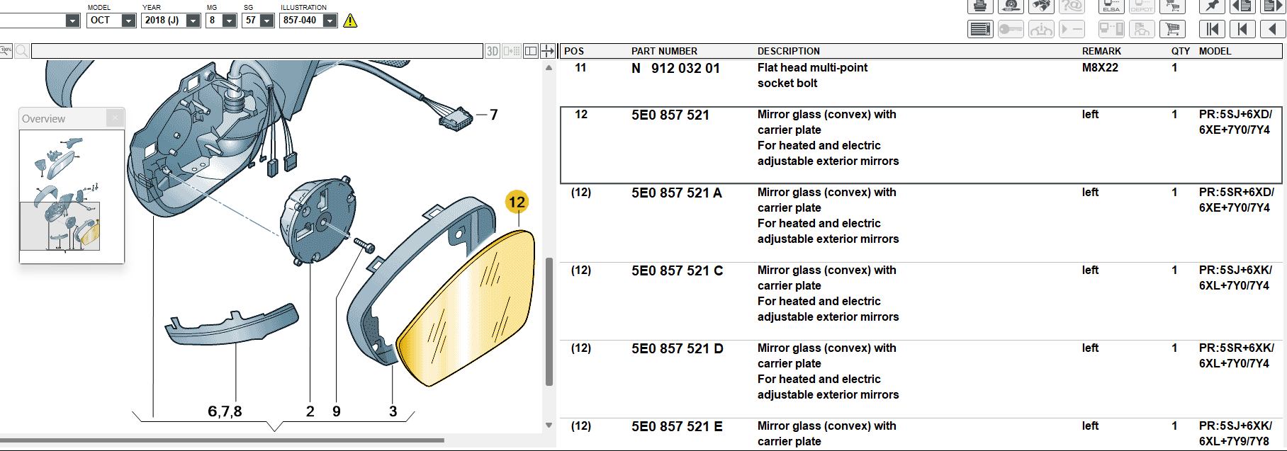

Advice on nearside passenger wing mirror
I would assume they made a balls up, the part number you have posted 5E0 857 521 is just the glass only and the glass is Left (RHD/LHD doesn't matter) But the whole mirror frame it does matter, there are Left LHD and Left RHD BTW there are about 70, yes 70! Different choices depending on the specification of the car, and any parts that have been superseded will be in this massive list.
When you said you ordered a new mirror... did you mean the whole thing, or just mirror glass?
That Polcar link says "RHT/LHD" RHT = Right Hand Traffic? LHD = Left Hand Drive I would say
